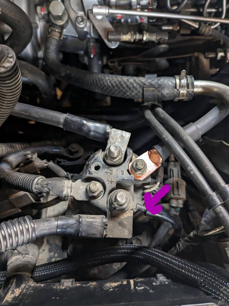

Does anyone have a photo of the correct wiring for an hdj81 voltage converter relay (12v vehicle with a 24v starter)?
I am wondering what this black wire is and if it is on the correct terminal.
I don't see it in the EWD. It runs from the 1- terminal into an OEM harness under the engine fuse box.
Yeah except it actually should actually go through the transmission position switch first rather than directly to an auxiliary relay as I have it wired up.
