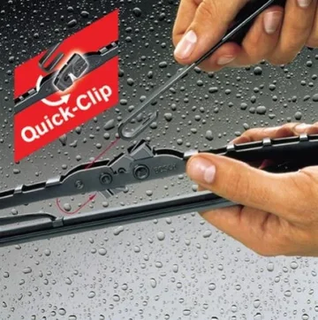

I always use Bosch wiper blades. Each set comes with a box of 5 sets adapters called "quick clips".
Pick the right adapter, push it on the wiper blade and slide it over the flat end of your wiper arm. Ready in minutes.
It takes more time to get the old ones off.

Alex, here are some pics from Bosch wiper blades.
In the yellow top of the box is a little box with (2x) 5 adapters, see last pic.
This is how it works. Select the adapter for your wiper arm.
Click it on the blade and hook it up to your wiper arm.
5 adapters, one is on the blade.
Rudi

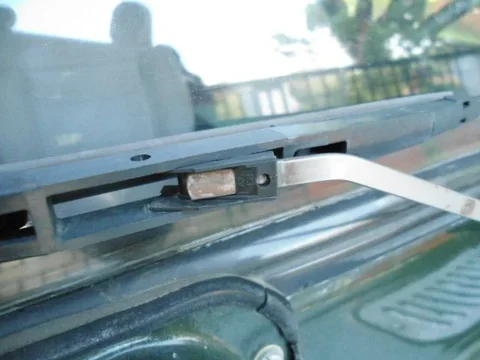

Hey all… vs creating a new wiper blade thread, I need some help on replacing mine. ‘77. I ordered OEM wipers and got the old wiper off but can’t figure out how to remove the black plastic piece to fit the new wiper. New wipers in metal with a different clip. The old blade slide into the hole and locked in. I assume if I get the black piece off the new blade just slides on. Any thoughts?
Just drill out the old (aluminum) rivet heads.
Can you just change out the rubber blade in the old one? I'm not sure it will fit the new blade holder once you remove the plastic piece - I guess you could rivet it back on if needed.
