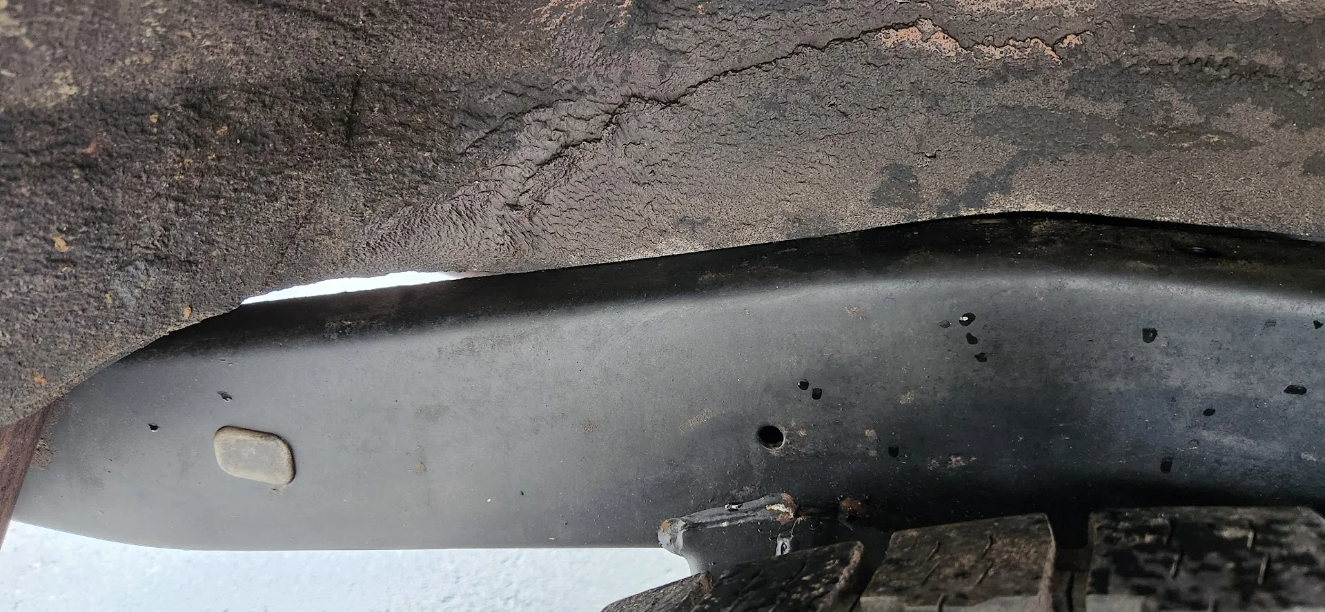

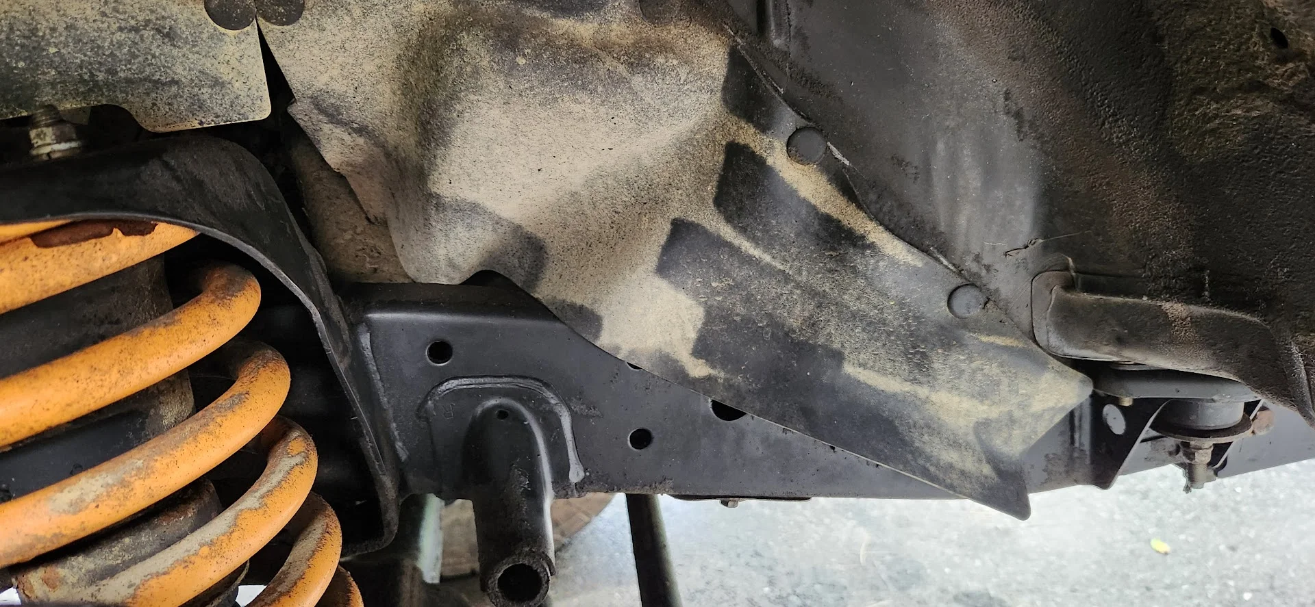

I bought this truck in February of 2014 and have sprayed it with Fluid Film every October. I did a half-arse job of power washing my frame and other dangly bits this afternoon to mostly clean off the years of buildup and finally get down to the base. This was the first time i did this after 10 years as a daily driver in New Jersey. While I missed some parts with the power washer, the parts that got clean are rust free. The stuff works.
