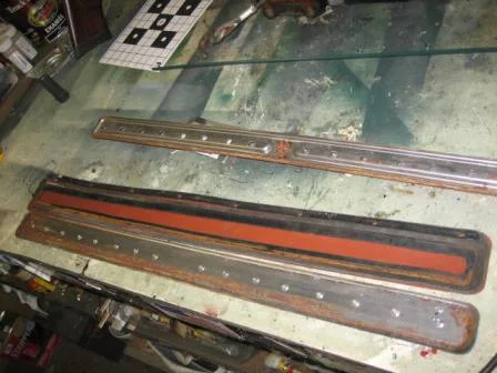

Here's the offending vent with it's spotwelds and without:

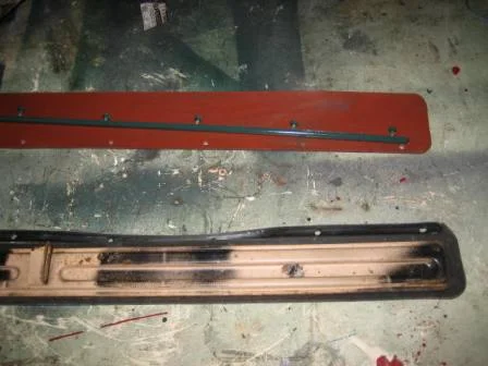

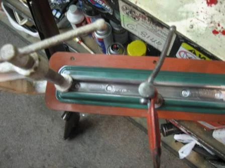

Here's the old gasket laid out on my blank red gasket, to mark the center to be cut out. You can use SOR's repro, just need to cut out the middle. I cleaned the inside up and painted the two mating faces with weld-through primer, they were bare before.

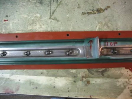

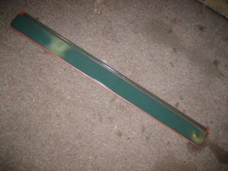

Before you weld triple check the orientation of the opening bracket shown. If you put this in upside down you won't find out until you're reinstalling it. :) Weld up, mask off the gasket and repaint. I pity the next guy in 40 years that needs to replace this thing. ;p

Yes. Drilled the spotwelds with a spot weld cutter and tack welded it back together. I had done one previously and by the time I got it all out I had put some serious dimpes in the front face from working it so hard. Mine was rusty and hard as a rock.
