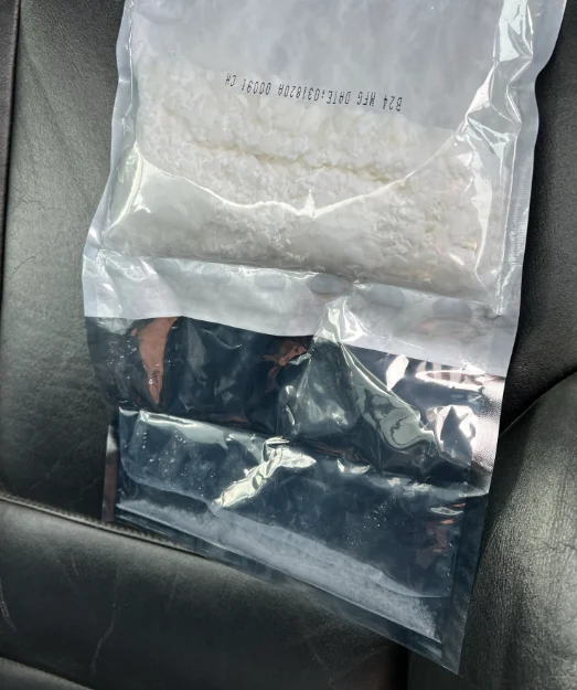

Long story... Generally every fall and through winter I have to keep a hanging damp-rid pack in my cruiser as soon as the rain starts to keep moisture down. It was bad enough that on warm days followed by cold mornings I would have to wipe down all the interior windows to get the moisture off of them. The DampRid packs generally start showing the collection of water within a day or two and only last about 6 to 8 weeks at most. This fall, I've had a damprid in the cruiser for a month and it has collected very little water. Most of the water it has collected is probably from a single rainy day when we were getting in & out and left some wet clothes in the car. At the current rate of water collection, I'd bet the single DampRid will last the entire winter. Couldn't be happier with the results of the windshield sealing

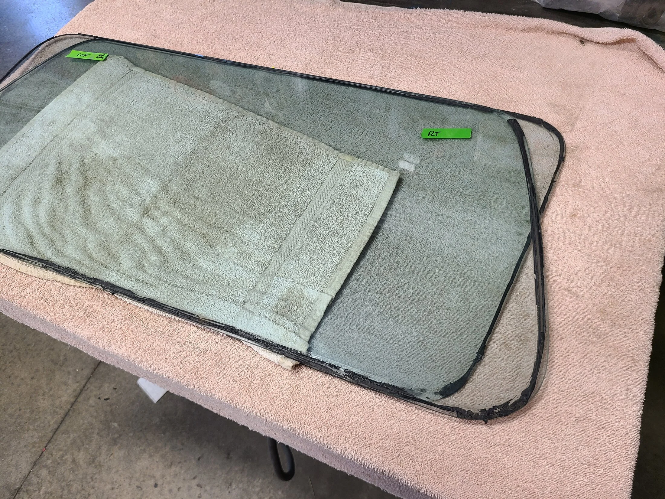

Finally got around to digging out my glass.
The rear quarter windows definitely had sealant on them and I have no reason to believe they weren't oem. Back hatch glass too. So that's what I'll do. Sealant on all of them between rubber seal and the glass. But nothing between the body and the seal.
There was residue around the openings I had to clean, but I believe now it was overspray from the headliner glue. It wasn't black
I'm gonna order the dekaseal 👍
Interesting, I’ve pulled cargo windows on 2 separate 60’s and neither had any sealant. I wonder if Toyota did seal them for some years and not for others.
Sounds like a good plan!
1989 BJ60 had what I believe is black butyl sealant behind the seals on the windscreen, rear quarter windows and rear door windows.
