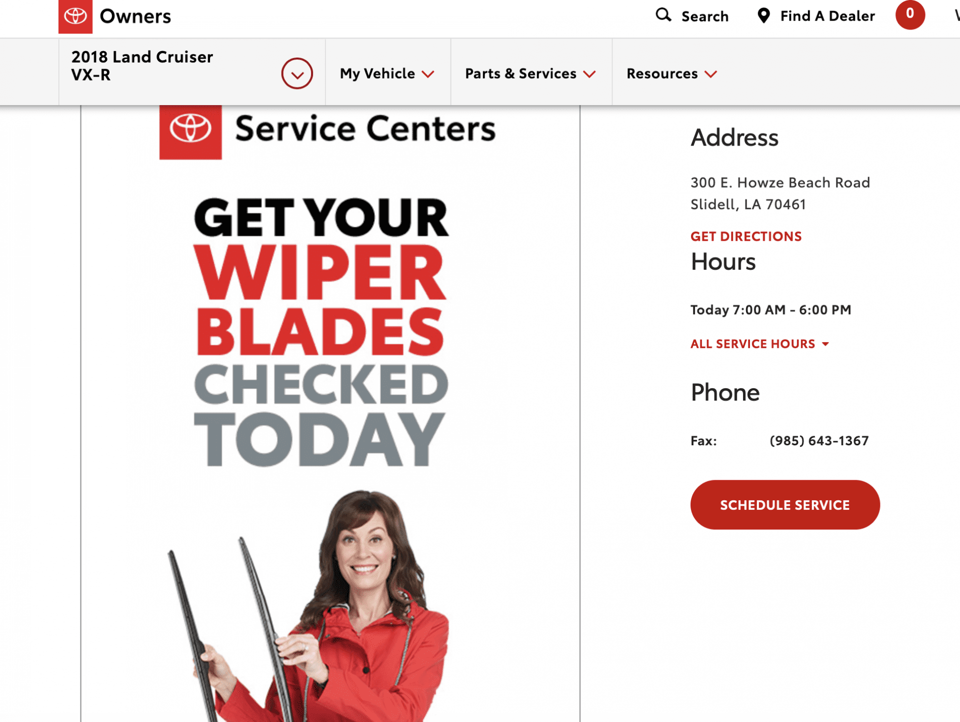

Ok, weird... There is no instructional or manufacturers details I could find on "How To" replace the wipers. I don't want to bust the clip so not sure how to do it , how much force to use.... Pointers, direction, please - ?? Thanks. Oddly enough I went to the Toyota website , nothing. But, this great offer - WTH... HaHa. An offer to get the blades inspected at the dealer!
Thank you.
