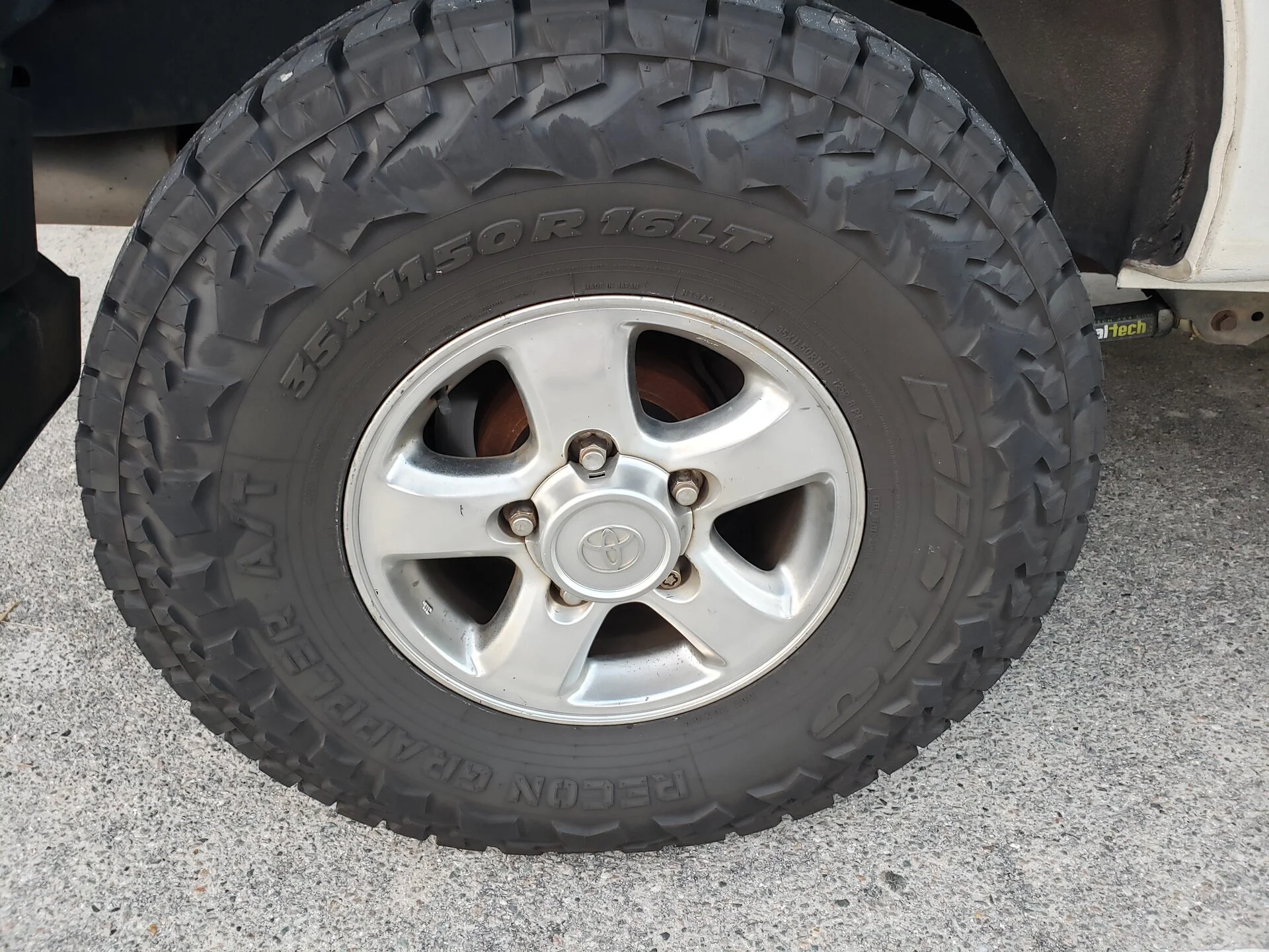

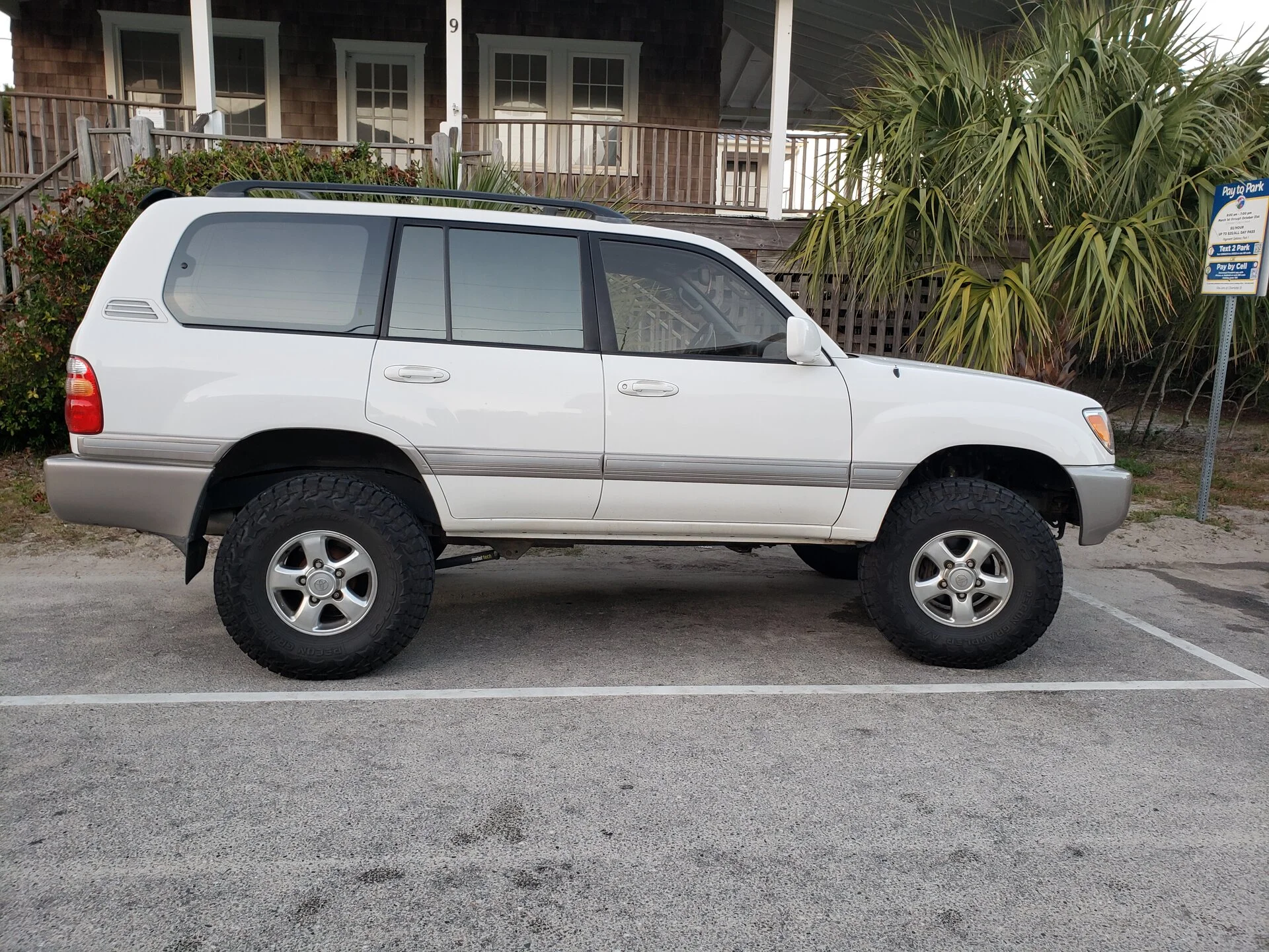

I was in Wilmington, NC for the beerfest this week and ran into this 100.
I spied the MT lowers but noted it has to be at least two to three inches higher than mine. I did not get all over it but started wondering if it was a body lift or something else.
Are you on here?
Or anyone else have a thought?
Running the new Nittos.
Hard to tell from the pic, but there may be 1" or so of body lift going on. See the distance between the body and the frame? i dunno, hard to tell. I woudl advise against anything over 1-2 inch of lift on the 100, unless you want to spend big bucks to start correcting the suspention geometry as this person did with the extended Radius Arms, adjustable upper control arms, etc.
