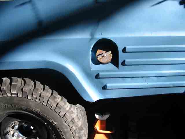

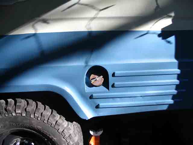

then I got the reast oof the gas tank hardware installed. and the gas cap:) so not all that is left with eth fuel system is the wriing and the fuel sender very excited about that.I then started working on chaging out all the coolant hoses ont he engine. did not really take pics of that not terrible interesting....

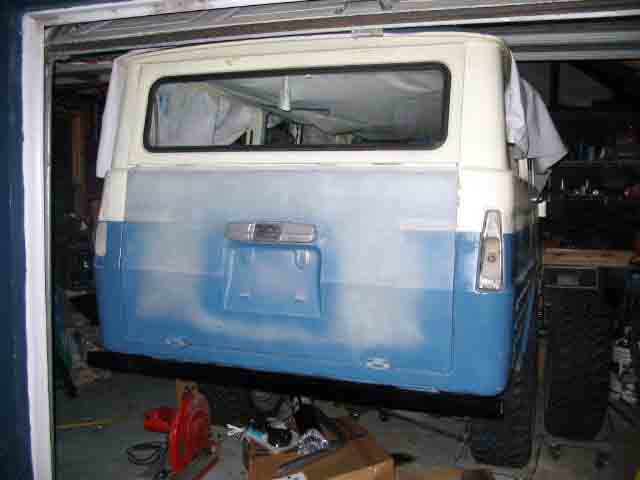

I figured I would update some pics of things that I had not gotten up yet like the rear hatch. it is installed and working i need to get atleast one of those knobs for the lift gate stays in that I don't have mine i can see where they were and how they were used but mine are missing. i still need to figure out what molding to use for the surround but the hardware is all on.
