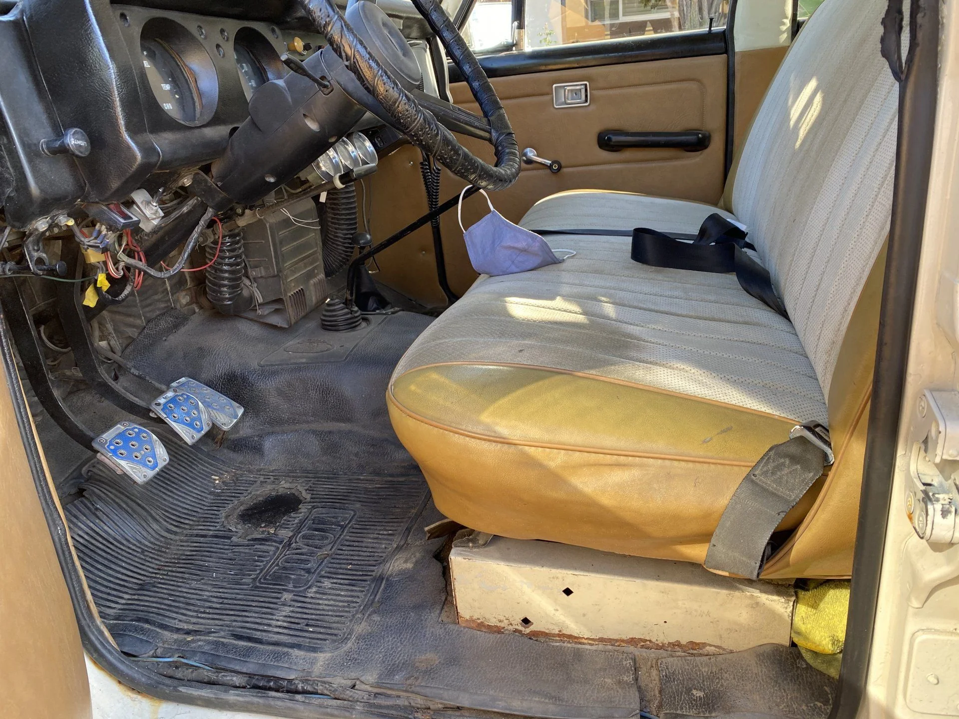

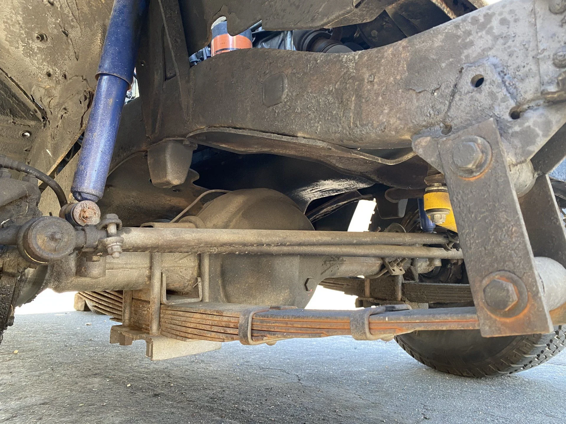

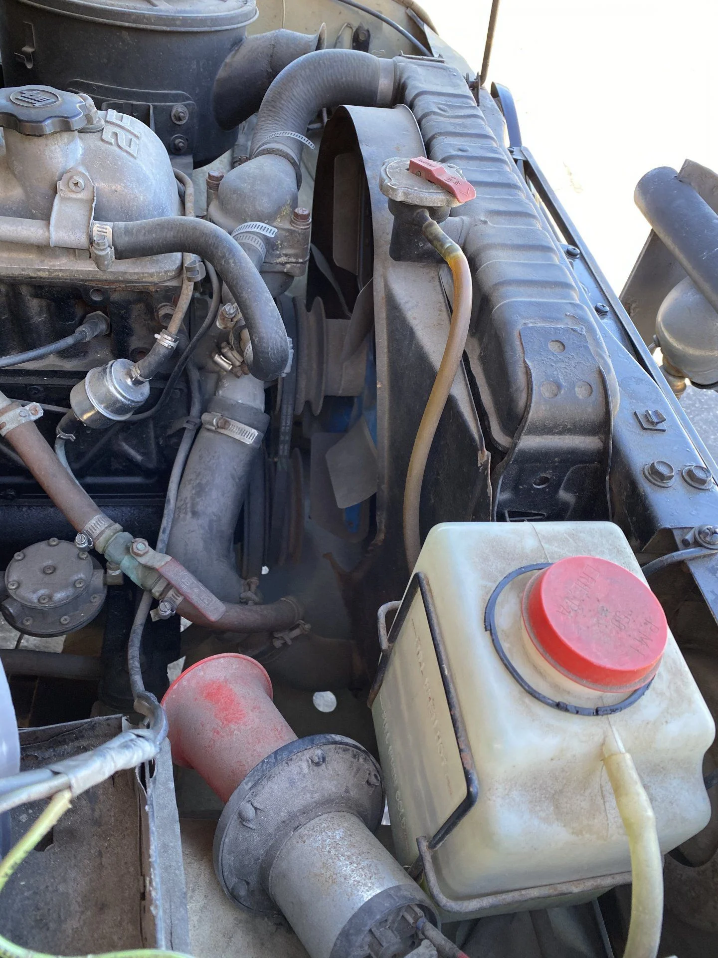

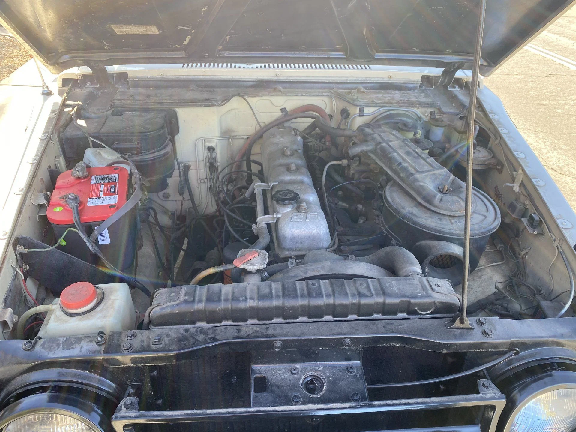

I'm not a hardcore mechanic. I bought something that was running and in good enough condition to drive as my daily (this is how I justified it to my wife :), I sold my 100 series to my son to have the best of both worlds). I've done lightweight work on he 100 series like radiator, alternator, fan clutch, coils, etc... I don't mind getting my hands dirty and figuring things out, but I won't personally be doing an LS swap or putting it on an 80 series frame :).
Here's my early list. I've only owned it a week, so still figuring things out. I'd love your thoughts on any of this, as y'all are much farther down the road than I am with your knowledge of these Pigs.
Current project list
  • Replace battery (done)
  • Replace alternator (ordered from Cruiser Corps, any thoughts on ordering parts from them?)
  • Replace regulator (Cruiser Corps)
  • Repair/replace emergency brake (Ordered from Cruiser Corps)
  • Radio, something very stock looking (this is my daily driver, I don't drive much right now, but when I do, I need some music, ideas?)
  • Deep clean interior
  • Flush/Replace all Fluids
  • Day trip test (Otay Truck Trail)
2021 Q1 List
  • Hunt down/repair electrical issues (voltmeter not working, no power to CB, KC lights not working, lots of aftermarket switches that appear to do nothing)
  • Repair back window (gets stuck half way down)
  • Go through everything mechanically and make this a longer list. lol
  • Overnight test trip (Ocotillo Wells?)
2021 Q2 List
  • Make sure 4WD Lo and hubs are working well
  • Possible upgrade of suspension
  • New Tires (33s?)
  • Figure out how to add external gas storage (rear mount/swing out?)
  • 3-4 day test trip (Mojave Road?)
June 20th - Leave for Washington
(Photos are coming)

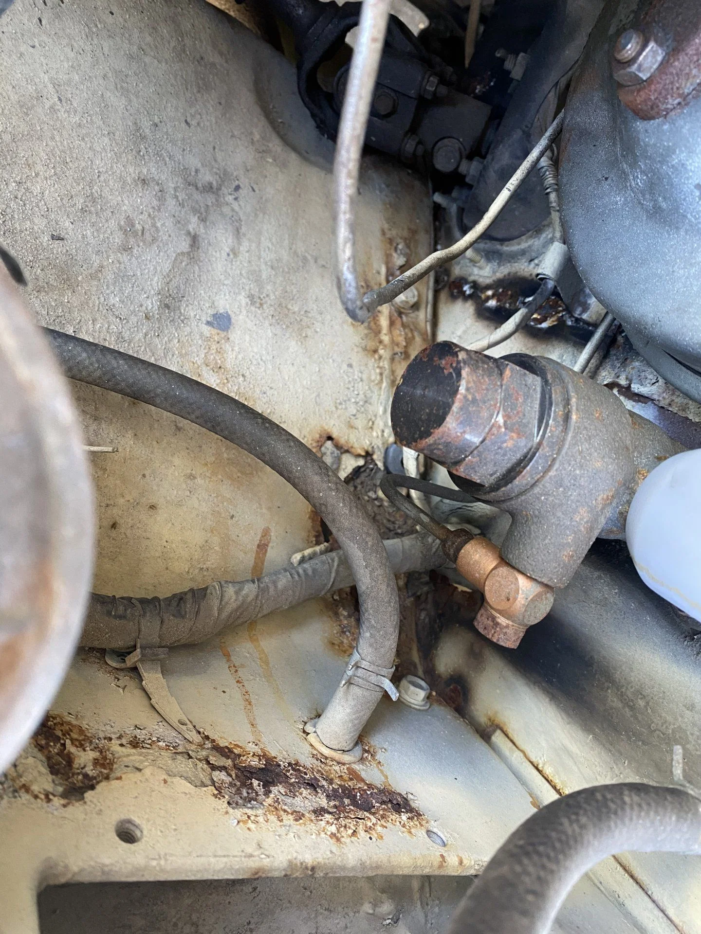

Got a good looking crew there! Looks like you'll be needing either a brake rebuild or knuckle redo, probably both. Seems to be in great shape, so should stay within budget and don't worry about budgeting, we can handle that for you. :)
Most guys start with a lot less and turn them into keepers, so you're very fortunate to have one in such good condition.
