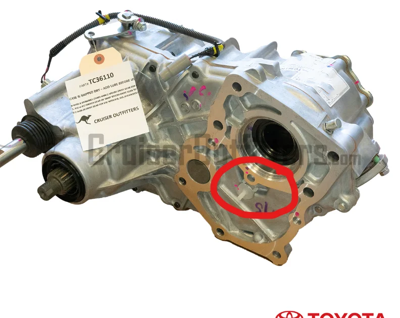

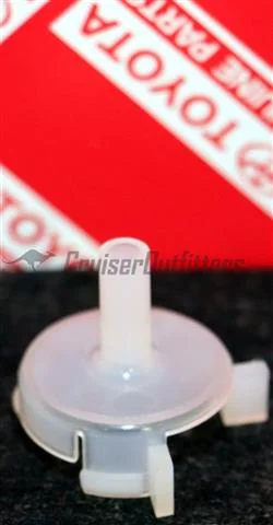

What are you putting the diesel H55F into? Do you want to retain the vacuum-shift 4WD the FJ62 currently has. Outside of that, it's a very direct fit. Add the oiler, gaskets, seals and inspect all other items and some hardware.
This is the oiler (our part# TR36010 - 33124-36010). It slides in the forward facing front half of the split t-case and literally catches and directs oil at the transmission, simply put.
You can see it installed here:
