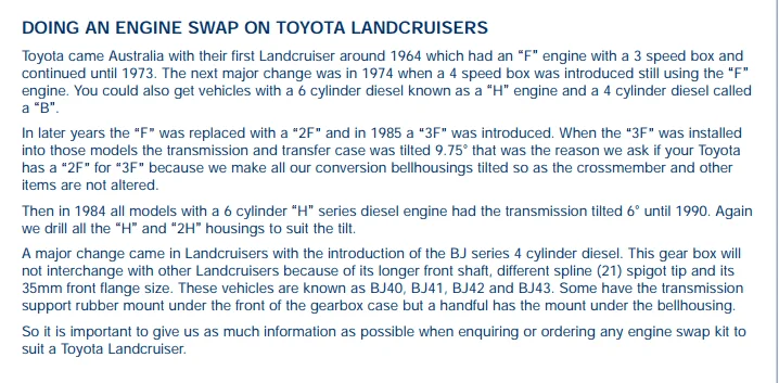

Their 2F and 2H H55F kits would work with an 70 series H55F with and input shaft swap. They don't list the H55f but refer to it as landcruiser 5 speed.
Um. No. There are no mentions of 1UZ/2UZ to H series transmissions. They reference G, W, T, P and R transmissions. No H transmissions. The first section discusses the "Types of Toyota Manual Overdrive Transmissions" but completely neglect the H transmissions until the LC engine conversion section.
No mentions of 1UZ/2UZ to H4x/5x transmissions.

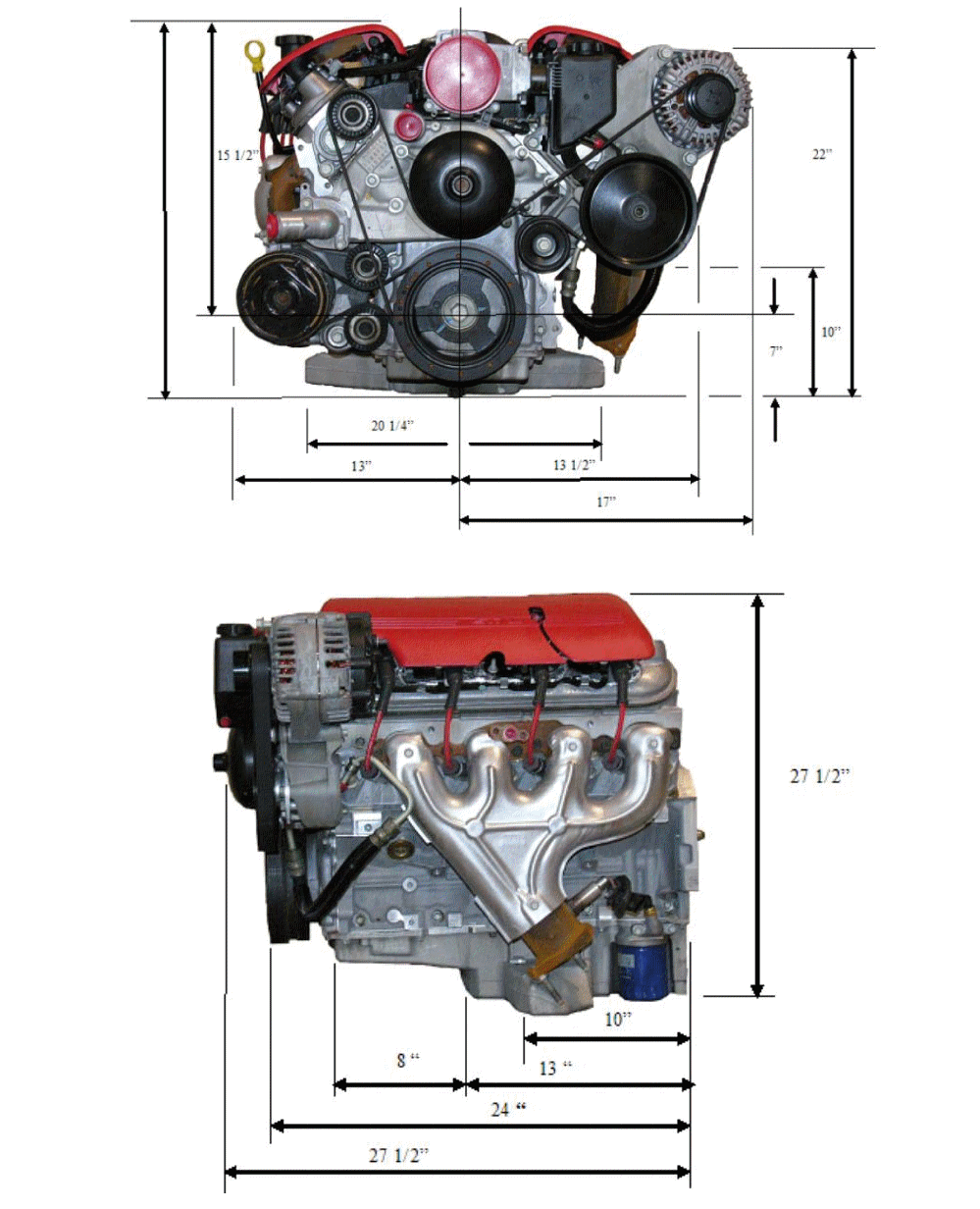

The Toyota V8s are wider than the Chev due to bore spread, and taller due to overhead cams. The bank angle of a LS is 45, a UZ is 90.
Despite the pics above a LS overall is smaller than UZ. LS aftermarket parts like block hugging headers and ancillary relocation brackets are readily available. On my 1UZ the cast log headers are the only thing that will fit inside the chassis rails.

Not sure on the 1UZ vs 2UZ differences. The above engine pics & dimensions are a bit misleading as the 1UZ is shown fairly naked but the LS has all the bollocks attached. I would agree with Axehead that the LS is the more compact motor. I don't think they're 45 deg V angle though, I thought they were 90 deg like just about every other GM V8? Been told they're lighter too. Not that a 2UZ wouldn't be a sweet motor.
