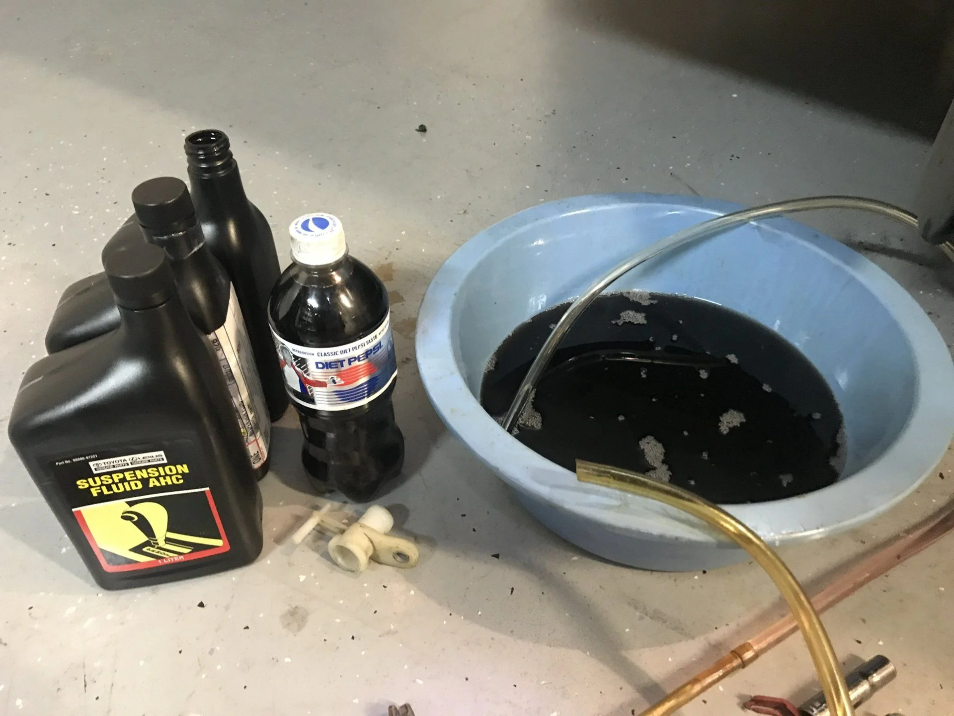

First Mod was to change the AHC fluid. This stuff was nasty. Flushed and replaced 3 quarts.

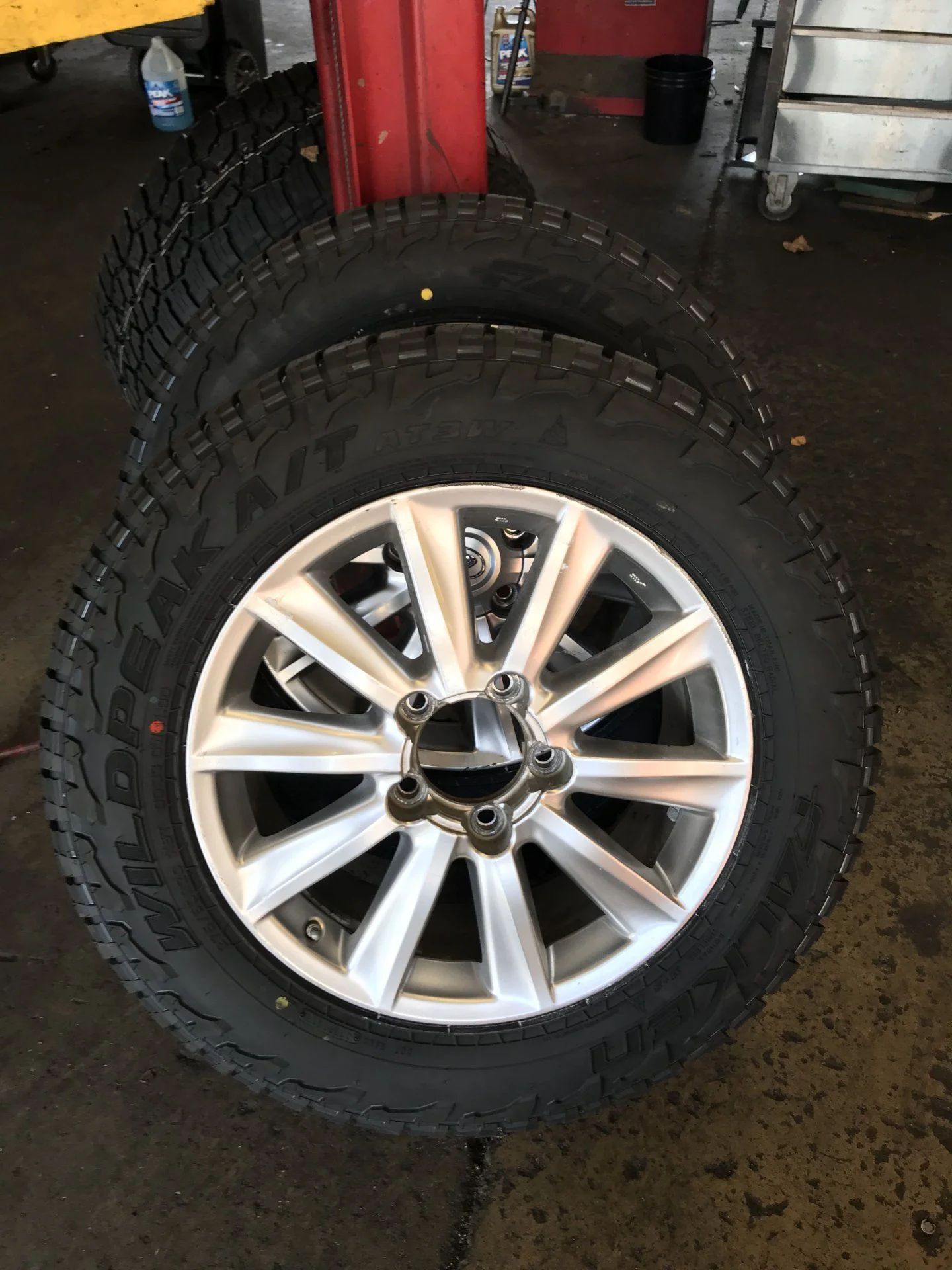

Next up was tires. I have loved the Falken Wildoeaks on my 100, so tire choice was easy. Went with 5 to make sure they all matched.
I will get some pics of then mounted with my new tint and detail job.

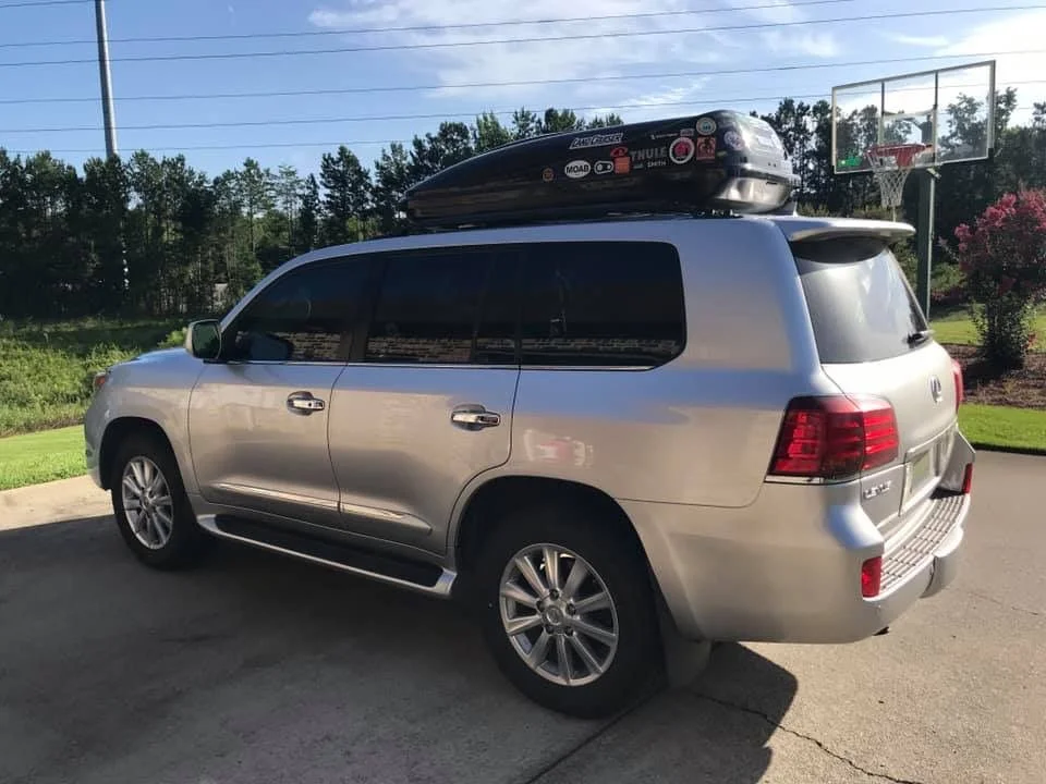

With camping and 4 kids, I imagine, since it doesn't have the luggage space of the Yukon with the 3rd row up, you will do the roof box?
Congrats. Looks great. Good riddance to the Yukon.
For sure. We have a Thule roof box that is awesome!
Excellent
I use a Thule 21cubuc feet box. Love it.
However that is the Only time I am jealous of my Escalade esv friends, when I have to load my box, while they throw everything in their hatch :(
Any issues with the rear biased short rack on the LX? On mobile so can’t see your M/Y but the rack on my 14 is not as large as the one on comparable LC’s.
Which box in particular? My wife and I have been wanting to get one for our trips and finding one that fits the relatively short rearward rack of the LX has been hard.
I have a giant Thule on my LX and had to put a Toyota roof rack on to make it clear the hatch. Otherwise your options are limited.

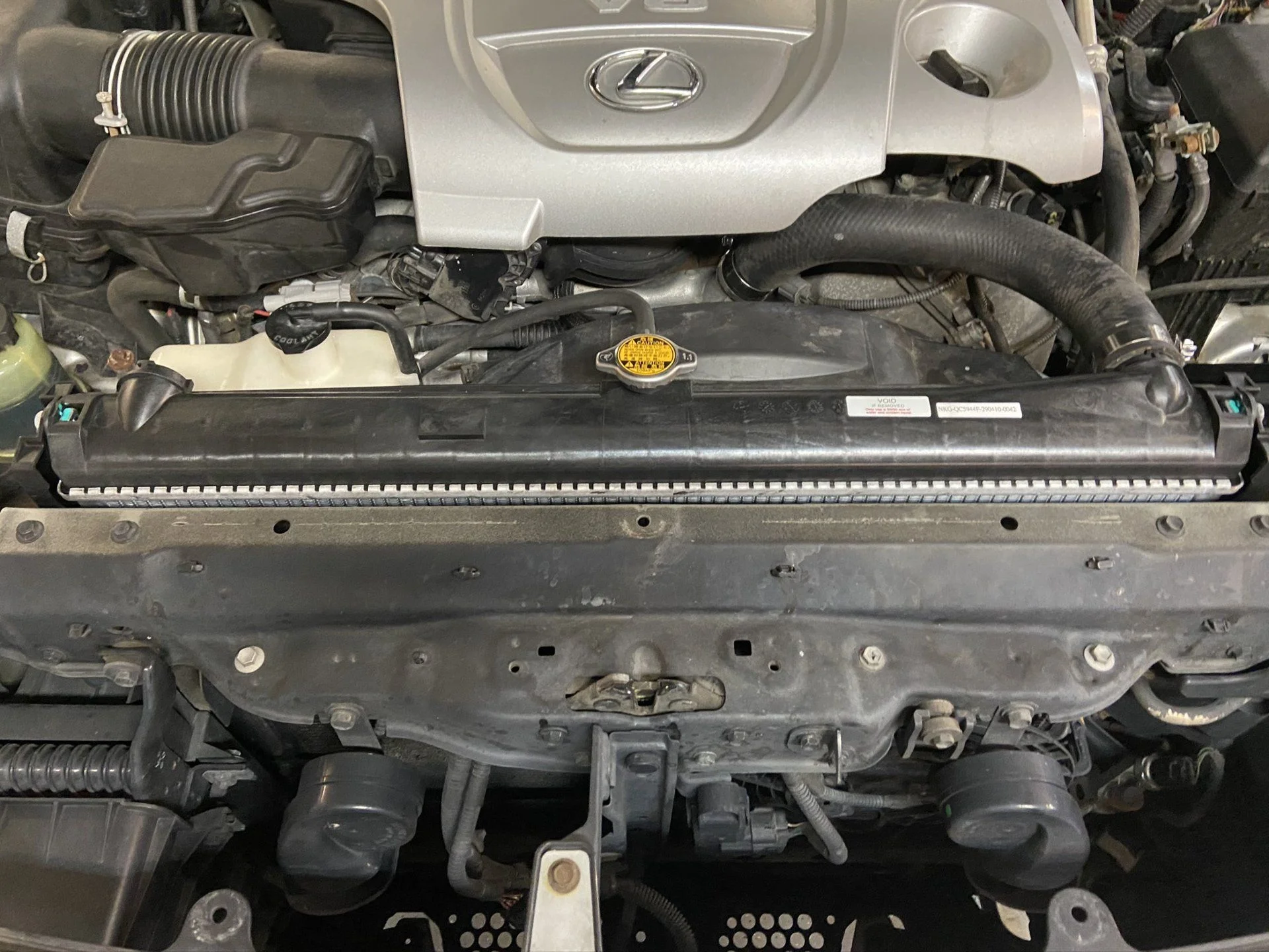

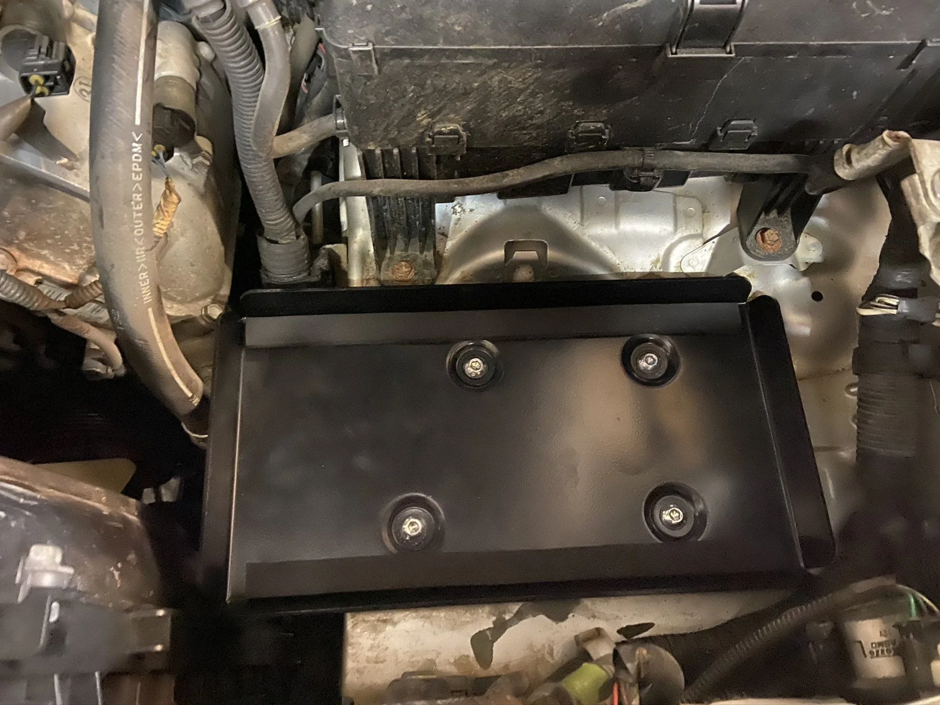

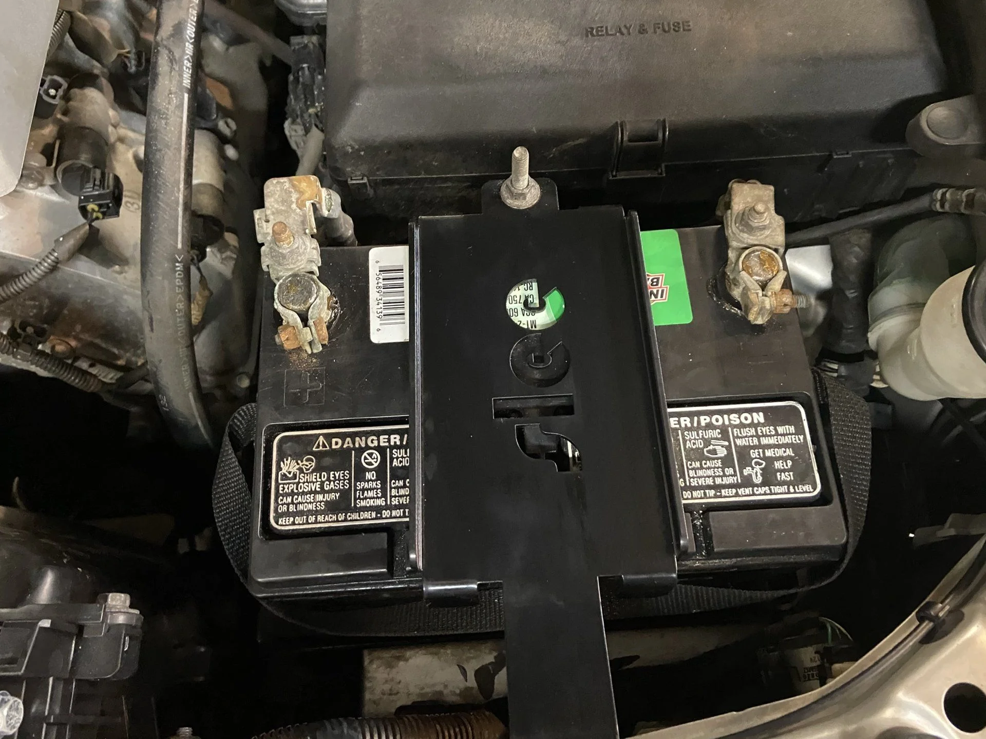

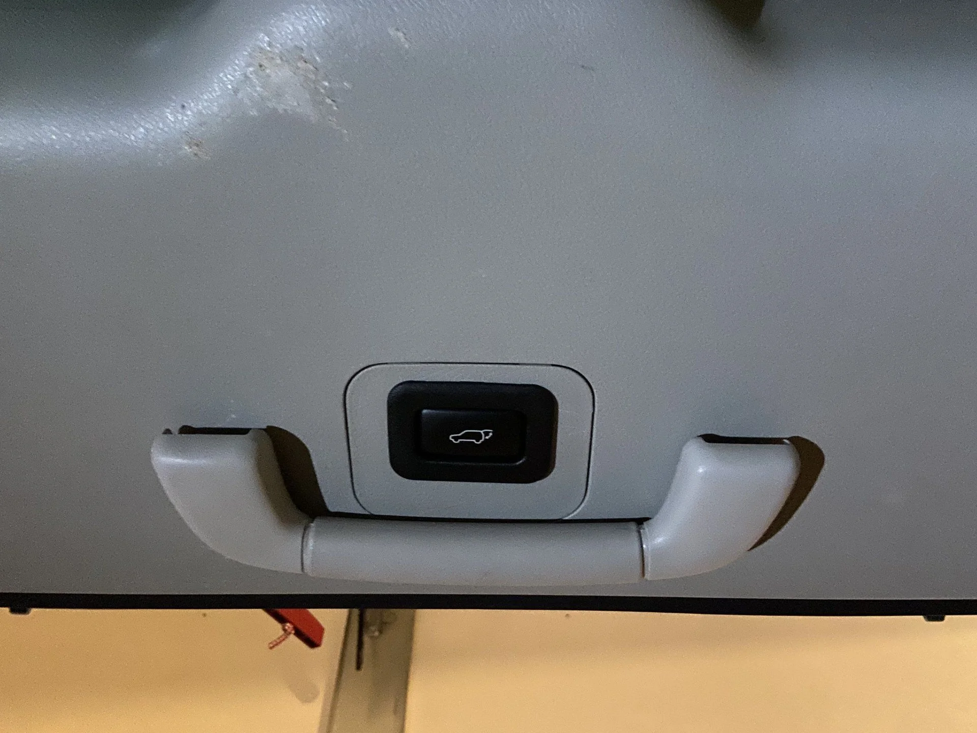

I had the dreaded radiator crack. As soon as I saw coolant around the raised spot I had it replaced and a new WP at the same time. I changed the spark plugs as it was at 125k on the originals. I also added the Slee battery tray to upgrade the main battery. I put the stock size battery back until it dies as it is still pretty new. Unfortunately I had to replace all the TREs but not due to wear, they were corroded and would not budge for an alignment. I got the 555 replacement TRE kit from Cruiser Outfitters. I added the rear hatch escape button also from Cruiser Outfitters.

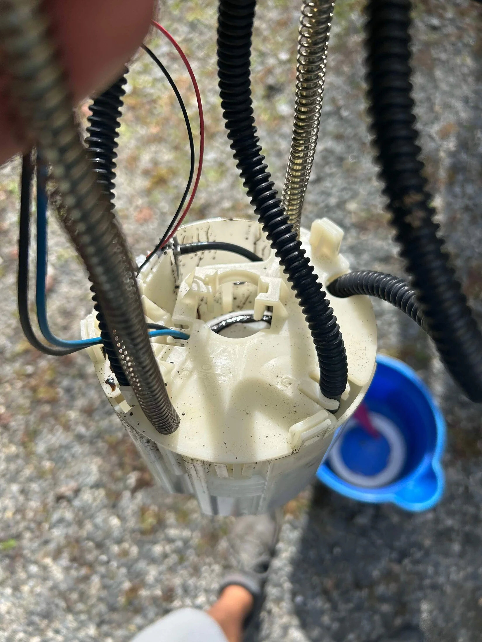

We live in WNC and were hit by Hurricane Helene. Gas was scarce so I put some from my neighbors gas can in it. Can had oil in it, which totally stopped up the fuel pump. What a mess. I was able to clean it out of the tank and replace the pump assembly. Then a few days later the battery died. So it was a rough 2 weeks. The front seat is also torn, any suppliers die the perforated leather seat bottoms? Pic of the clogged fuel pump, it was so nasty.

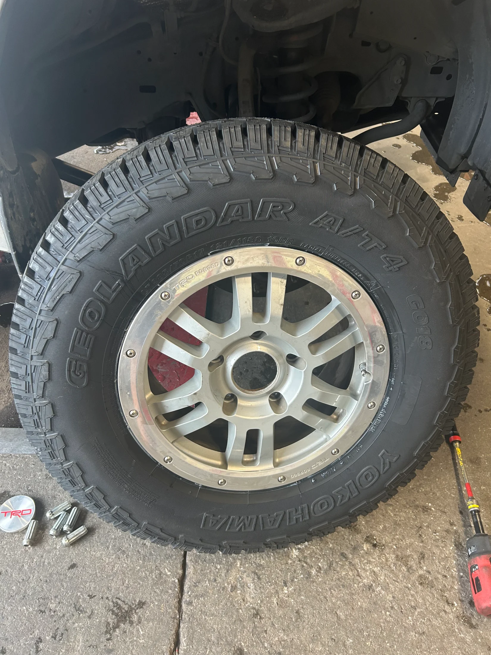

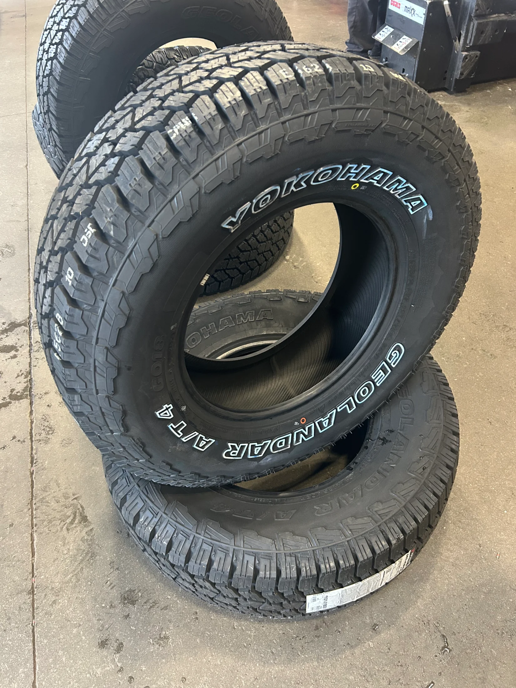

The Silver Fox is doing well, nothing but brakes and oil changes. It has the coolant valley leak that I need to get fixed, plan to address that soon. Recently got some new shoes, first set of Yokohama's and so far they are great. There are the Geolander A/T4 in a 275/70/17. Great tire, aggressive looks but smooth and quiet ride. Would recommend. Was able to price match through Discount Tire and get them for a pretty good price.
