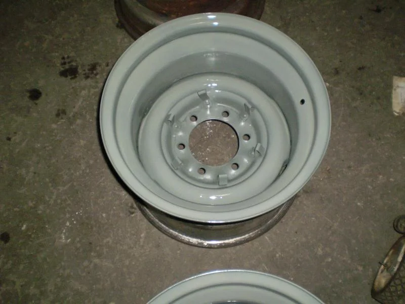

Widening stock wheels.....Texican style
you could now make your own backspacing if you wanted too...
how about some pics of the wheels finished with hubcaps? or any other pics of wide wheels?
Here ya go.....:grinpimp: :grinpimp:

The set on Garths pig came from somewhere in Kali, and they are cut and metal added......and are nowhere near true.....
Pay me????
hell you can do this.
Bolt it to the front rotor and use it with a dial indicator to true it.....
Butch
Mine came from $OR, no idea who they farmed them out to...and they are only widened to 7"...hardly worth the effort.

All of the GM's use 4" or more backspacing, and the center is way too small.......I built me a jig to true the wheels up......used an old drum spindle and hub, a section of 5" pipe and a chunk of 8" channel, works great.

Rims are from the used wheel shed here at the shop.
This is just Krylon paint, my powder coat guy has the formula for the color though.
All of the 16" wheels I have checked is too large for the stock center to fit...

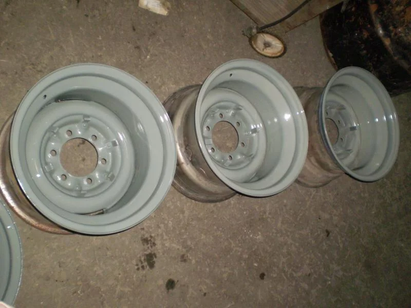

i finally got a day to myself in the garage, so i did a little garage work texican style:) still got one more to do for a spare, unfortunately, it's currently being used
