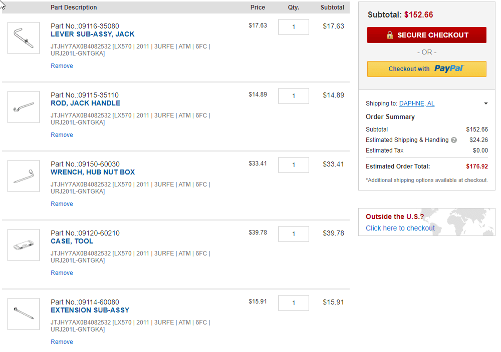

I just this week dodged a Lexus Tax buying the tool kit for the tire change. I got a cart together on lexuspartsnow.com and then another on toyotapartsdeal.com (as far as I can tell it's the same company) and the total was significantly cheaper for the Toyota versions of the EXACT same part numbers. Even the shipping was cheaper.
