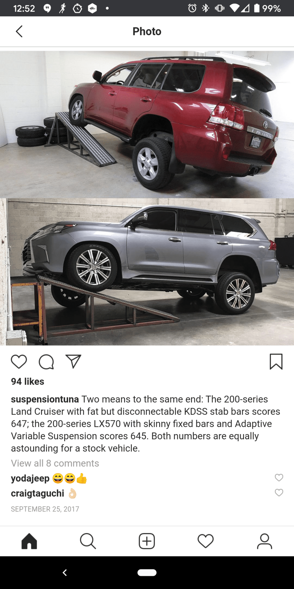

I still don't see how AHC offers more compression and droop when it still has the sway bars fully active vs. KDSS disconnecting them.
I'm not sure it offers "more". As posted in this thread the only side-by-side was 4 points of difference in the mid 500s. If this is on a 20* ramp that is about a half inch of difference in ramp-travel for a 112" wheel base. Meaning.. absolutely not a clear winner. Then again, Edmunds did it at some point and got 647.. though they apparently haven't tested an LX570.
Plus, the 4-wheeler writeup isn't available now. I don't see this getting settled until someone figures out how edmunds got that 647, and preferably tests side-by-side stock LC and LX and documents it.
My gut is that they will have near-identical scores, when you consider how AHC and KDSS operate and the physical limitations of our suspension.

Just wanted to add something that I came across a couple of years ago with reference to RTI for the vehicles when stock. As many have mentioned the articulation as measured by this type of test has the vehicles very close in "score", see below from Dan Edmunds, from Edmunds testing, on instagram.
Just wanted to add something that I came across a couple of years ago with reference to RTI for the vehicles when stock. As many have mentioned the articulation as measured by this type of test has the vehicles very close in "score", see below from Dan Edmunds, from Edmunds testing, on instagram.View attachment 2177609
What does 645 and 647 mean? What is the unit of that measure?
Hell, the extra 2 were probably just from the extra cush the non-low-profile tires gave it hahaha
