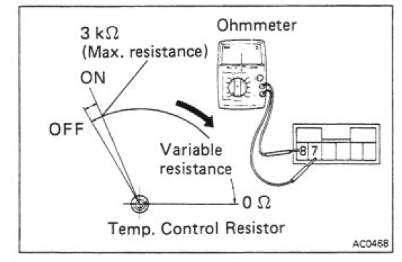

first i had aircon questions, now i have problems... i have recenlty got the aircon working (as my car never had a compressor since purchase) with a new compressor and regas. however now the ac is always on regardless of the position of the outer ring, i want to remove the switch and test it as per the below FSM diagram.
So does it normally have a 'click' in the rotating of the outer ring to turn the AC on? as the diagram shows an on/off part of the rotation travel but not a resistance which should be reading with the off position. or is the off position no continuity at all???
