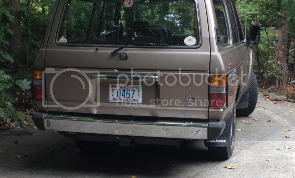

I bought a used one off Cruiseryard for $80. It is badged as a U-haul but when I sanded it down for repaint I found Draw-Tight stamped in the metal. I suggest keeping your eye out for a used one, I couldn't find anyone manufacturing a new 2" one.
Kinda hard to see in this pic. But here it is
