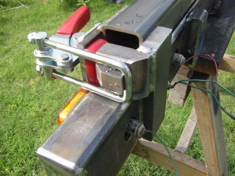

and I wonder if this could be a possible latch idea for a door?
attachment.php

Half Doors
Here are the prototype doors my son just made for me. They're designed so you don't have to mess with the hinges or striker when you change from full to half doors.
very very nice work... clean. does that handle have a spring action to it?
