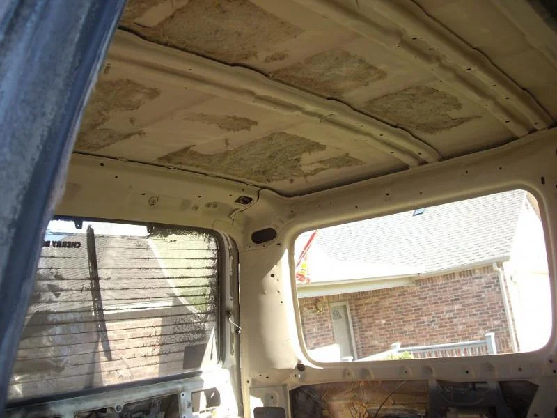

That is what it looks like after a pressure washer! Where the rear windows are actually clean is accidential cleaning from the pressure washer. With the rear most windows out I was able to get at this area pretty good. I just made sure to stay away from the dash. The rest of the wiring / electronics were all melted anyway :)

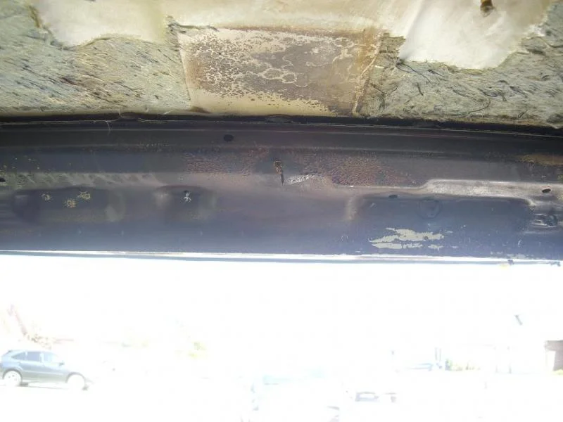

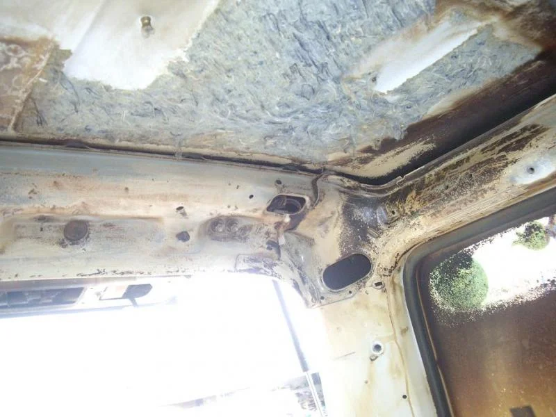

I did go out and hit the area above the tailgate w/ a brass hand brush. Came off much better than before. The area that I'd hit with the mineral spirits the soot/tar was dry and powdery, the other area's it was still stuck on hard and wasn't going to give up to a hand brush. I'll take a picture tonight to show what I'm talking about. Still lots of tight areas though too, which the soda blasting might help with.

ok, here's before anything was really done, and after minerial spirits and a brass brush. The little areas are still tough to get, and I'm leaning toward before I go soda, doing walnut blasting w/ the blaster I already have...
