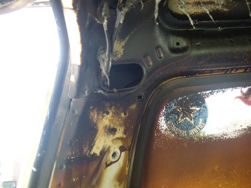

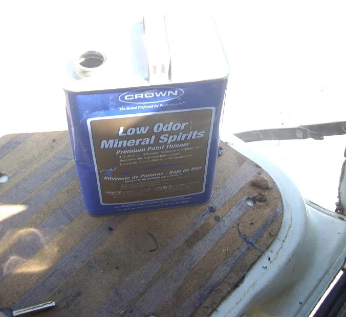

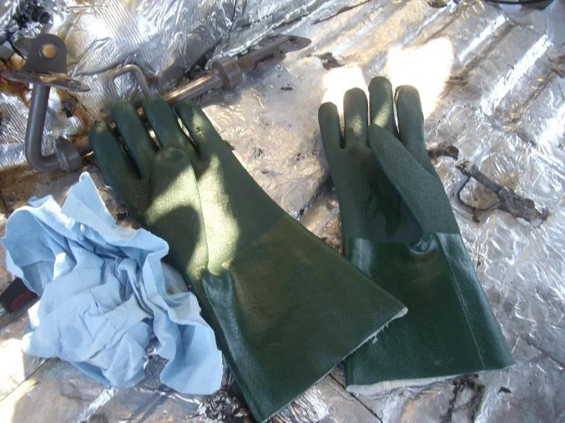

Finally got a few minutes while the kids were asleep to try and clean some of the tar. I thought I had some alcohol around, and I think I do, as well as some zylene, but the garage is a mess right now, so I just grabed some minerial spirits and some rubber gloves and sat down with some rags and started rubbing. Unless the zylene or alcohol cuts it better, the wire brushes are coming out. The lighter areas won't be an issue to wipe down, but the area's in the photos are the worst.
