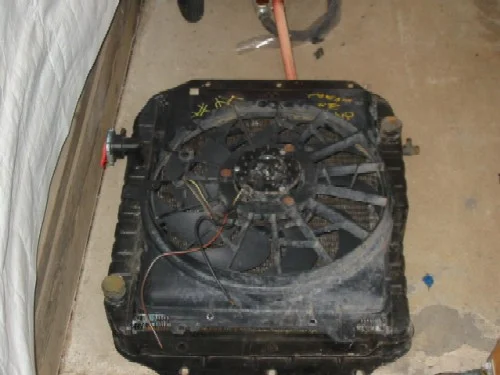

Here is a pic of what you need.
Based on the ones I have used, the Taurus fans have a slightly smaller shroud than the MrkVIII. There are at least a couple of variants within the Taurus fans too (shrouds).
Mark...
large aerostar ford with 4.0 has a nice one that fits good also if you cant find a tarus fan good luck

there are two primary low mounting height taruas fans.
16" blade big shourd longer
16.5" blade
The M8 is a bit bigger then i would use, unless your some crazy BBC blown, etc... and also has a bit more depth then the two above.
I run 16.5 blade, no need to cut the shroud, on a mild build 406 and stock cruiser rad without issue.
