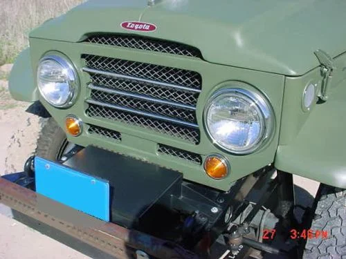

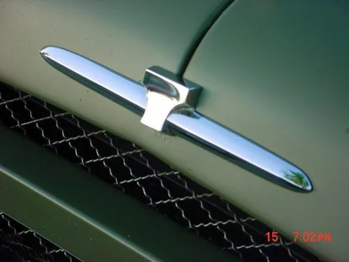

Is there in any parameters around which hood ornament 25s have? It seems in all the pictures I can see the Round Toyota is only outside the US and both types appear on pictures of Aussie 25s.

The earlier FJ25s had the oval. The later ones got the T bird. I think Australia got them a little ealier that why you see both there. Here in the US Toyota had already made the change to to the T bird. There may be one or two oval emblems here in the US but those were from cruisers imported later from other countries.
Yes the oval is found on '58 and earlier, and the T-Bird is on the '59 and '60. Also, the T-Bird hood emblem was matched with the "Toyota Land Cruiser" apron emblem, while the oval was matched with the block letter "TOYOTA" apron emblem.
The oval goes back all the way to the 1954 Toyota BJ Jeep. Only difference is the BJ oval was painted the same color as the body, while the 20 series oval was chromed with a red paint background.
