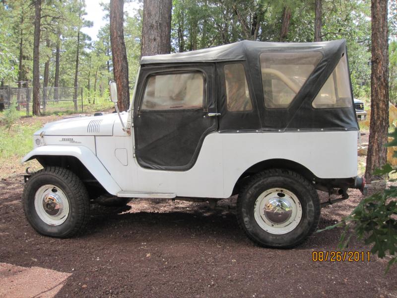

After being store under a tarp since I bought it in 2002 and not being started for the last couple of years now that it's kept in a garage I decided it's time to fix up a few things. While my grey 25 has a very stock back end this one is anything but:crybaby: Why is it POs feel the need to add forty pounds steel to make a receiver hitch:confused: This is a AZ original cruiser that started it's life on a ranch in soauthern AZ. From what I understand it was givin to a lawyer in the eighties some time to pay part of the ranch's bill. It sat in his backyard. Then in the ninties he was going to have it hauled of for strap metal. A friend of his (state judge) said he would take it. He had it rebuild (not restored) to what it is today. Not sure what happened at the ranch but the rear crossmember has seen better days.
On the short term the plan was to grind the hitch off and and just drill holes in the correct location for the OEM bumperettes, pintle. After lookng at at it I figured removing the hitch and rear crossmember together would be far easier then trying to separate them. I'm hoping the early FJ40 rear crossmember is close enough to use since I have one. On the plus side I noticed the spring perches for the FJ25 are not riveted or welded to the rear crossmember like the FJ40. The rear angles from the FJ40 will stay with the crossmember so only rivets on the top and bottom of the frame will need to be removed. Is it just me or is the shackle installed backwards? The nuts should be on the inside right?

Not sure what metal I would have to put back. I plan on replacing the the whole rear crossmember and angle braces together. The side rail of the frame look to be in good shape. I need to get a good picture of the replacement crossmember. This is off of a 63 I got a few years back. The 25 is up north at the cabin so this isn't going to happen over night. But I'm thinking of tackling it over the winter.

This is a cruiser that spent most it's life working on a ranch. Don't let the pretty paint on the outside fool you it's had a hard life.

Sounds like a good idea. Problem is this is in a rural area. No welders that I know of close. But the only welds that need cutting off are the ends of a flat bar for the hitch to the side rails. My biggest problem is going to be removing the rivets off the top of the frame. The tub needs to high enough to drill them out. I have had good luck drilling the rivet with a big enough bit for the head to come off then a smaller bit thru the center but not all the way thru. Then use a punch and the rivet collapses in. Any ideas of how to get the rivets off with the tub in place. If it was just the rivets acroos the back I could problem remove the front clip and side the tub forward. It's the two rivets for the angle brace that are going to be tricky. But doing it that way The eight rivets on the back with still be stock.

This was definitely a working truck. The three holes on the side of the fender well have a plate behind it that is welded to the frame. Same on the other side. Maybe some kind of A frame was attached to lift boulders and move then out of a field:meh: It also have some kind of bedliner on the in side.

The crossmember is in sad shape. It's not flat. Where the pintle hook would mount is raised. Most stock holes are welded shut and other holes drilled. If you look at pictures 1 & 2 in post one and the second picture in post two you can see a piece of flat bar has been welded to the botton of the crossmember. It's almost solid welded all the way around. Between all the welds that would need to be ground off and then how bad the crossmember is it makes more sense to replace then repair. By keeping the angle braces attached the rivets that show on the back will be stock. The original crossmember has half them missing. Two things are different than a FJ25. One the two holes for the tail light bracet need to be filled in since the bracket mounts to the tub on the FJ25. The second difference is something nobody would know unless they have both FJ25 and early FJ40.:hhmm:
Not sure about the floors. The PO did way to mount body work on the outside and almost nothing on the inside. The spot welds on the side have been fill in. Since I'm thinking I'll end up with the after market top and keep the roll cage the floor is minor either way. The plan is to install Torsen diffs front and rear and use it as light wheeler.
Since the plan is to use this as wheeler will also make it so I can remose the bumperettes and bolt the angle iron piece I removed from my latest FJ40. The PO put some thought into this home made bumper. While he drilled new holes on the ends I will drill the angle to match the bumperette holes. I will also drill holes where the rivets on the back are.
The receiver hitch will be removed. A stock Toyota pintle hook will still fit with the angle iron in placed.
