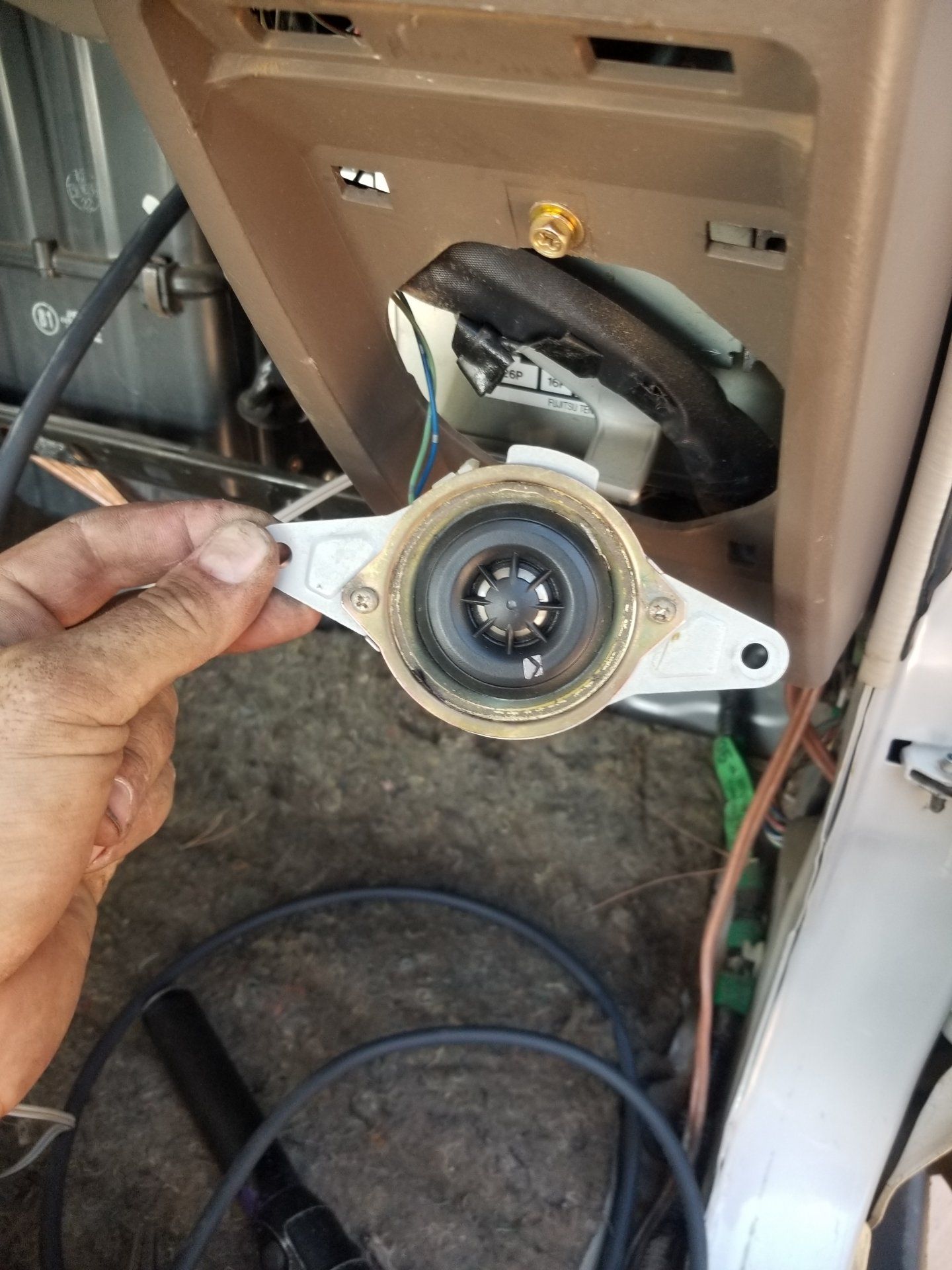

I was able to install my tweeters in the OEM locations inside the dash.
My crossovers went under my drivers seat next to my amp. I used velcro to stick them to the carpet.
This is exactly what I did. I like the discrete location, and it sounds really good too. I would do it again for sure.
Yeah, I also feel like this position worked out great. I figure if the all mighty Toyota engineers put them in this location to begin with than they must be up to par for my feeble ears....
