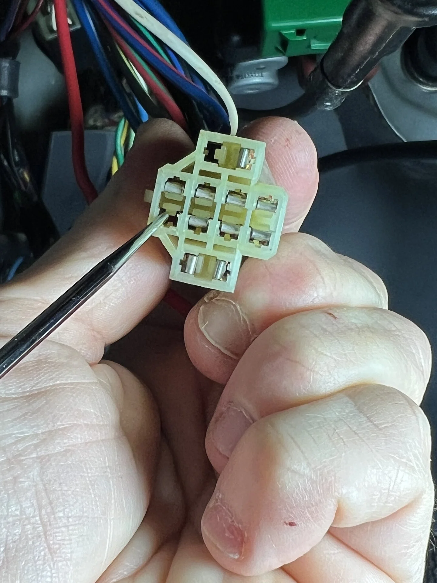

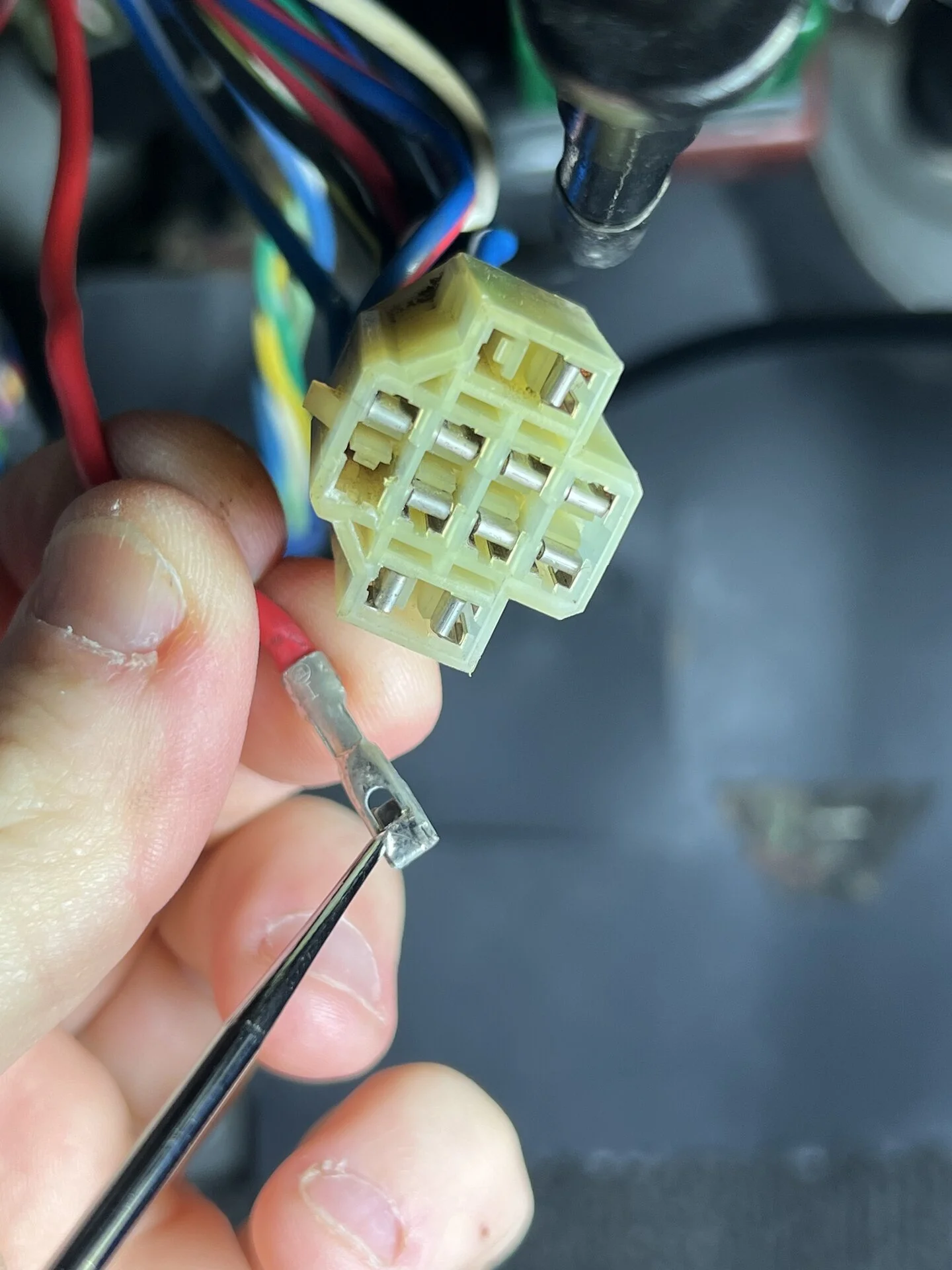

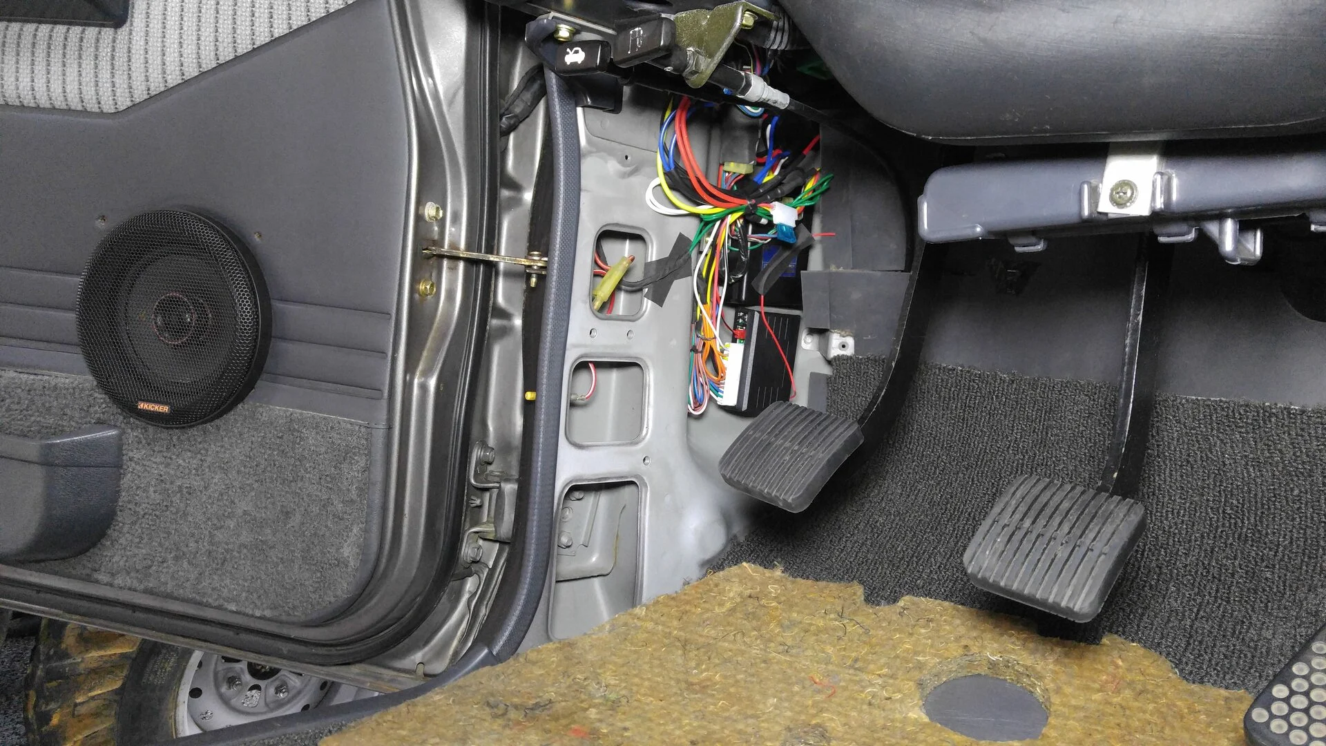

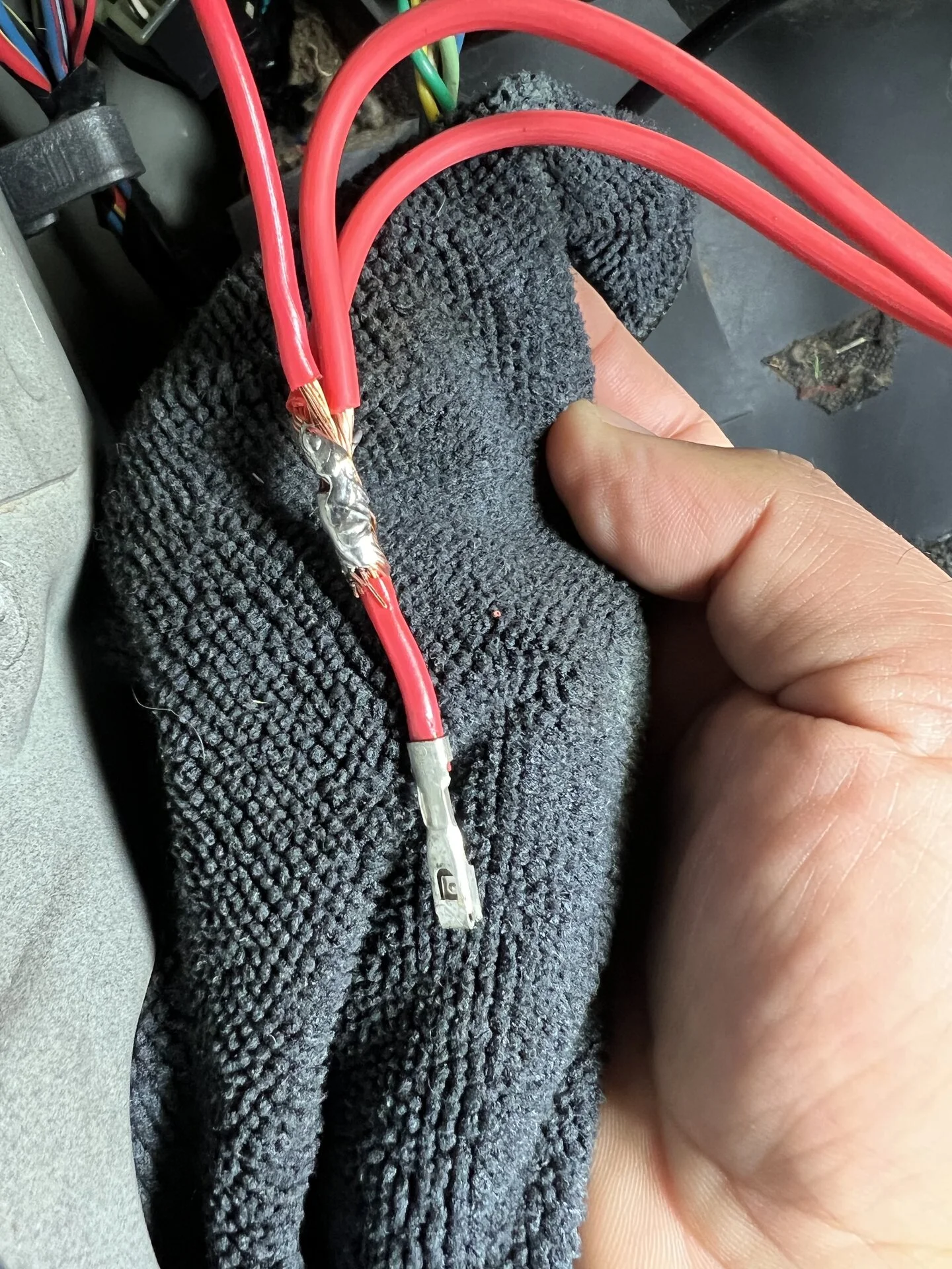

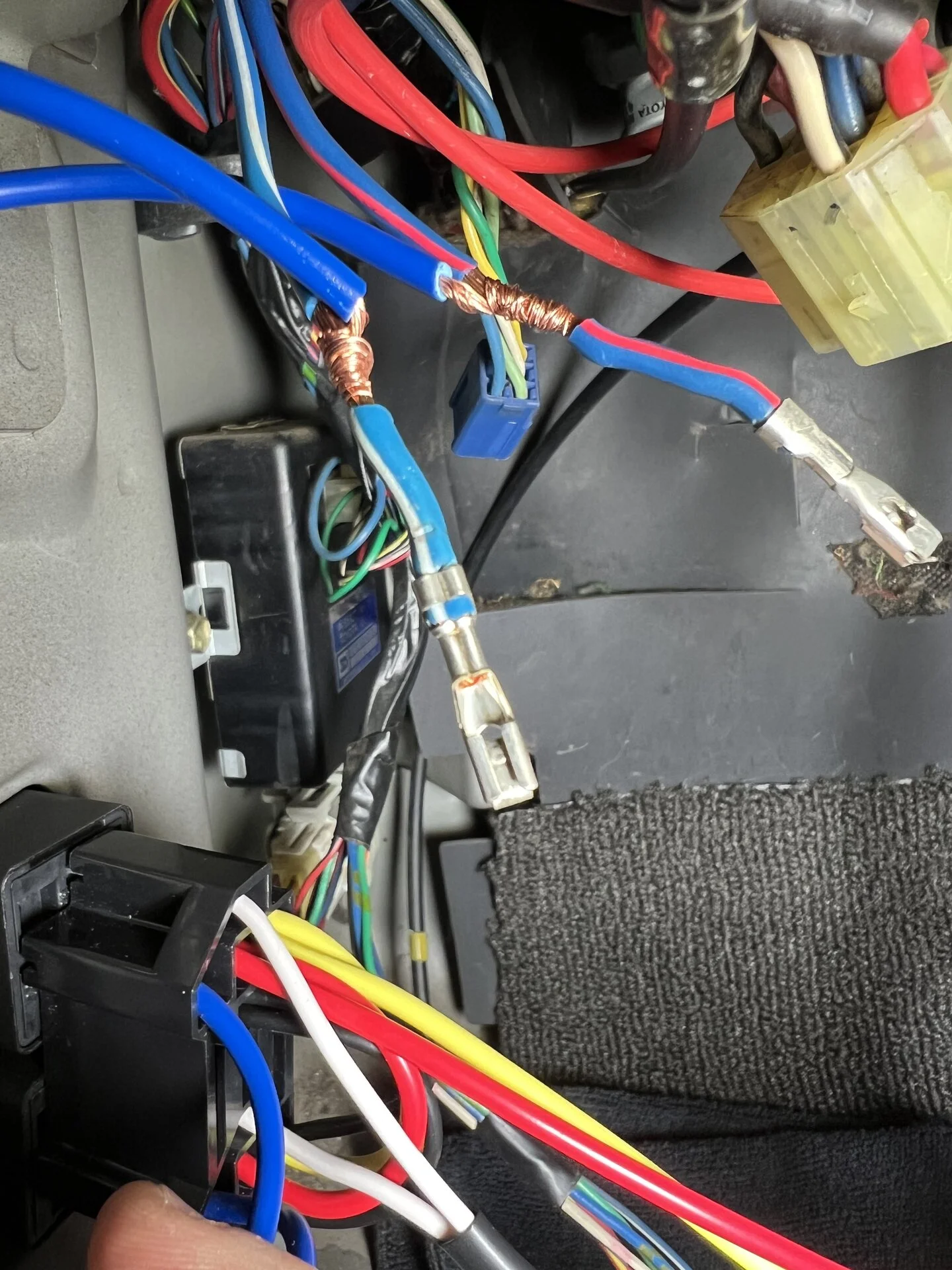

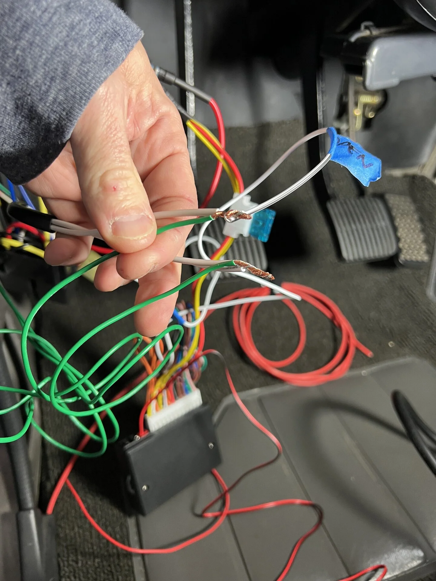

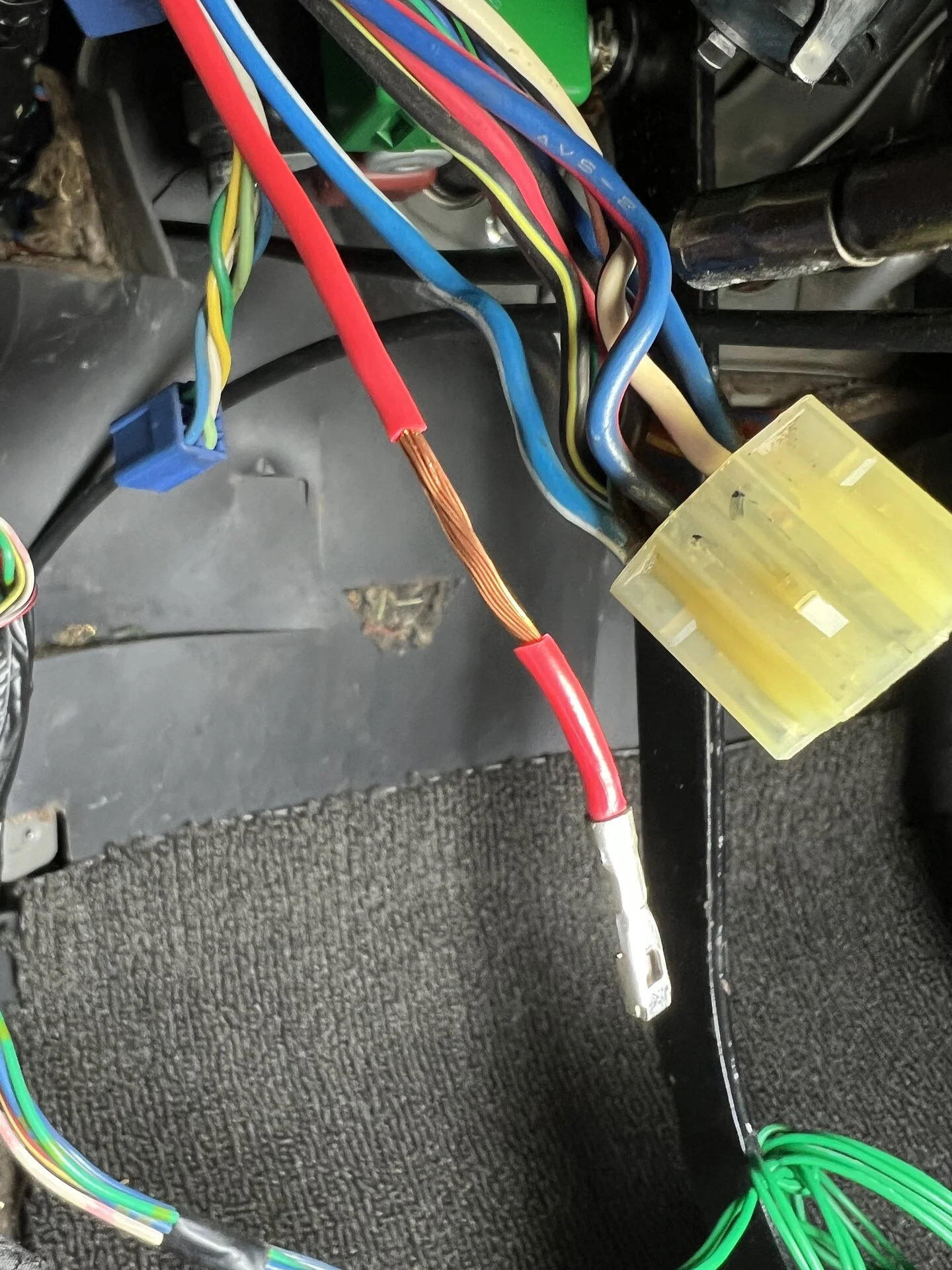

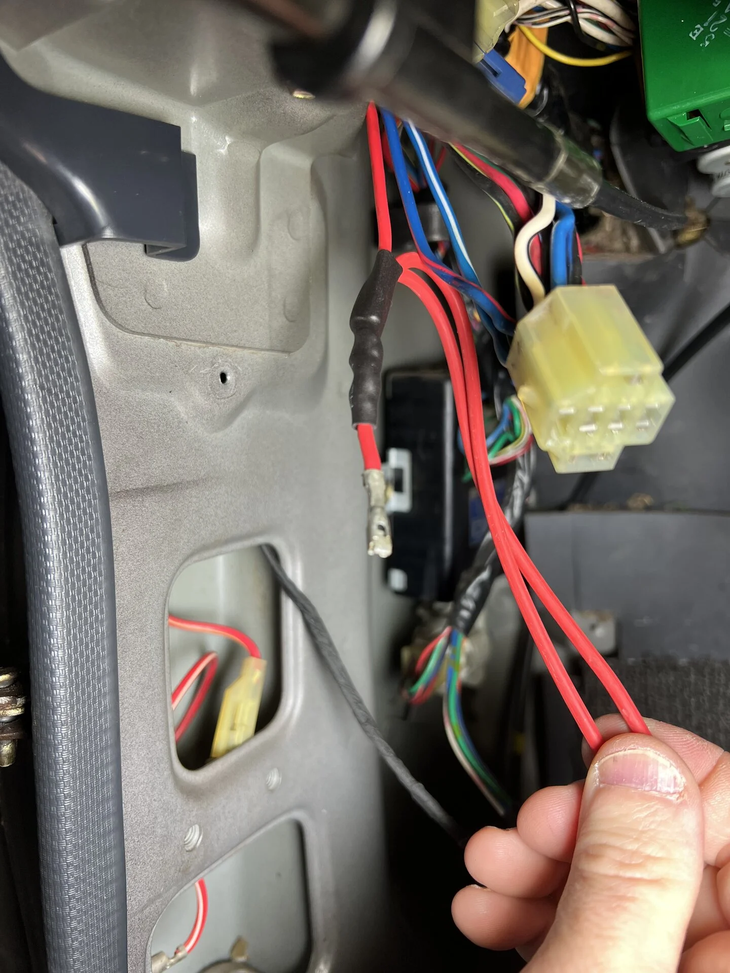

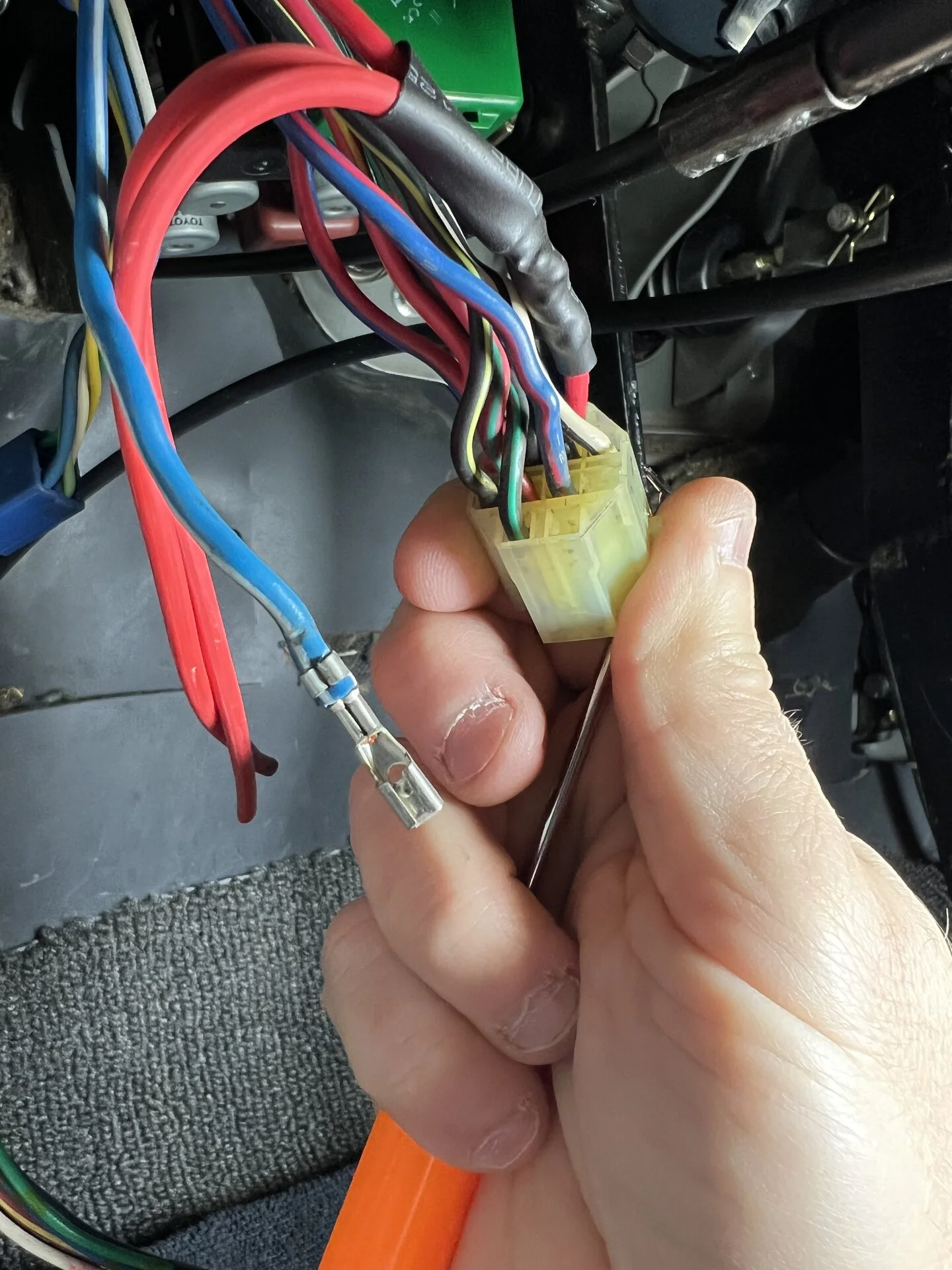

Step 5: From the body hardness plug (under the dash) we started by temporarily removing the Red Power wire from the plug, and then adding (soldering) 2 x short lengths of power wire to it (one to connect to @LA Z ’s relay harness and the other for the Universal remote locking brain… we added connectors to those power wires so we could disconnect them easily if needed.

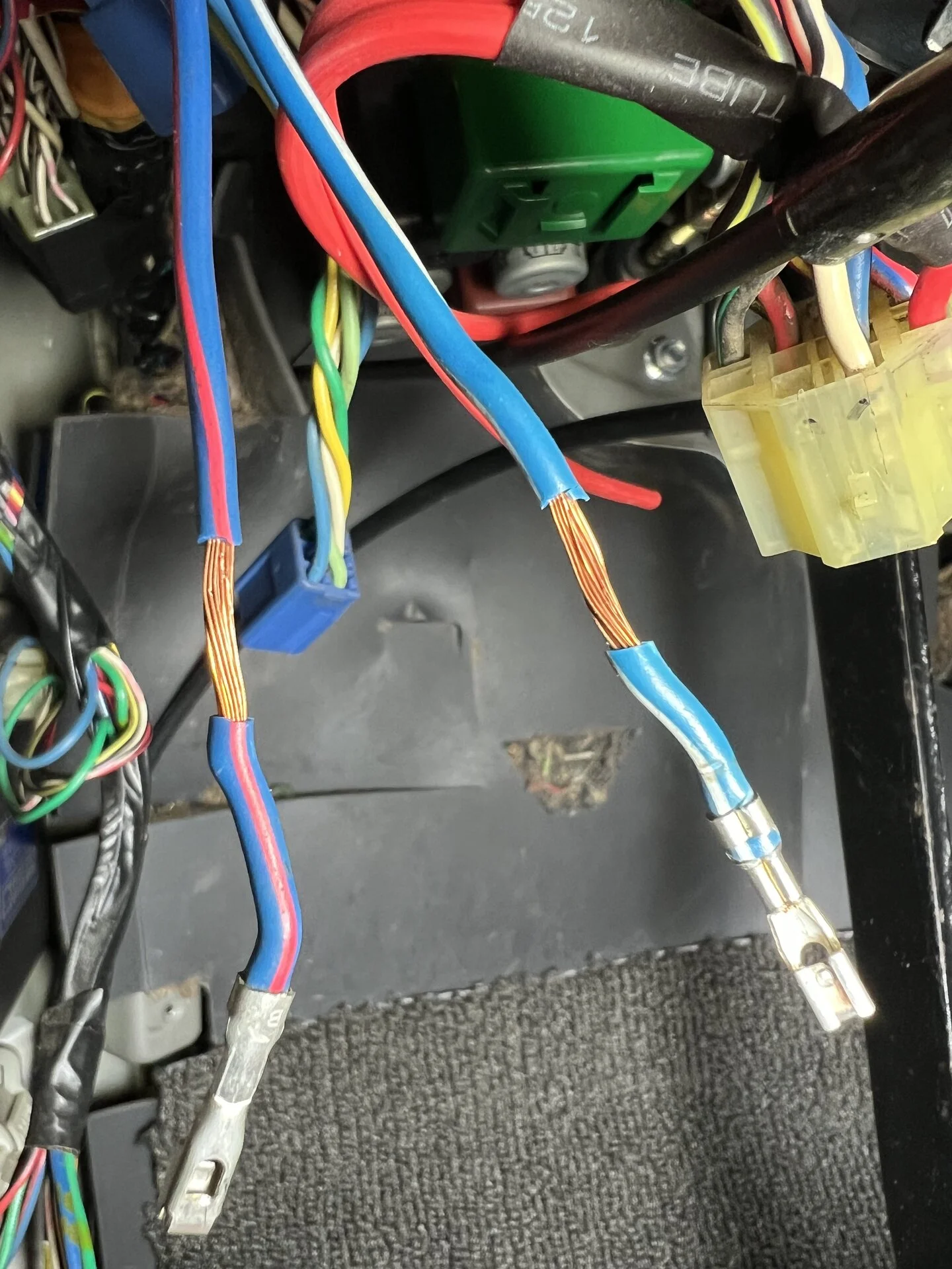

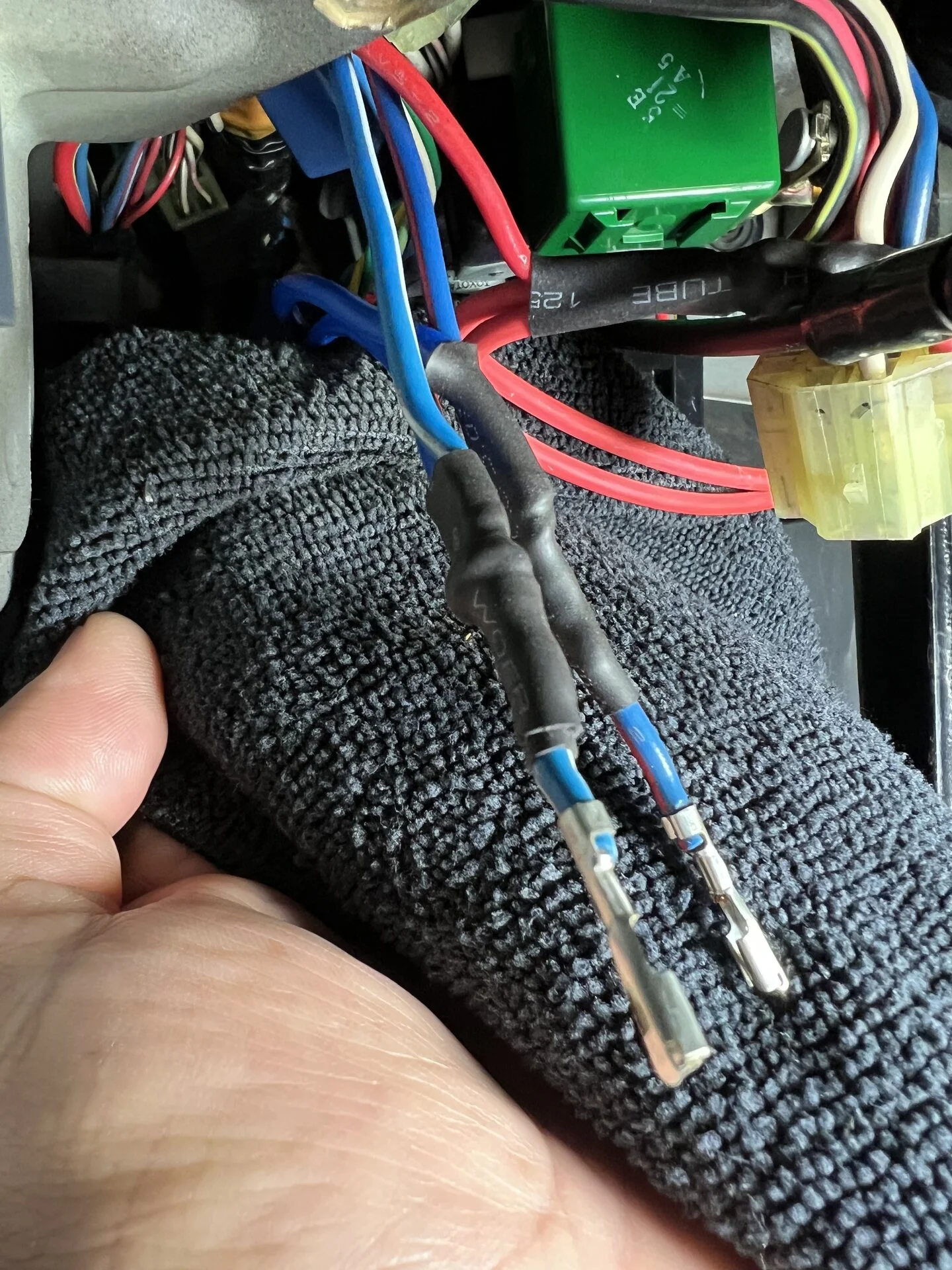

Step 6: We pulled the B/R and B/W out of the under dash plug and soldered the Blue wires from the @LA Z relay harness to the B/R and B/W wires that we pulled from the plug and got that heat shrunk… it doesn’t matter which Blue wire from the harness goes to B/R or B/W.

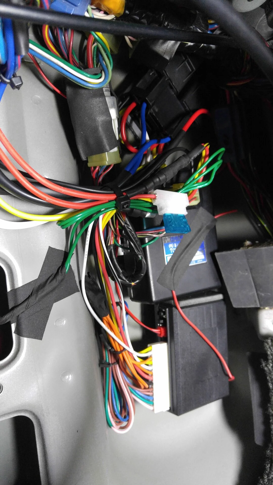

Step 7: After putting the R, B/W and B/R pins back into the plug, we addressed the “signal” wires… We combined one of the W from @LA Z harness, one of the 18/22 AWG wires that we ran from the door, and one of the Signal wires (lock/unlock) from the universal remote locking brain. And then we did the same with the other W wire from the relay harness, with the other 18-22 AWG wire, and the other Signal wire from the remote locking brain.

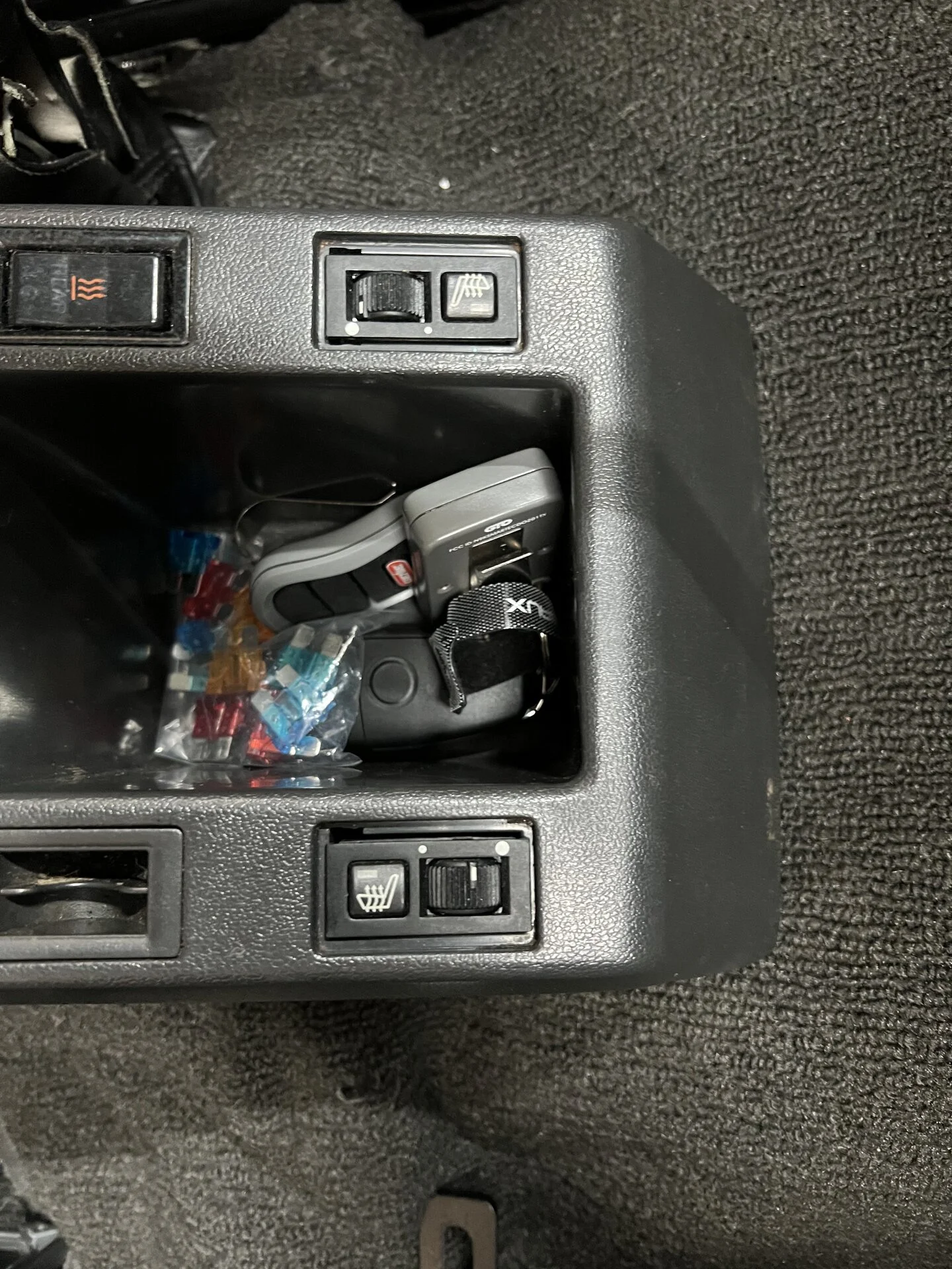

Note 1: You should use the instructions for your Universal Remote Locking for “Positive Trigger”. For the Universal, we just bundled the 3 x power wires and plugged into one of our Power wires that we added to the Body Harness plug. We had 1 ground wire that we ran to ground. The only other wires that needed to be used since all that we were using with the Remote Locking kit was the door lock/unlock piece, were the signal wires for Lock/Unlock (W and W/B)
Note 2: You will need to follow the Learn procedure for the remotes that are provided with the Remote Lock kit and loosely connect what we did in Step 7, and make sure that the lock on your remote corresponds to locking the actual doors… if it’s backwards, you need to just switch the signal wires.

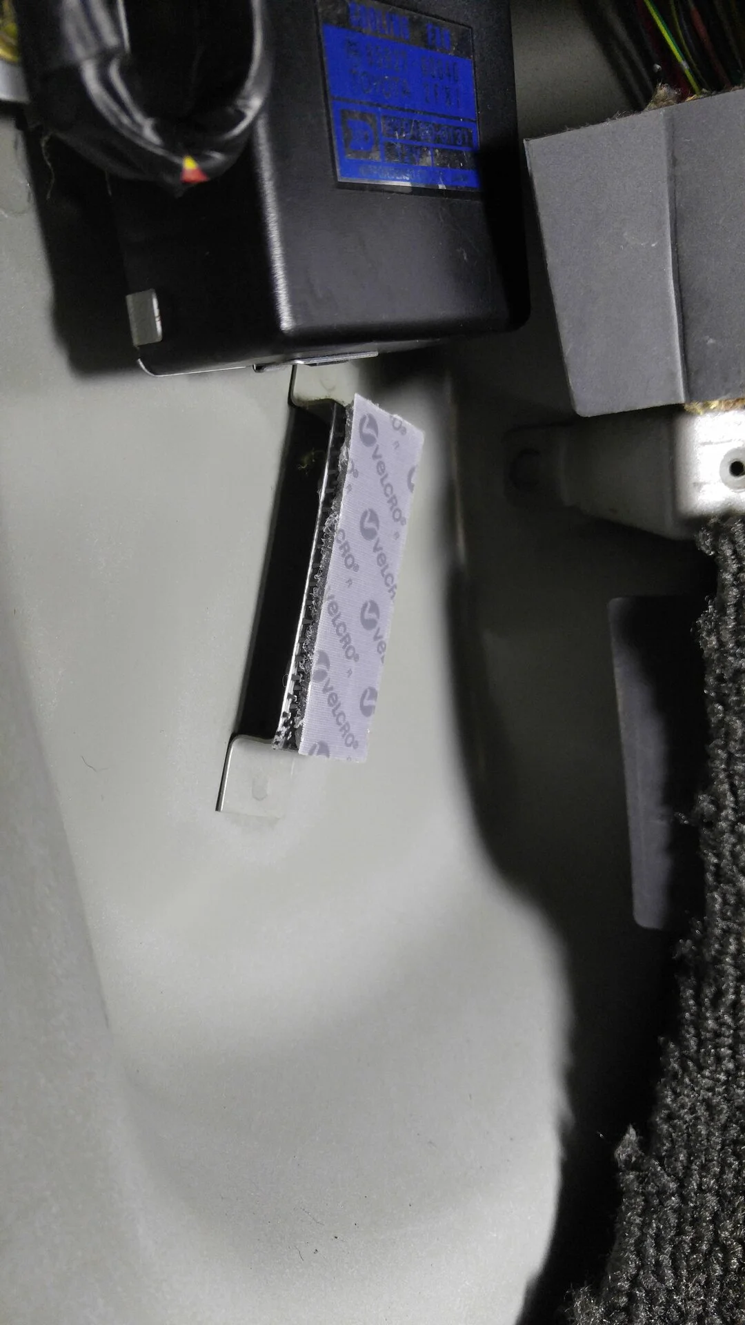

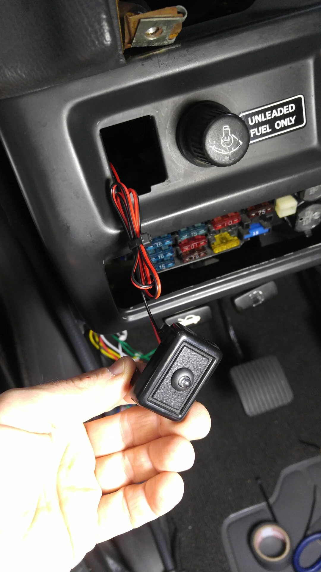

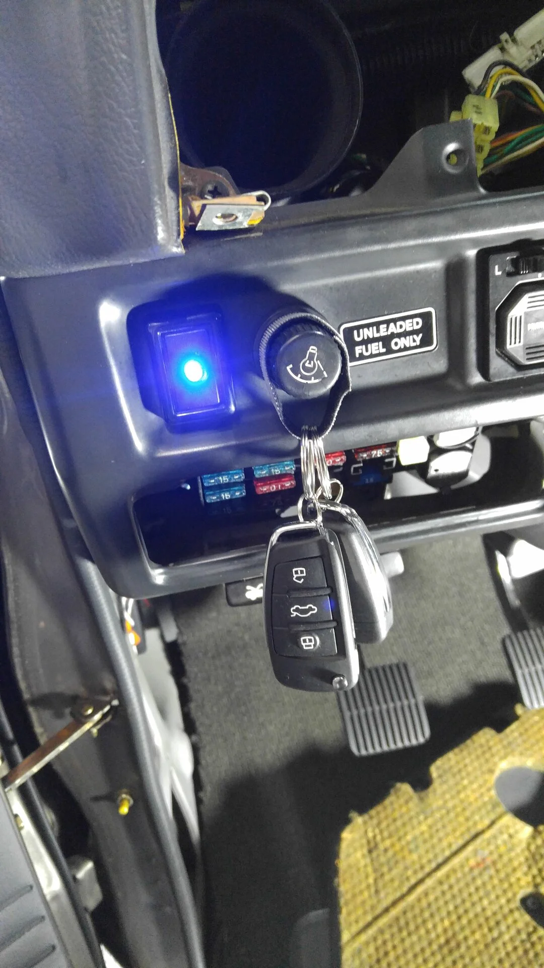

Step 8: Clean it all up, stuff it behind the kick panel (@SkeeLo22 made it look soooo pretty) and we used the LED that came with the Universal kit, not because I like it, but I did have a blank AND maybe someone will think it’s an alarm with sirens from the outside.

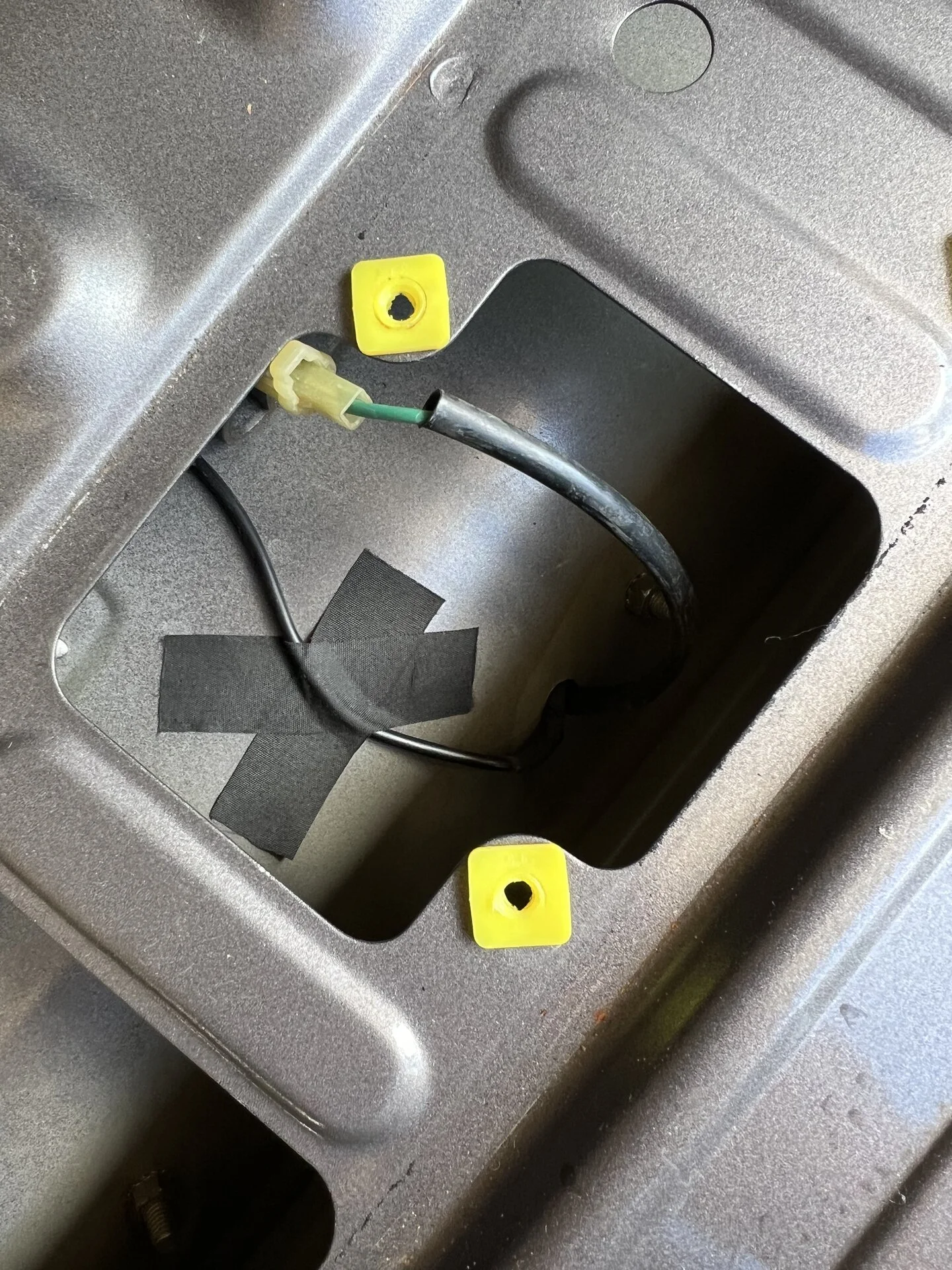

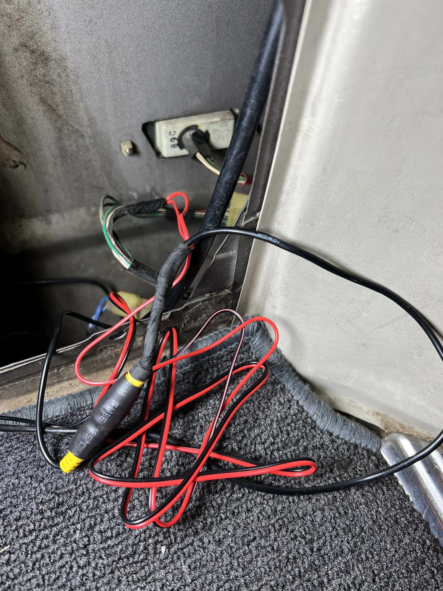

  • Ran the rear view camera into the tailgate grommet and mounted above the license plate… I’ll get a picture of that tomorrow. It wasn’t as bad as it was in the FZJ80…
  • @SkeeLo22 played with his favorite tool (soldering iron) and got the power wire for the camera as well as the signal wire that runs to the front (with the video cable) to connect to the trigger wire for the head unit, all attached to the red/blue reverse light power wire.. and got everything loomed and tidied up
  • He also found a great ground for that setup…

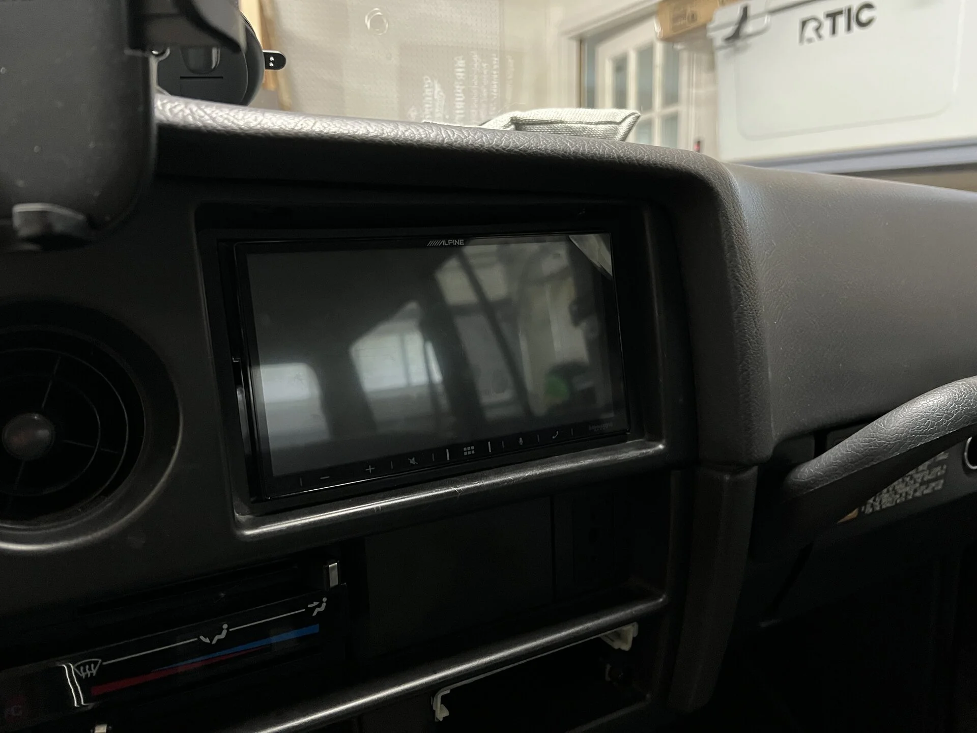

So I am seeing the light at the end of the tunnel of all of this MOFU electrical work…
  • Alpine ILX-W650 mounted
  • Rear camera hooked up (and working)
  • Kicker amp is basically tuned
  • Dash face is all put back tofether

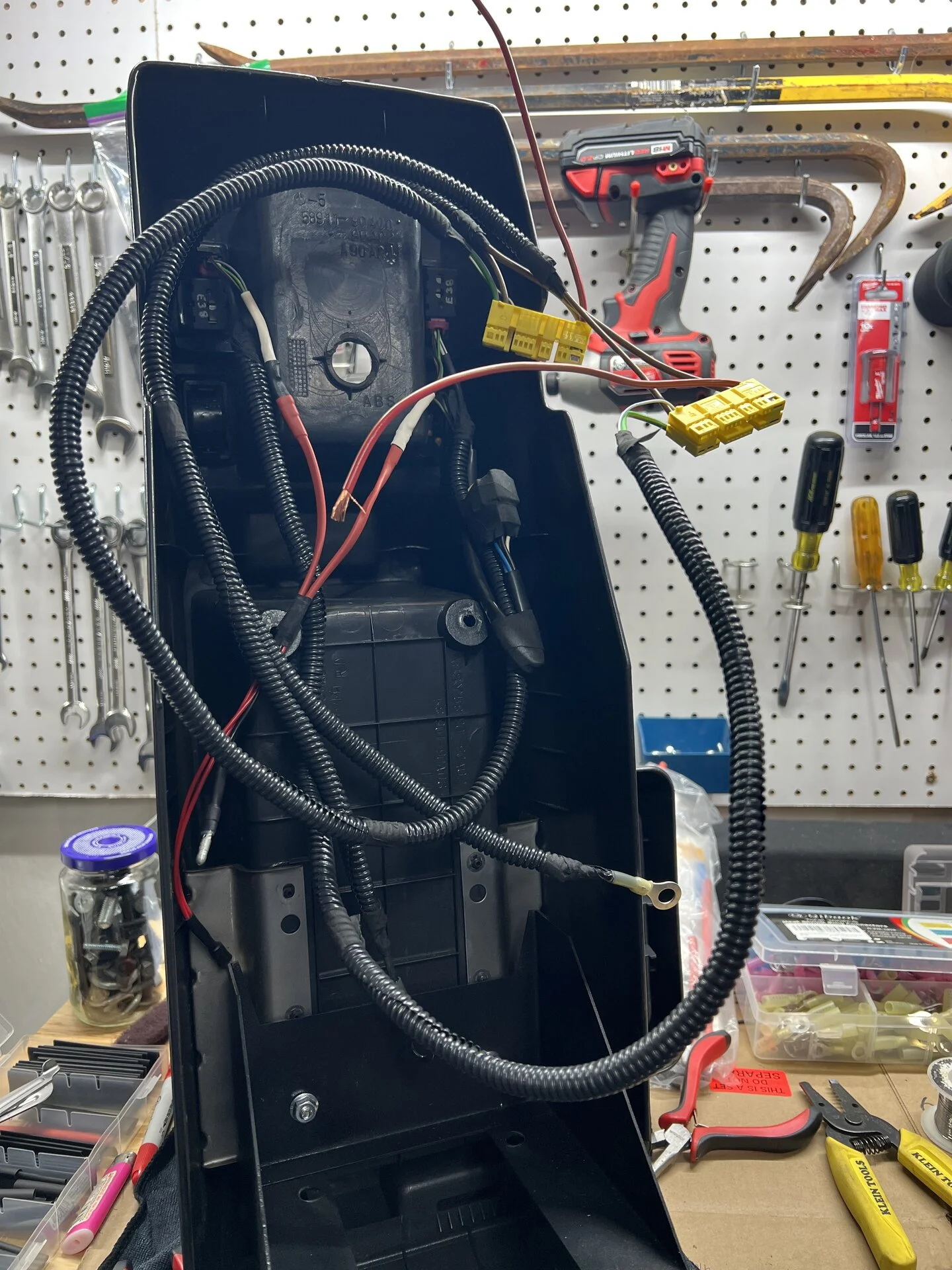

  • And the wizardry that @SkeeLo22 possesses is under my stock center console… all cleaned and loomed and heat shrunk for the E46 BMW powered seats with heat to go in tomorrow…
We still have small odds and ends to investigate/wrap up but man oh man, she’s coming together…

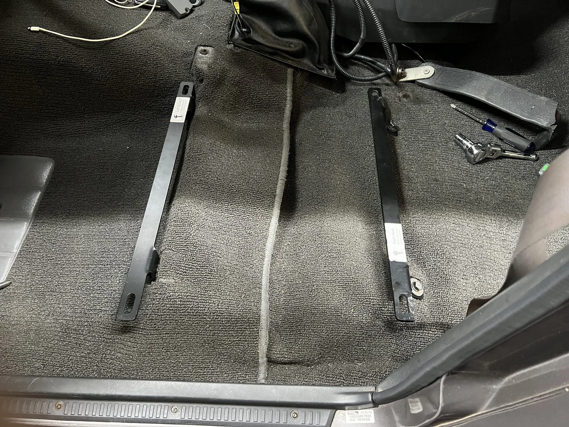

  • @torfab BMW FJ60 brackets are in a snug, not comin out again…

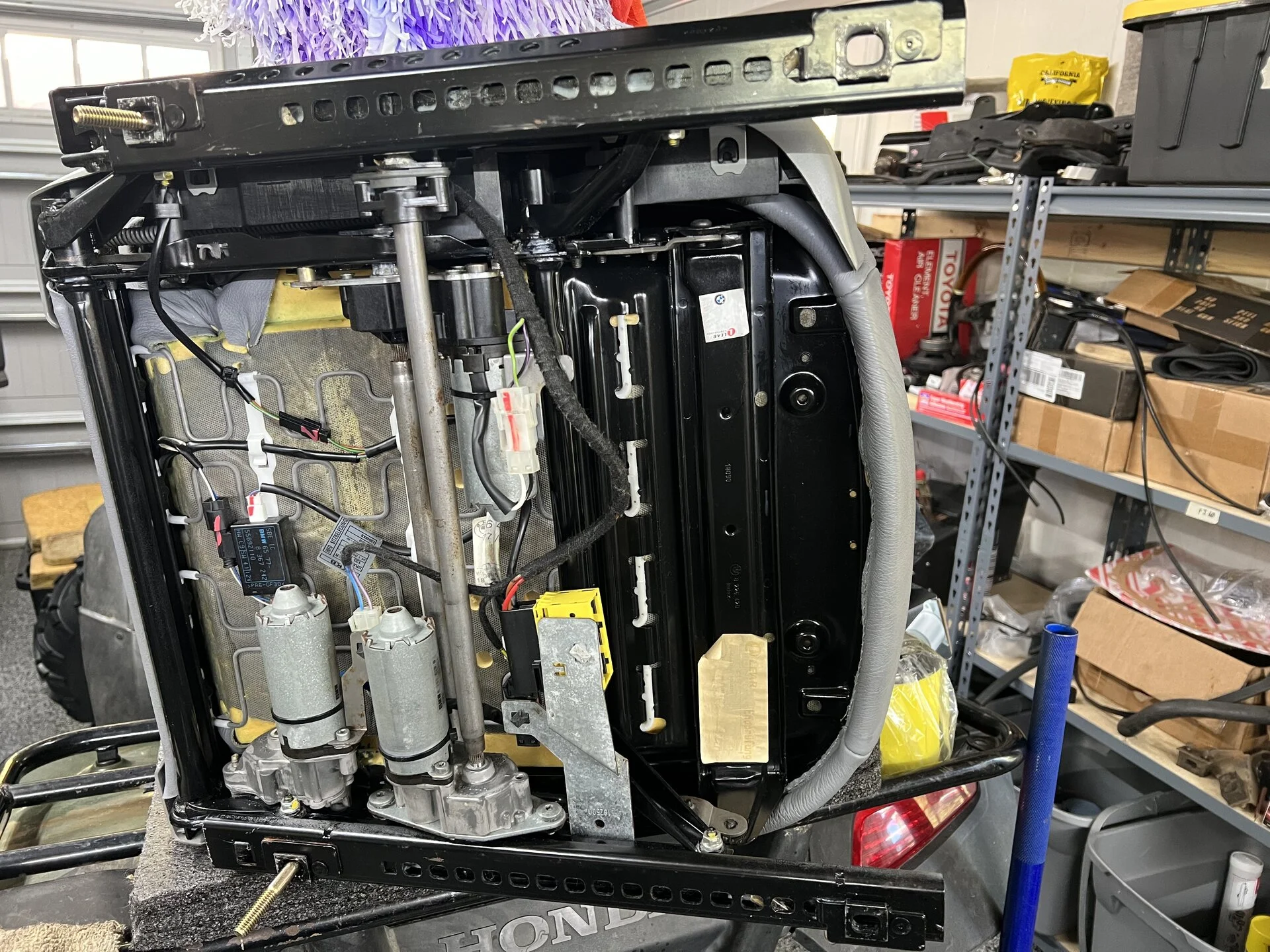

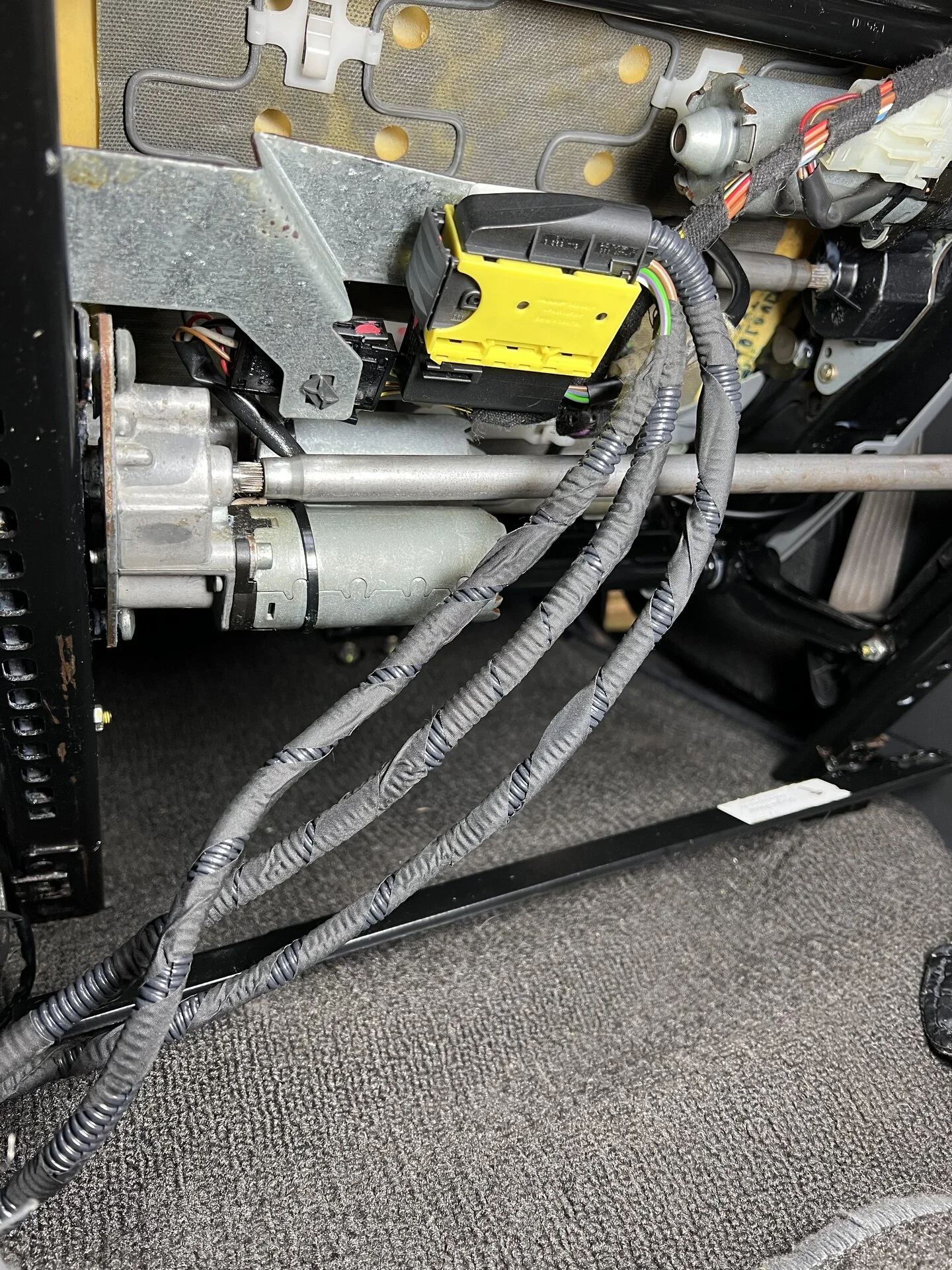

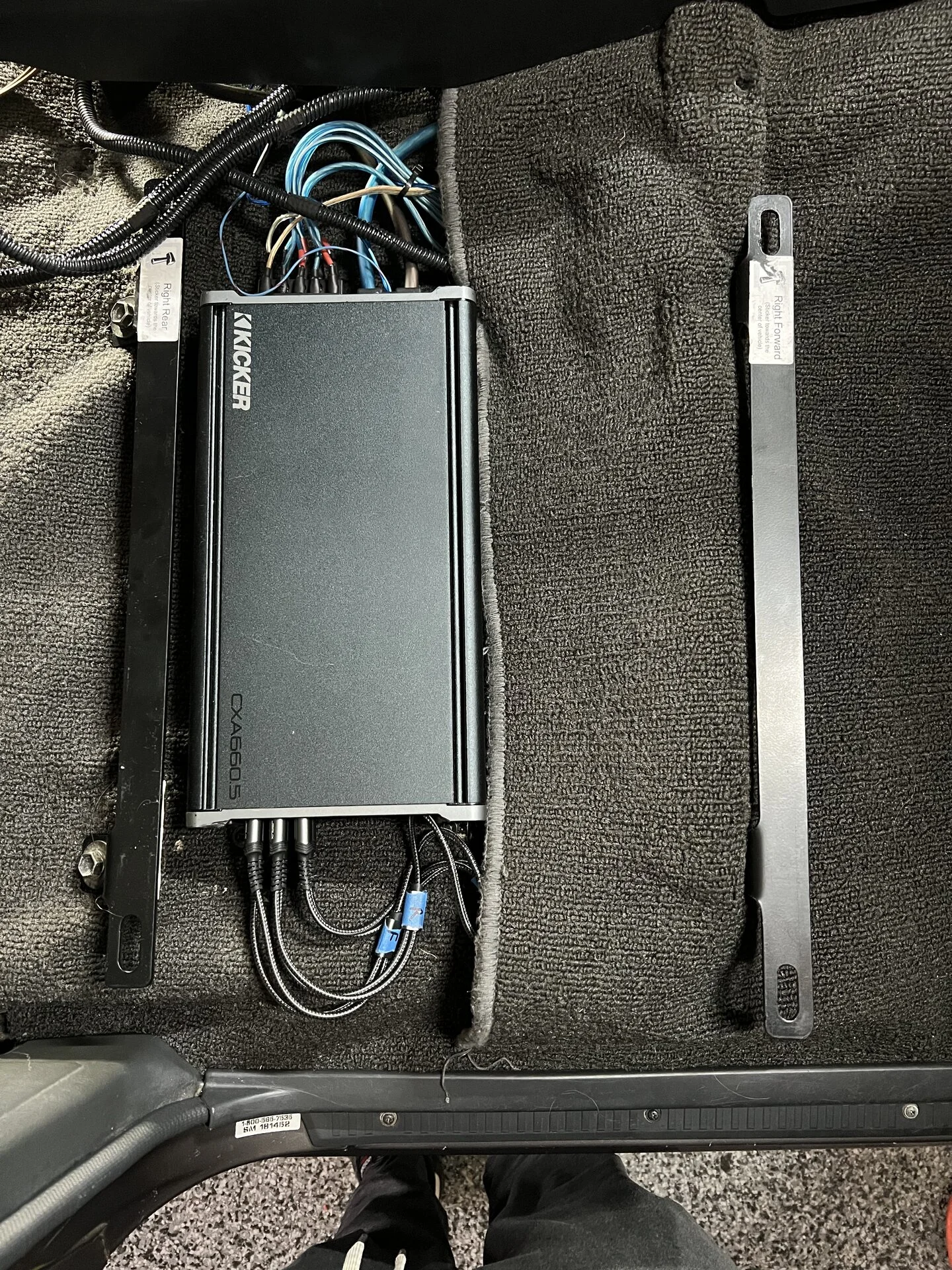

  • @SkeeLo22 comin in hot with the underside cleanup of the seats because hopefully not gonna see the bottom of them for a while…

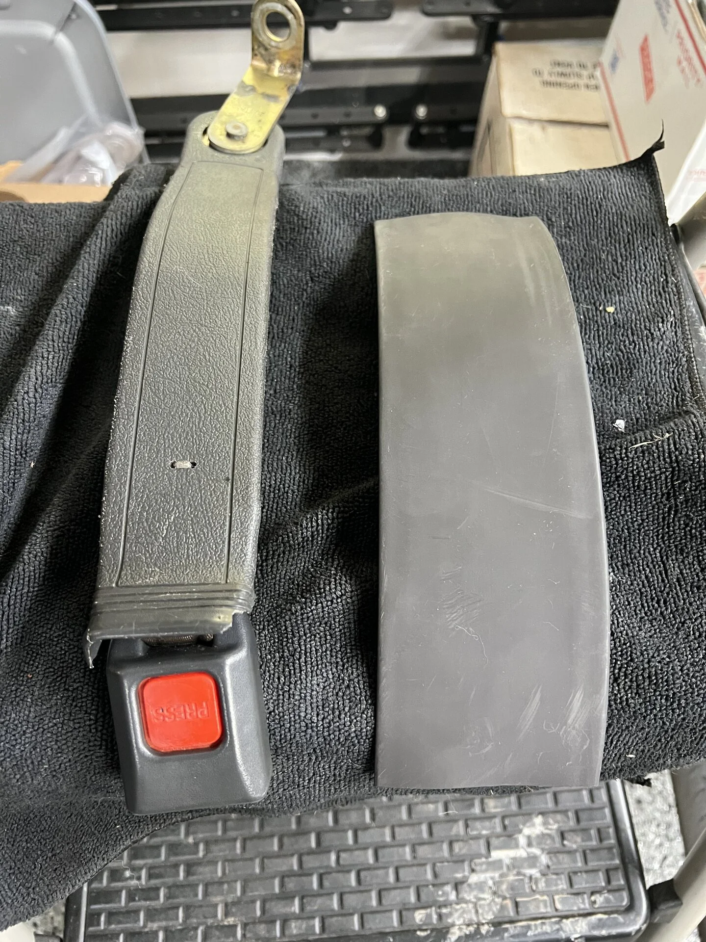

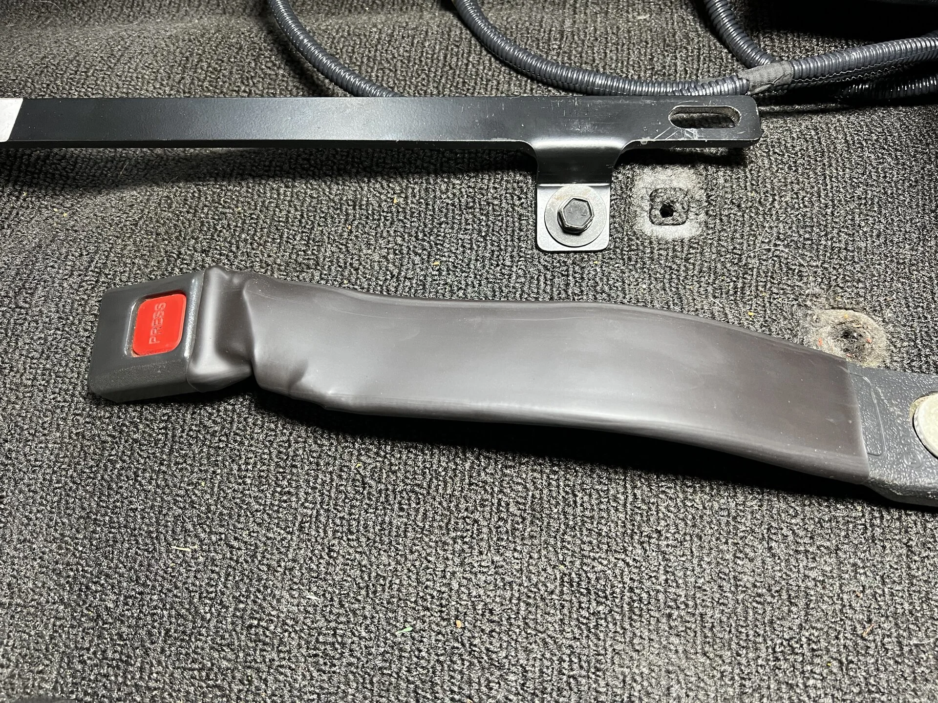

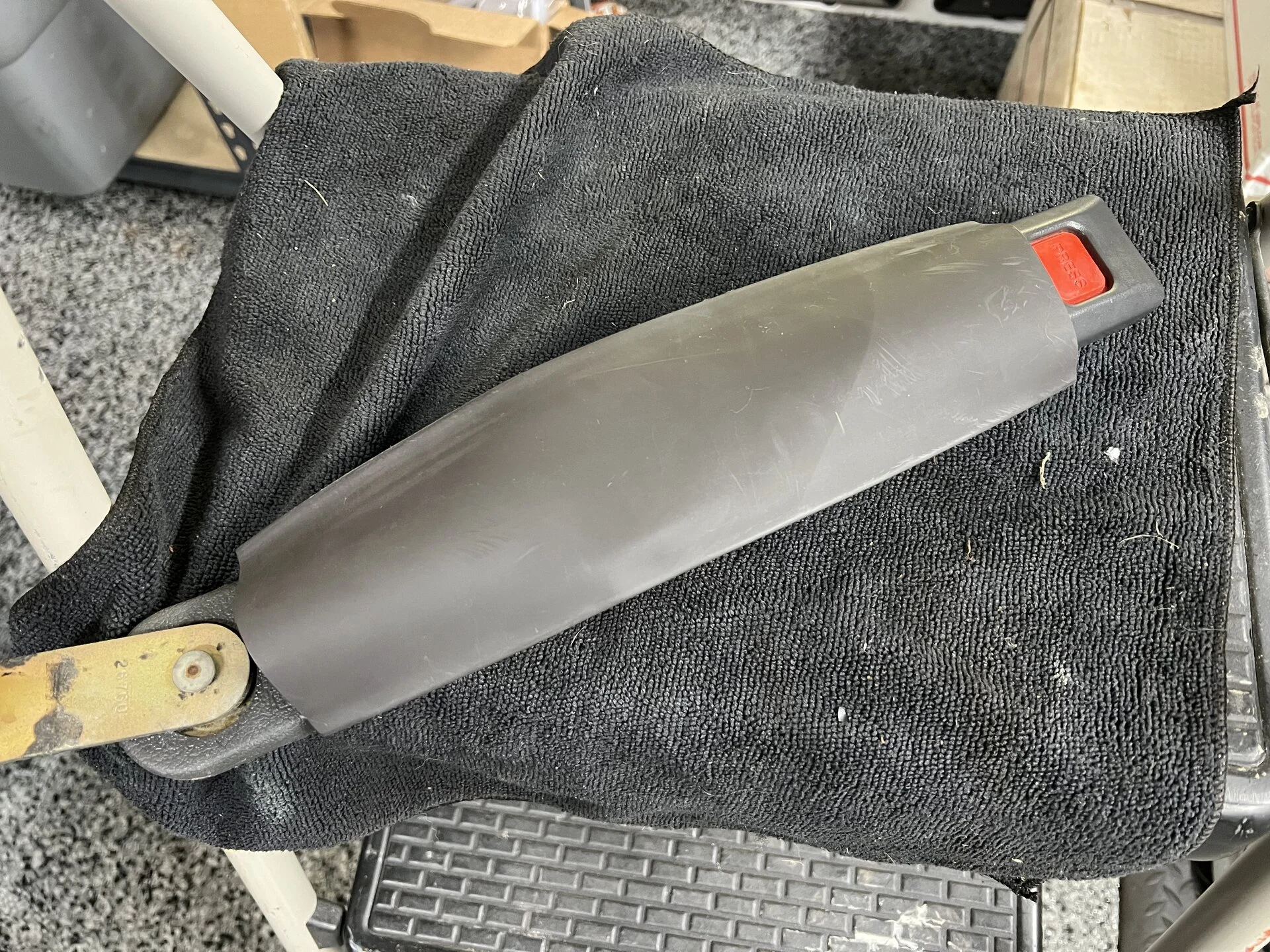

  • He also had the bright idea of 2” heat shrink to take care of the seatbelt buckle receivers since replacing the broken plastic would involve removing a rivet and figuring all of that out… worked splendidly…
  • And then it was about mounting the drivers seat and testing out all of the wizardry and all I can say is IT ALL WORKS.
  • Also final-mounted the amp under the seats, so the passenger seat (with small spacers) can be mounted…
There’s still a couple brackets that need to be cut off the back of the seats on top of the tracks because the interfere with the seatbelt buckle receivers so gonna take the driver seat out again on Sunday and grind those off of both seats, but otherwise the seats function, both moving and heat great, and I love the upgrade from 34 year old foam… can’t wait to get em in for good and put some miles on her…
Also need to go grab some shorter hardware for the seats…

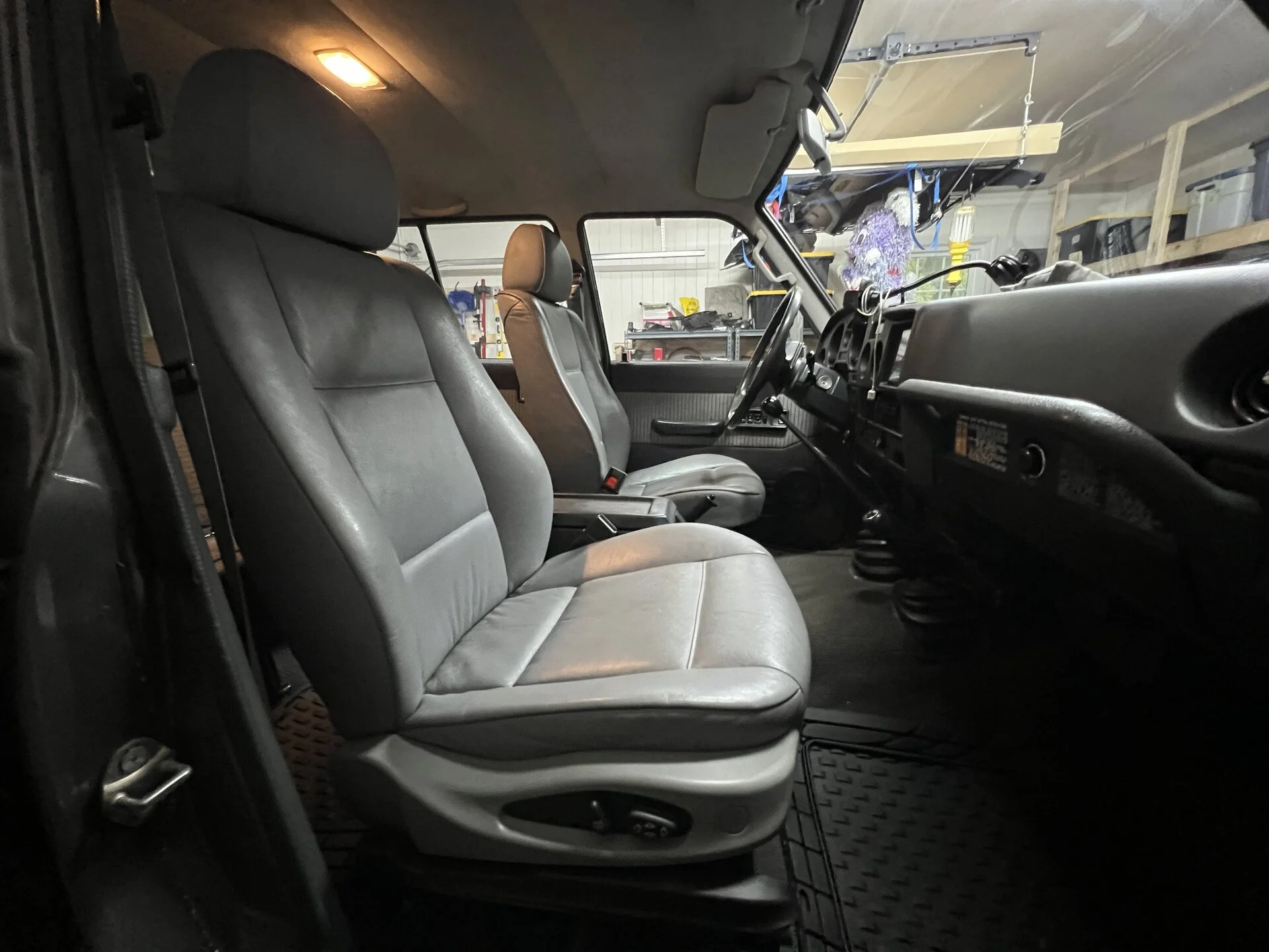

Few more pics…
Man oh man…

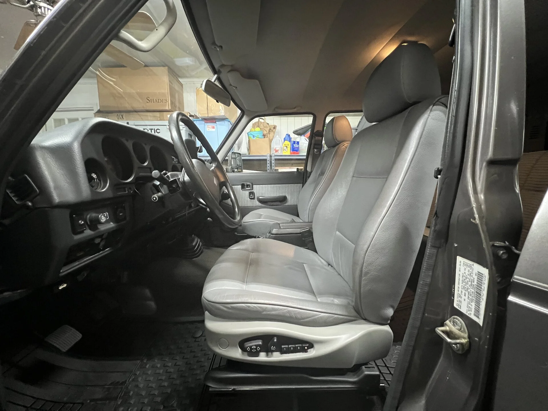

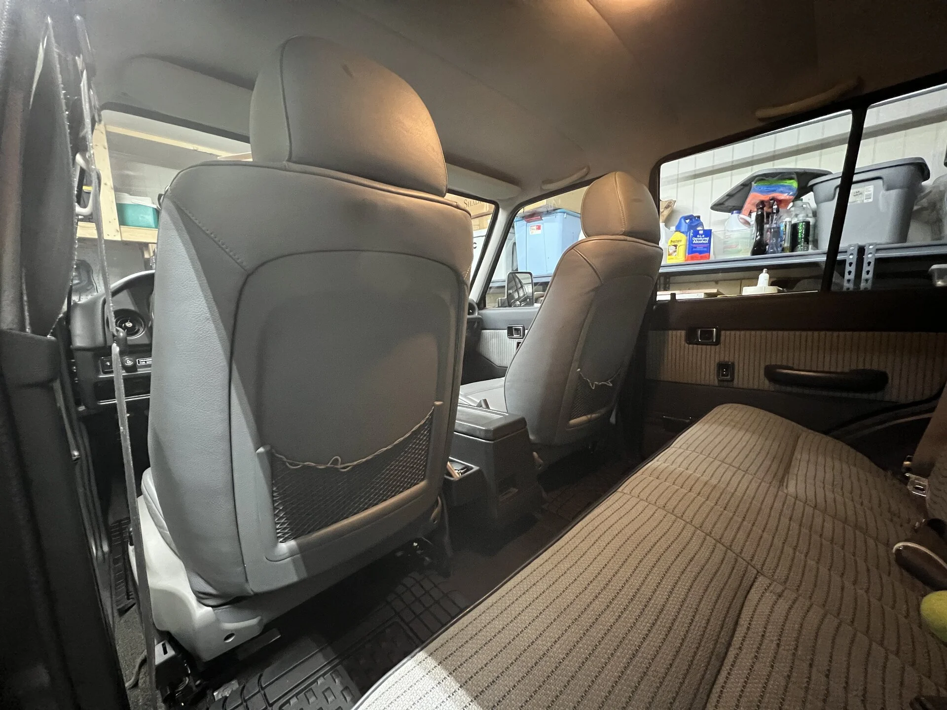

  • BMW E46 motorized/heated seats are IN and all I can say is it was worth the trouble. Love the OEM look but these are just better.
  • @SkeeLo22 hooked all of the plentiful amount of wiring necessary to make the motors and the heat work flawlessly… couldn’t be happier…

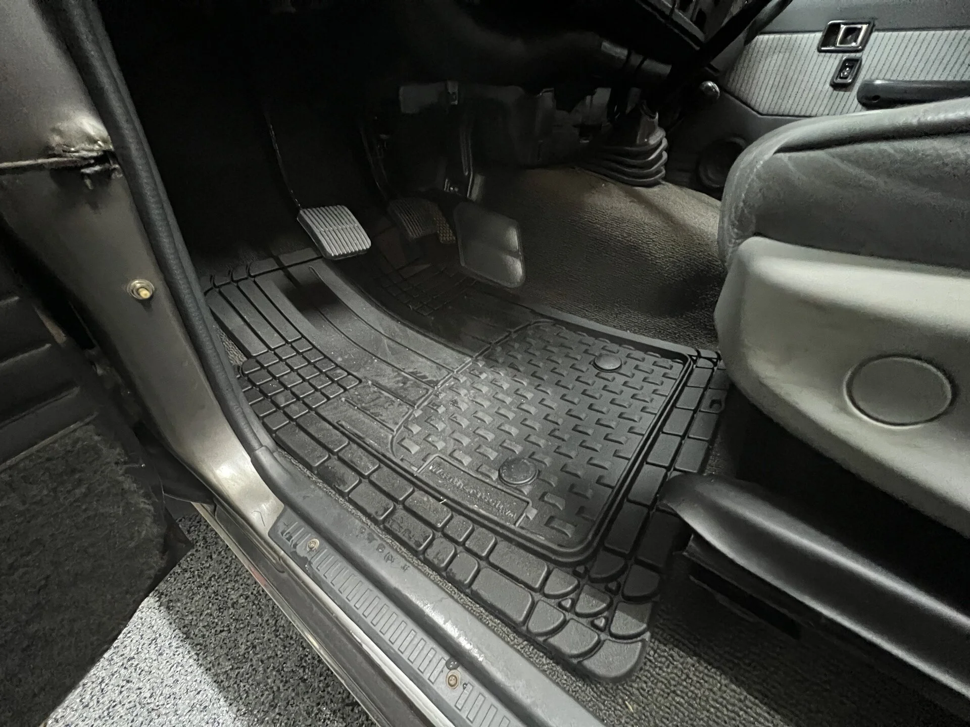

  • Side note, took out the molded rubber mats and replaced with some trim-to-fit weather tech mats from Amazon… like the look better…

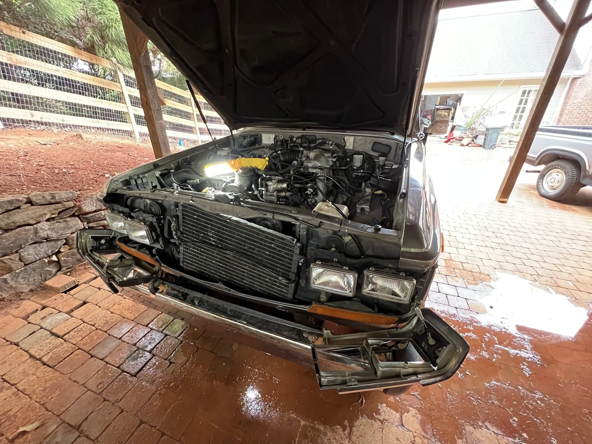

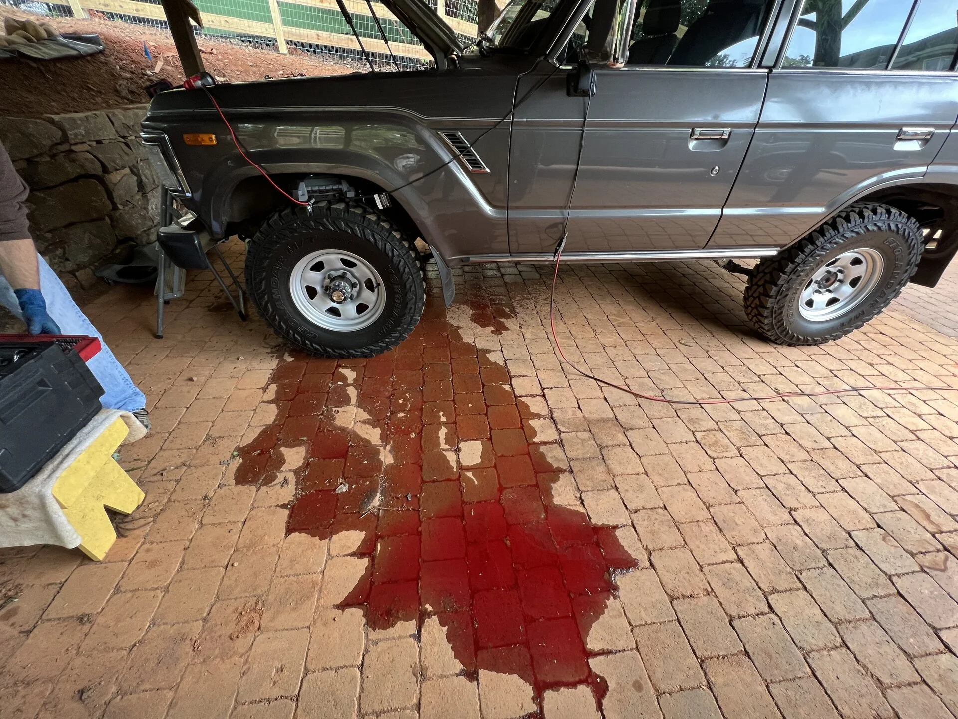

In our seemingly never-ending quest to make my 62 into a reliable daily driver… gotta address a few things…
  • Pool of coolant that graces most every stop I make
  • The battery drain that will leave me stranded 100% - after checking a few items that I think could be causing it, I’ve settled (I’m praying) on it being the alternator…
So I have a few things in order and few things that have arrived
  • Ordered a DENSO FJ62 from @ToyotaMatt that should be here either by end of week or early next week
  • Ordered a CSF radiator (stock one was leaking - we “fixed” with some JB weld but we’re gonna go ahead and make sure it’s not gonna be an issue - that has arrived

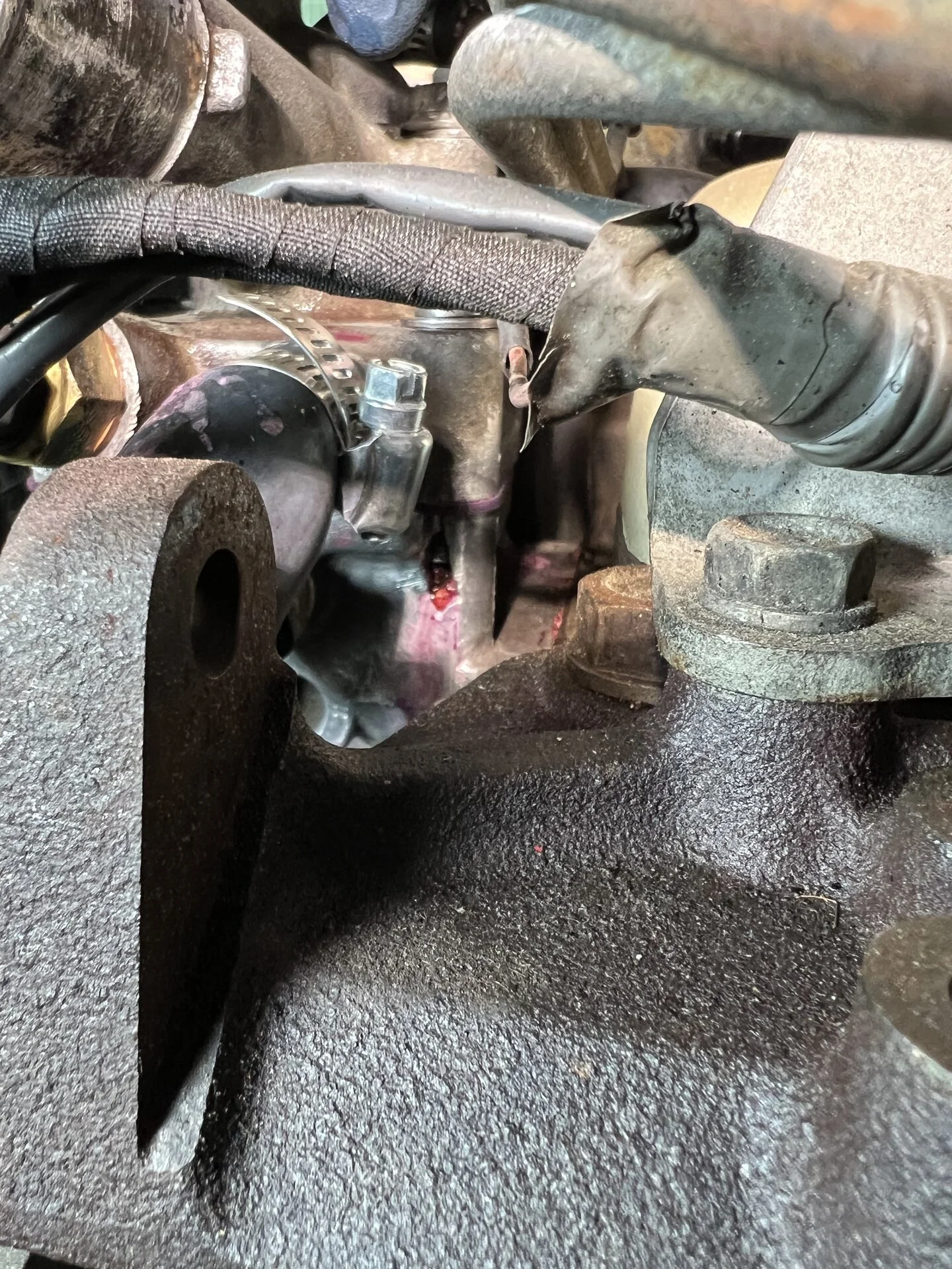

  • Lower thermostat housing has a chunk missing, which may be a culprit - upper and lower thermostat housing ordered from BTB - should be here tomorrow
  • Couple of heater hoses coming off of thermostat housing going to the hard lines on passenger side of block - parts are waiting for me at Toyota

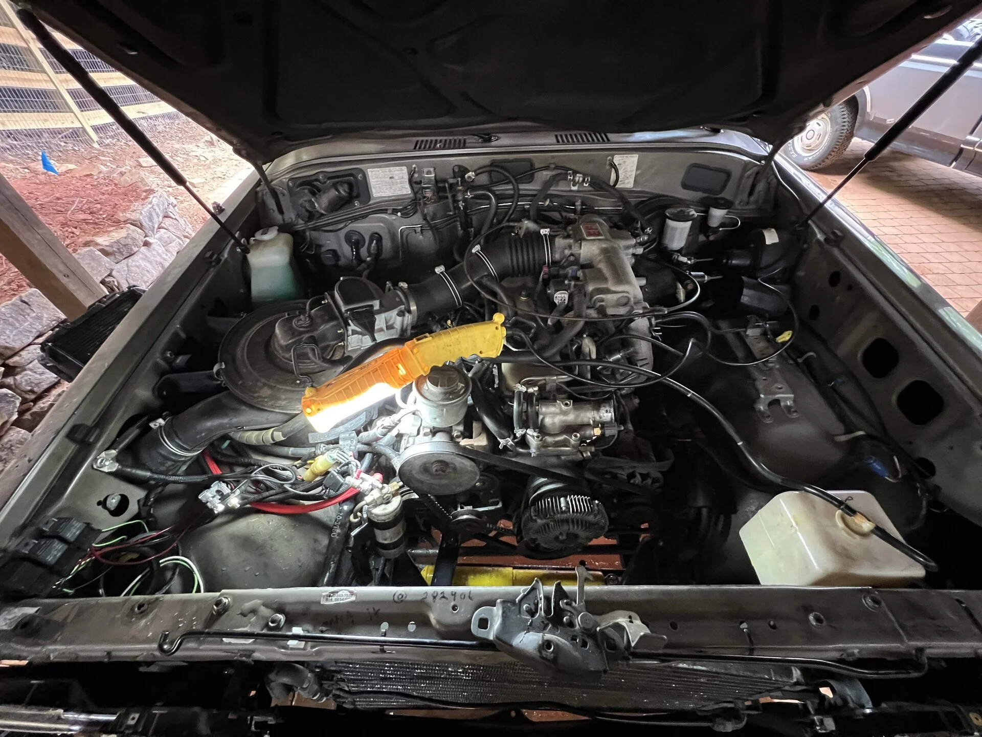

While we’re waiting on parts, today was the tear down day…
  • Removed radiator, fan shroud, plastic fan, grill, and attempted to save the newish coolant in a clean bucket 🤣
  • Found battery acid, probably from battery getting drained and then hot from charging and back again, so cleaned off the battery tray and all of the ancillary parts with baking soda and water…
I’m out of town til Tuesday, where this will all sit and the parts will hopefully be in by then to get it back together and 🙏🏾 at least some of these problems are no longer…
