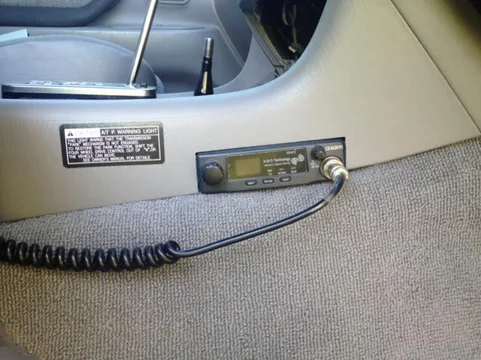

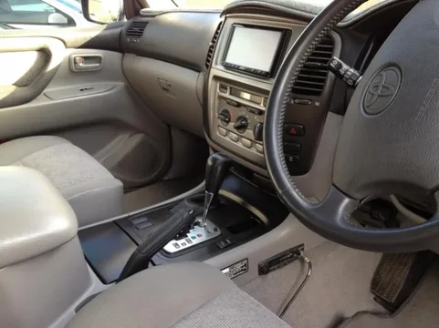

Saw this online
That Kenwood is basically surface mounted... it's a remote face to the HAM radio and only 1.5" thick.
If I was mounting a full size CB transceiver I would look at mounting in the armrest - but that's a lot of real estate.

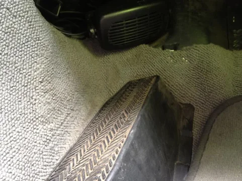

I have a cheap CB mounted on the pass side trans hump. I maybe lost 2" of foward seat travel but it is completely out of the way and is in a spot where I can see the radio and adjust squelch. I have my FT2800 2m mounted in the same spot, just on the driver side. Easy reach and my leg never touches it.

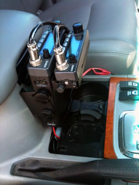

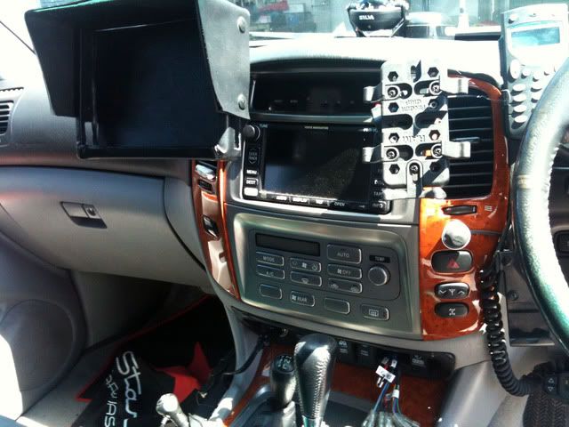

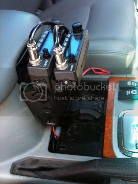

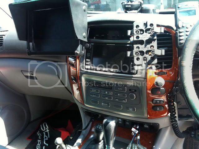

I have three radios installed. One HF (antenna at rear), one UHF CB/scanner, and one combo UHF/AM CB/scanner. One CB radio can be scanning, while the other remains listening to the desired channel. Alternatively, both radios could be scanning either both on UHF or one UHF and the other on AM. Both CBs are mounted vertically on the front of the centre console (fridge) box (above the drink holders). This makes them both easily accessible, without looking away from the road, and with my arm resting naturally on the centre console, I can control the volume, switches, etc. The HF radio handset is mounted next to the steering wheel, with the radio itself installed in the void between the inner and outer walls of the rear of the centre console and the other third of the radio mounted in the cargo area. The Satphone is mounted below the HF radio and I have a RAM mount for my cell phone next to it. The other (big) thing is a holder for a tablet PC that I made, again, attached to a RAM mount. :geek:
[URL="http://i188.photobucket.com/albums/z232/gesteer/IMG_0776.jpg"][/URL]
Note that the red wires near the top are nothing to do with the radios. The radio wiring goes straight into the centre console, behind the cup holders.

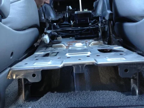

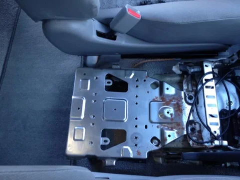

Thanks everyone for your photos and suggestions I've decided on its final location
All I need to do now is to make a bracket to hold it in place
Mounted with bracket

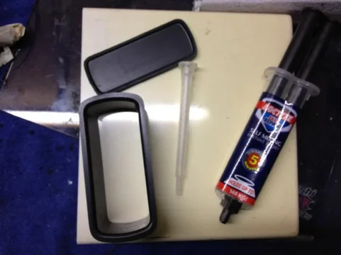

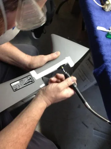

Moding the pocket
Putting my dremel to good use
I had to cut the bottom of my pocket off but no major drama and re glued it
Nice finish can't tell it's been modded

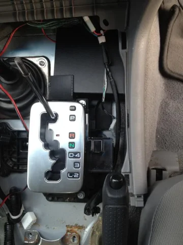

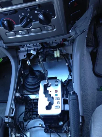

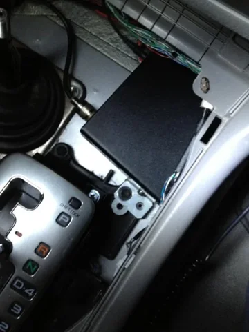

Under the Center Console
Not a CB, but a dual-band ham radio (Icom 2720). If you remove the shifter and switch cover from the center console, you will see some empty space to the left and forward of the shifter (right under the speaker in the picture)of the shifter. It was just enough to slide my radio into. In fact, it's pretty snug - didn't even have to bolt it down. The radio still gets enough air to stay cool under the conditions I use it.
I ran the microphone cord up through the little trim piece (see picture) with a rubber grommet and mounted a speaker in front of the shifter. This only works if you have a removable control head on your radio. The curled cord you see draped over the am/fm radio, etc. is for my cell phone.
