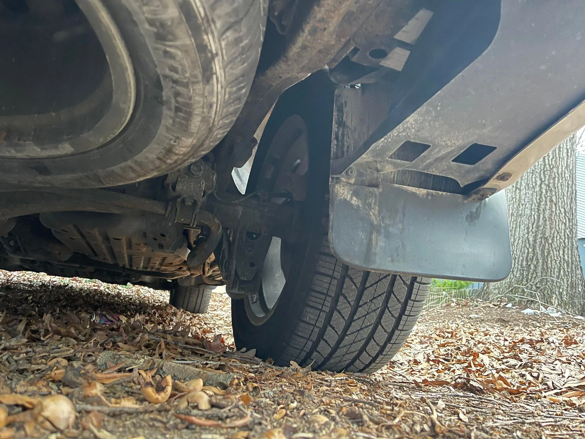

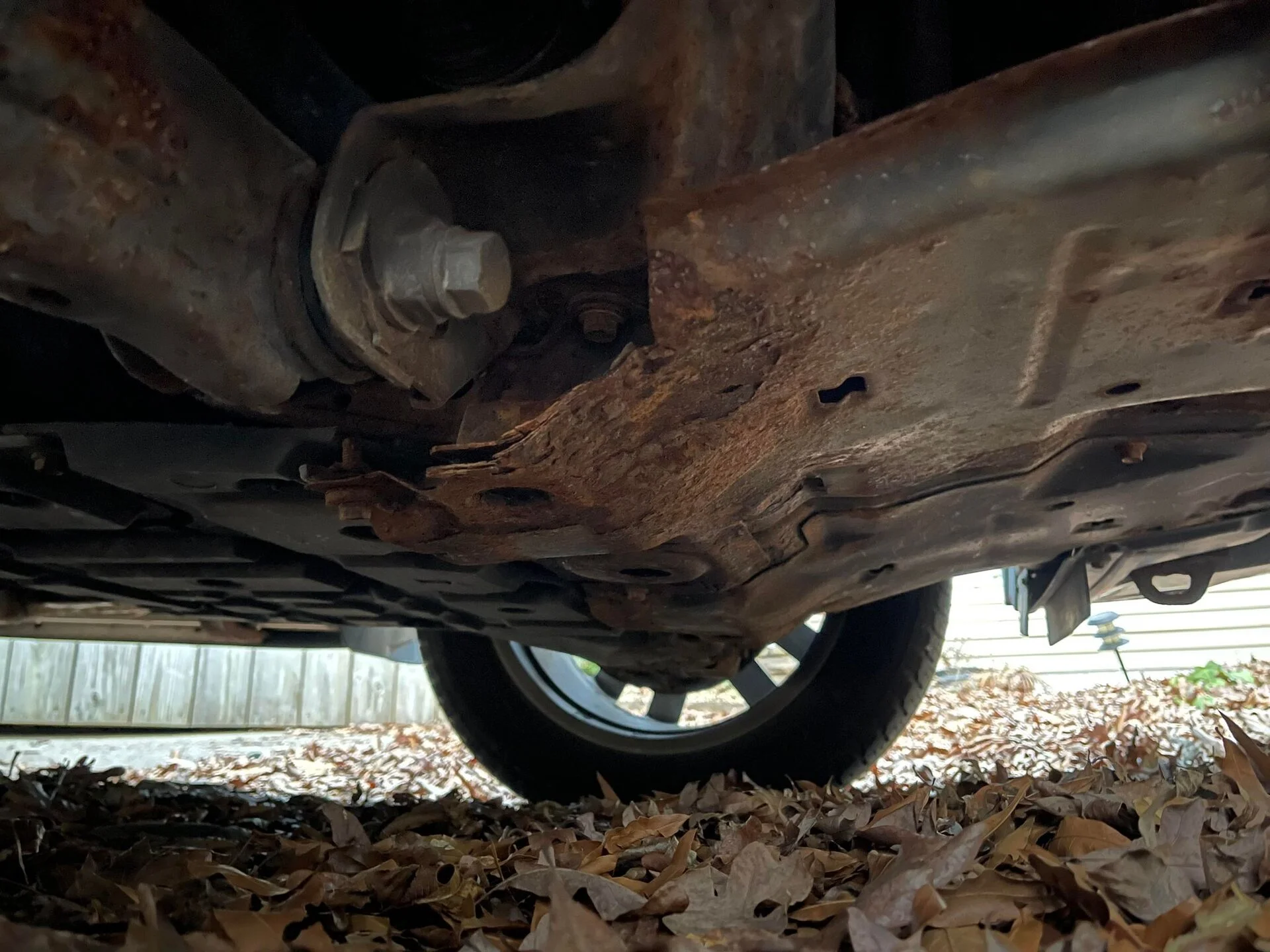

To me it looks like skid plates and exhaust system. Skids are about $1500 for a nice set, and exhaust I think around $1000 for after market. The rest you can touch up, wire brush and por-15.

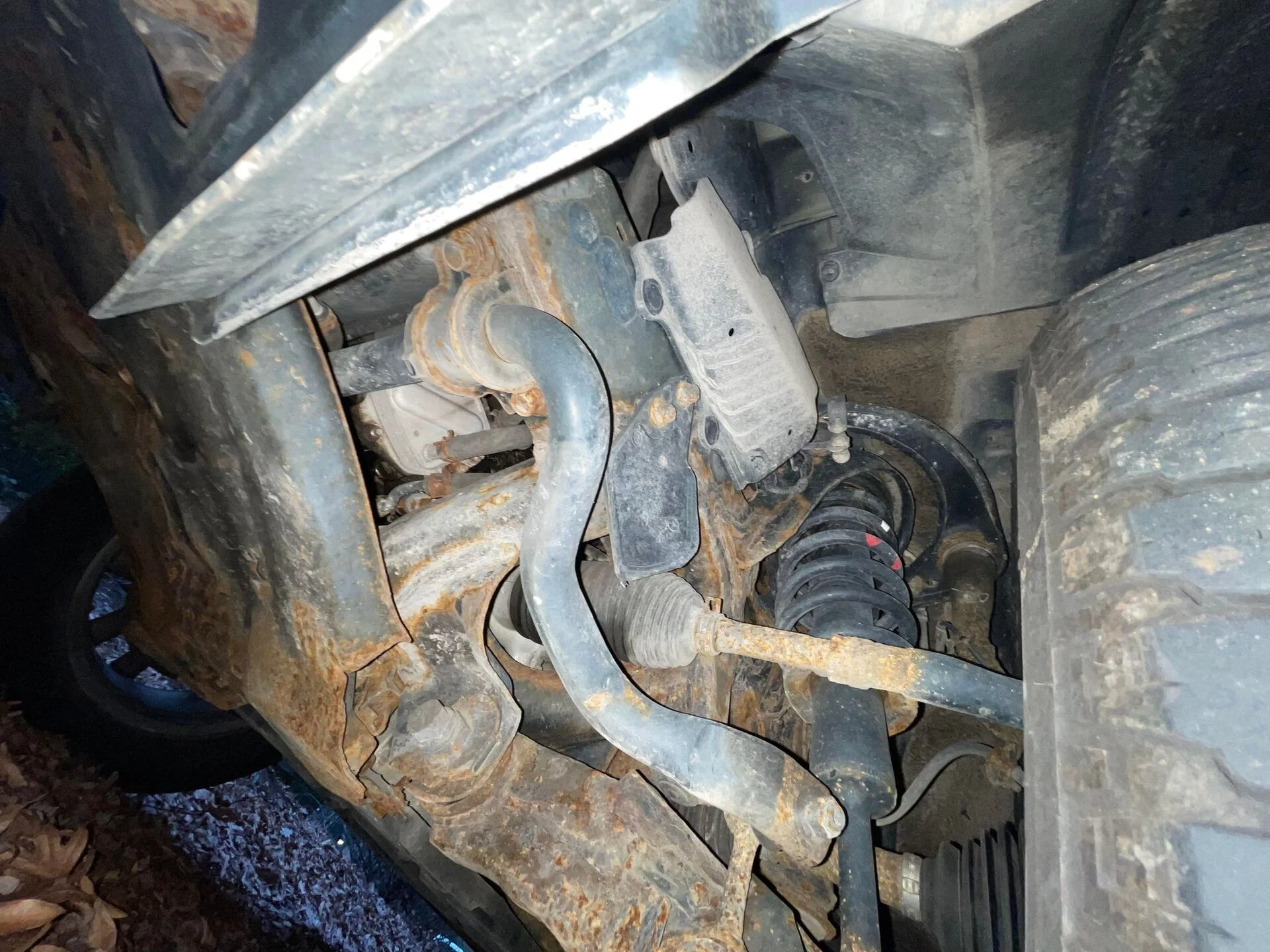

Likely want a pic of the rotors by the anti lock sensor.

That doesn’t look very rusty or very serious given the age. But it is just a couple of photos. What does the rear cross member look like? The factory skids are about $400 and are known to rust away. Easy fix. I like the bullet story.
I would pass on this given the rust pics. The LX AHC components are starting to rot and that is a PRICEY fix. When that starts going south, good luck getting a mechanic to work on it. AHC is hard enough to fix without it being rusty.

Those tie rods, LCA bolts, etc seem pretty rusty to me. If you need to do an alignment where anything is out of spec you may end up cutting out the LCA cams and replacing the LCAs, tie rods, etc. If you're keeping your truck stock you'll probably be OK for a while (until the bushings or joints start to go bad in which case you have to replace them anyway).

That's great insight- thanks. It currently has about 125k- it'd be driven about 10k/year and we plan to hold it for >5 years.
Came here to mention the seized cam adjusters and LCA replacement. Our linux deity beat me to it.
