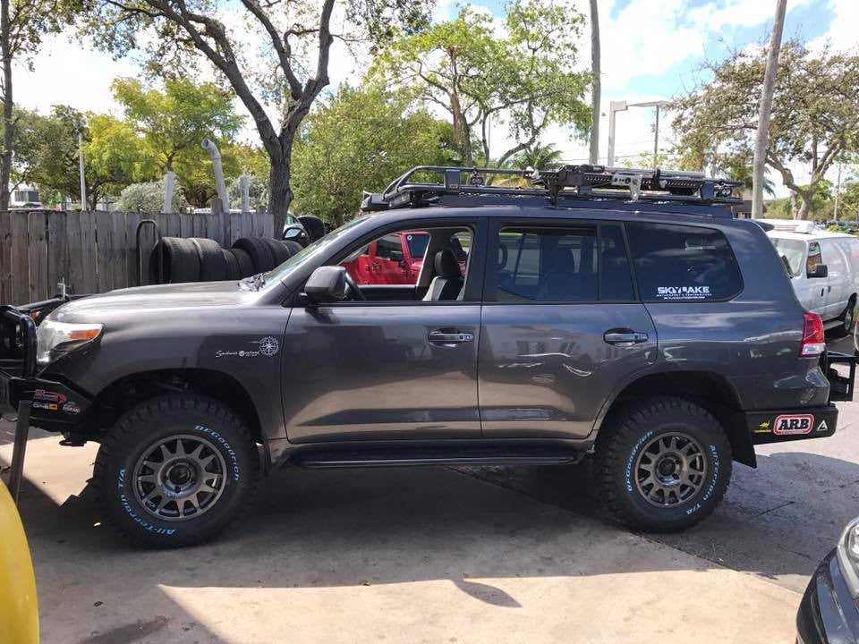

I'm partial to these for 17", yes they fit LC200. Many tire size choices but popular ones are 285/70/17, 285/75/17, 295/70/17, 34x10.5/17, 35x12.5/17
EVO CORSE DAKARZERO 17"x8" TOYOTA TUNDRA, LAND CRUISER 200 Series ET: 40
I love the looks and light weight, and I was going to buy those until I found out how horribly limited the supply is. “We are taking orders for a September shipment” I was told in July..... I decided to go with reman 18 inch factory 2013 LC 200 wheels due to VERY low cost and the ability to find a replacement for a damaged one on very short notice. I bought four beautifully refinished wheels for $700 shipped, with _lifetime_ cosmetic and structural warranty.
I decided not to go with 17 inch Rock Warriors due to high cost, and corrosion issues betweent the trim ring and wheel. Plus the rings are gravel/ mud catchers.... who the heck wants to deal with that? Unless you stay on pavement.... I think seperate rings are pure stupid for most applications.
