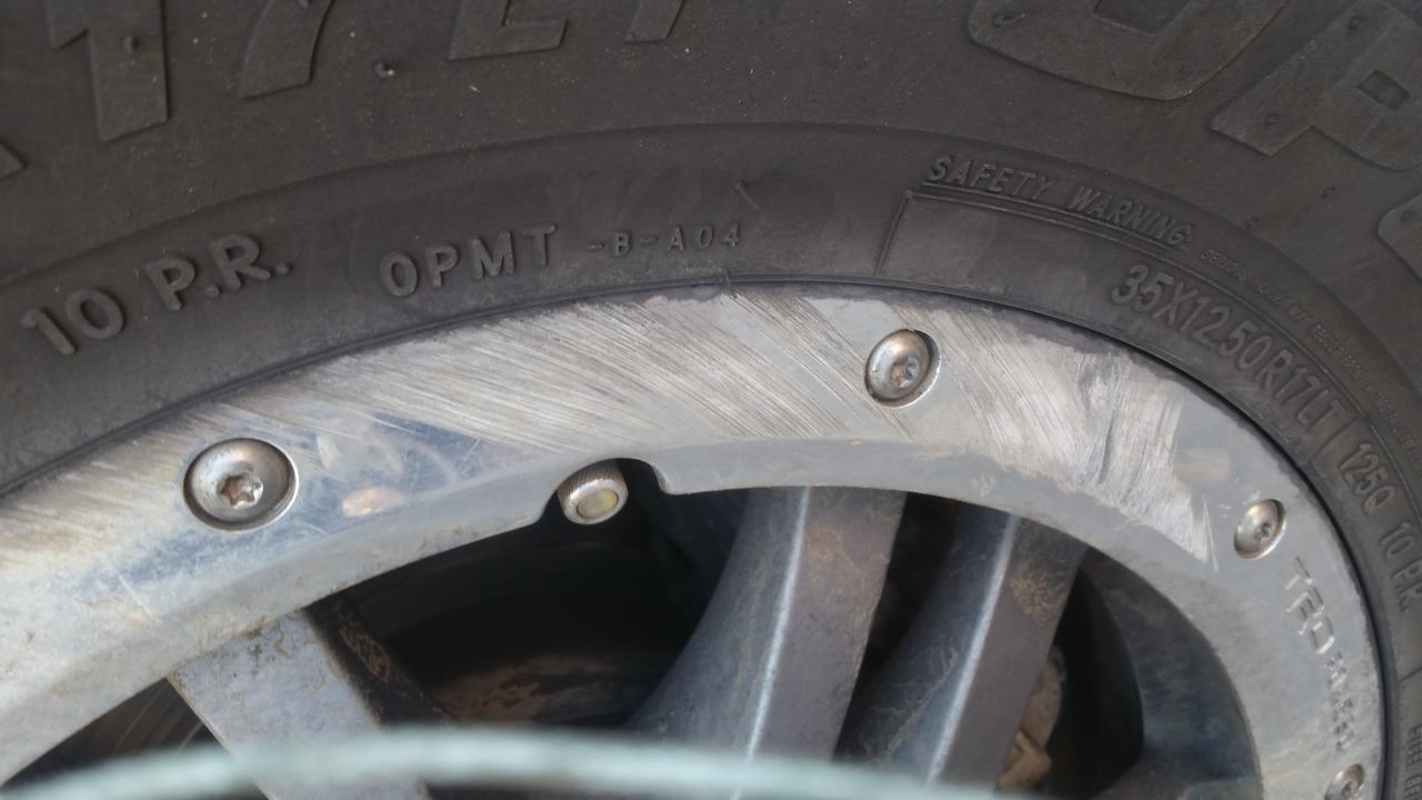

The rock warriors rings save valve stems.
Yep. Pretty sure my rings saved at least one stem last year as a massive rock gouge hit right where the stem was (but safely behind the ring). Worth leaving on.

The ring saved this valve stem. I have two other wheels like this.
FWIW on the RWs this seems to be a big deal, since the valve stem would poke out a bit without them. On my Icons which have 1" less offset, I noticed the valve stem sits inward. The Icons also have a fake beadlock ring that's part of the wheel, so there's some extra protection, though I don't think it would be necessary in most cases.
@John E Davies FWIW The RW ring serves a purpose, valve stem protector and wheel rash guard. The rings are replaceable for this reason and easy to source online. Cleaning out the junk just part of a good trip. No different than a front or rear bumper. I've never had gravel get caught up in that space so I'd say that's a wild speculation, No harm I can see the logic.
