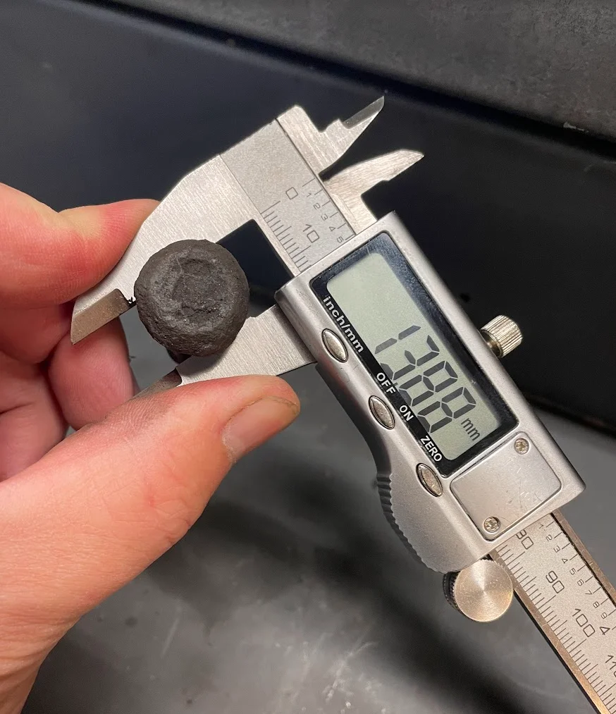

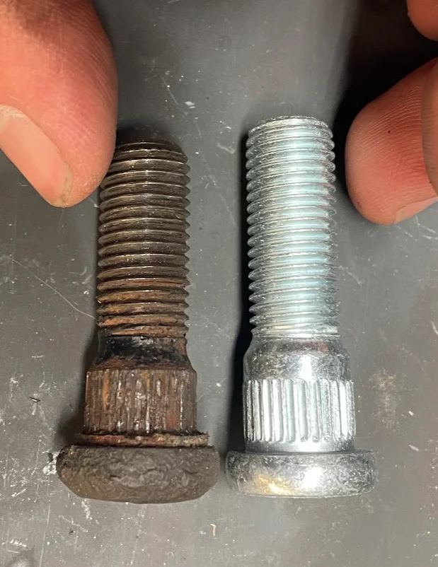

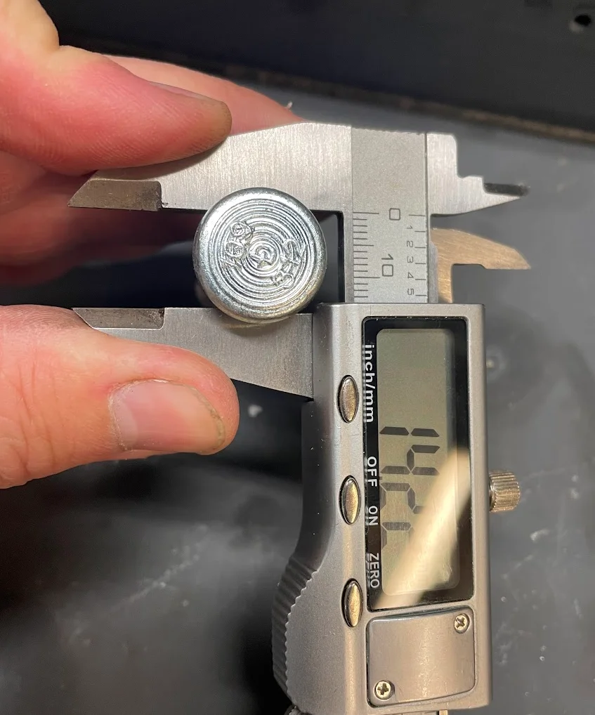

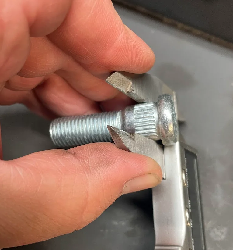

I did a search on Mud and found a part number for wheel studs from NAPA, 641-1628. Everything I can find for a 1976 FJ40 says I should have a 14.22mm knurl. When I pulled mine, I measure 13.88 on the old one, and 14.22 on the new one. Does anyone know what I should be using? As far as I know, everything is stock. This is on my rear axle. I haven't tried digging into the front axle. Are they the same?
I am trying to get longer studs so I can use after market wheels. Currently, I only get about 8mm thread engagement on the original studs.

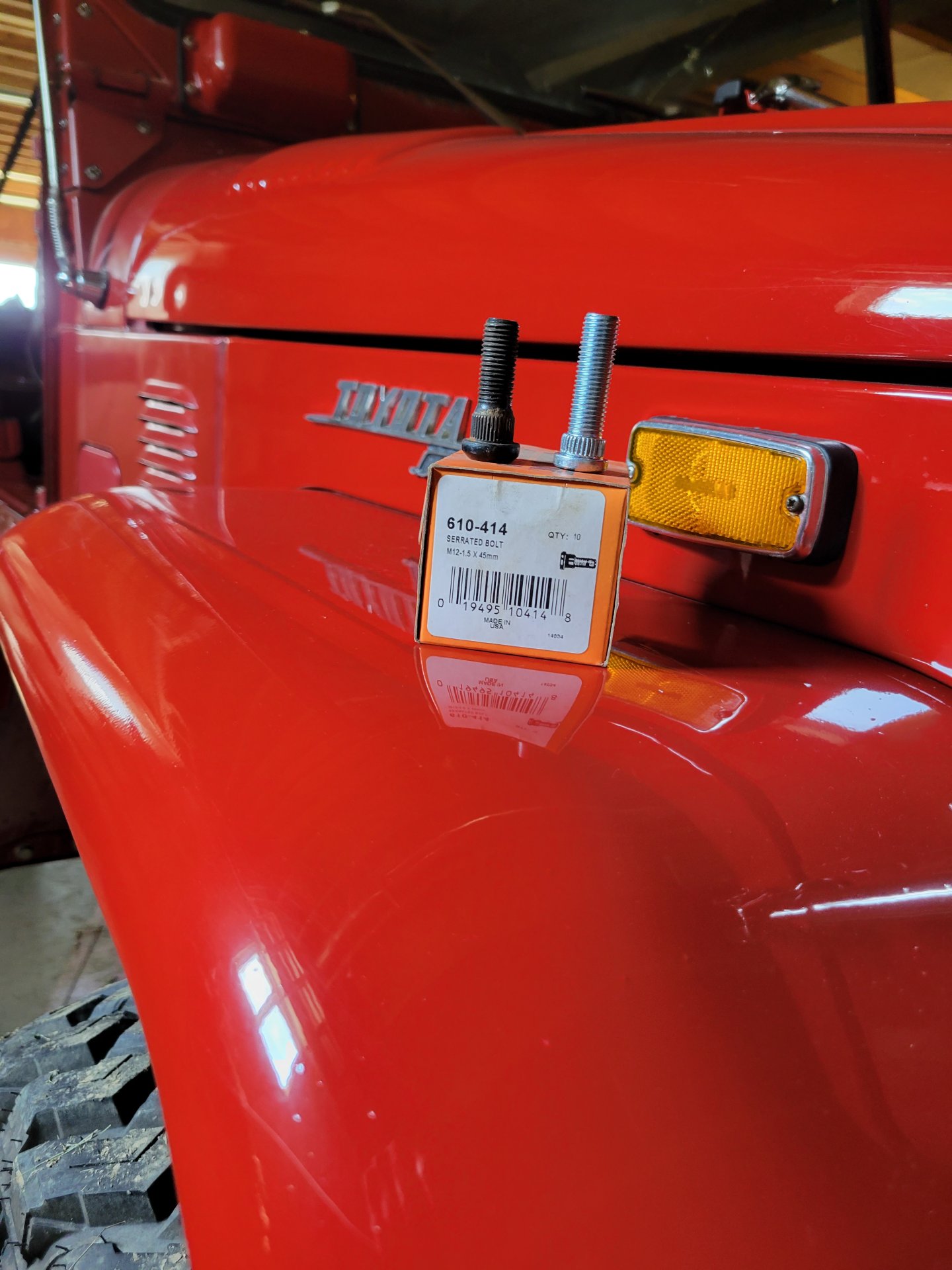

This is what I used. 75 FJ40, the frt end had been swapped to disc. IDK, know if it makes a difference, the rotors were the bolt on type. I'm pretty sure I used these all the way around. The short stud is stk.
@pb4ugo I looked up those parts and the knurl diameter is 14.38mm. the one that I removed measures 13.88. Did you have any trouble getting them in?
I just pulled them in with a lug nut and an impact gun. I think I used a 1/2" washer against the axle flange. 1/2 a mm or .0197" difference.
