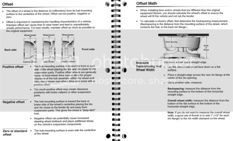

The "Backspace" we are talking about is a term used to measure a certain section of the actual wheel. You are talking about spacers you add on to push the wheel out further when clearance or a different stance is desired.
I called them backspacers because I don't know what they are officially called.
Anyways, here is a scan from one of my books at work that might help others.
Thank you for clearing it up. I didn't mean to cause confusion.
