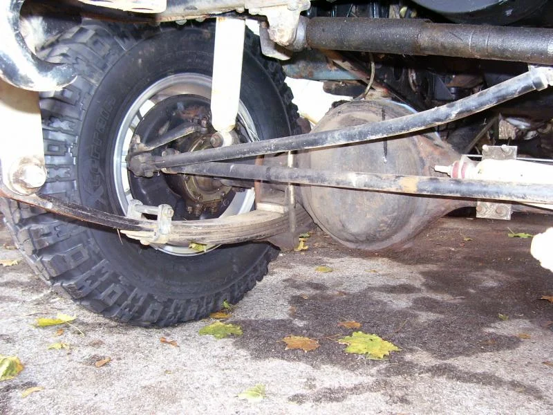

i bought MT classics for my Fj-40 and the backspacing was 3.5 or 3.75" I choose to run 16" wheels so there was no chance of tierod or caliper interference. They fit beautifully and I'm very happy with them. My only regret was not running larger tires! I believe they are 285 r16's I wish I would have ordered 35ish size tires for a rubber overdrive and better offroading.
please don't comment on the steering stuff, this was how I got it, it's been long since replaced. Oh dear god was it scary first drive. worst scariest ride I've ever had in my life. that includes having a lockup on my old RD350!
The one pic should show the backspacing and tierod clearance. Not a good pic but these wheels do fit well.
If I were to do it over again I would have ordered steel 16" wheel with 35's but I still really like this combo

I'm pretty sure I ordered these with a 3.75" back spacing, they are of course 16" I believe they are 10" wide. sorry I don't have any pics handy now. I would recommend using steel wheels if you wan't to wheel that thing hard. these wheels do look very nice IMO but won't hold up to rock rash as well as a steelie. I needed a little bling in my life at the time! I even fagged out and bought my spare on the same wheel! I don't care for beadlock look wheels. I would rather have the real thing.
Keep in mind too that the truck has about 6-8" of lift in that picture, the tires are I believe a 285 60 16 I can't recall but about 32.5" tall. I had to pull those damn lift shackles off as the thing handled worse the a horse cart with a broken down mule.
