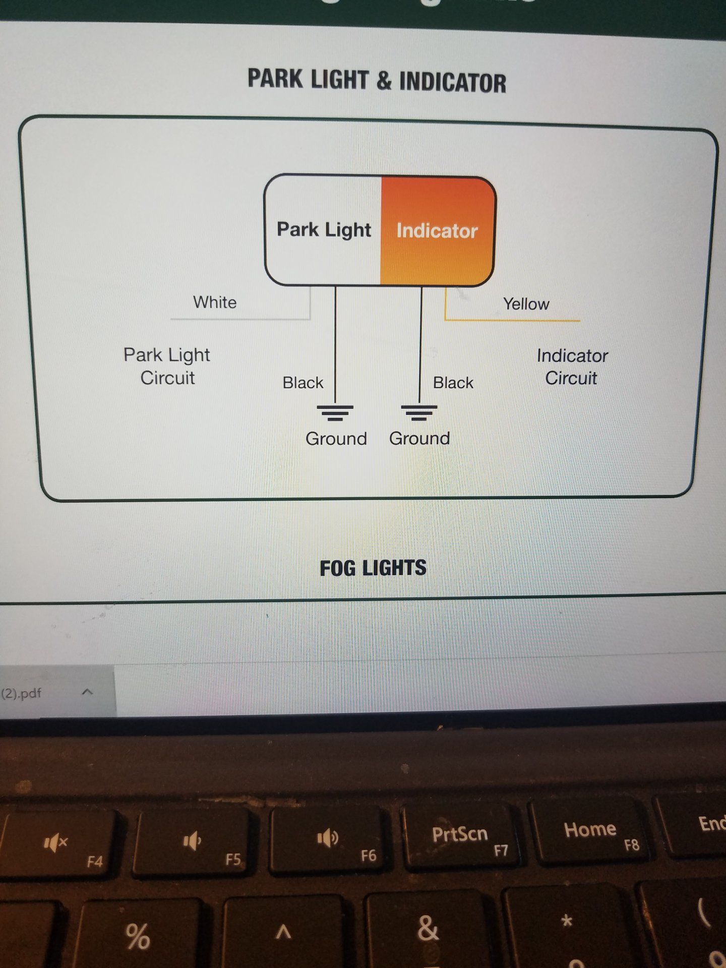

Ok the first pic is the wiring diagram from IM.

Thank you! I will play with it this afternoon. So helpful to actually see which of the wires to tap into. Ironman FAIL big time on this. They did respond to my ticket ... with the most hilarious response. They just sent me a picture of the page in the "instructions" with the useless wiring diagram. I LOL'd on that one. Still really like the bumper. Yet still wish to perform a root canal on the instruction writer based on his / her expert instruction. :-)
