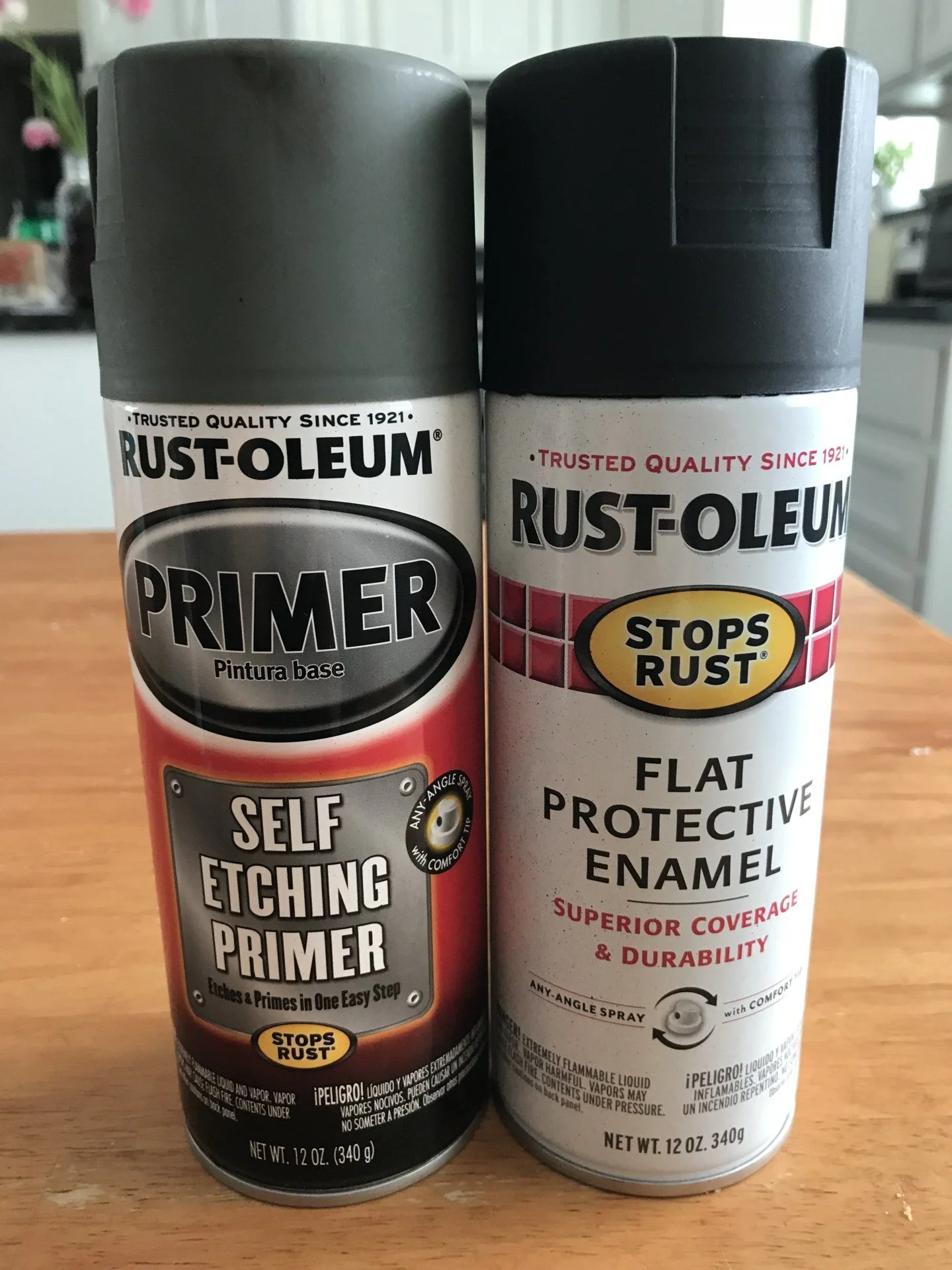

What’s your favorite spray paint for the drivetrain and chassis? I am not looking for showroom pretty, just a solid color and a rust barrier.

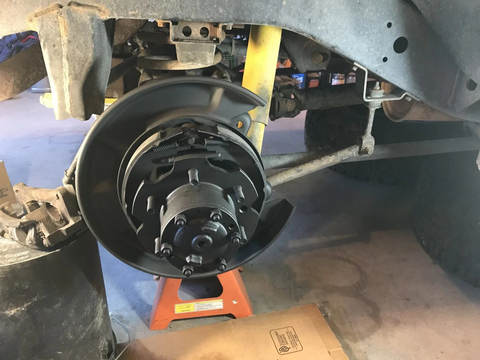

I used Rustoleum self etching primer and enamel on my rear hubs. I am hoping it will hold up.

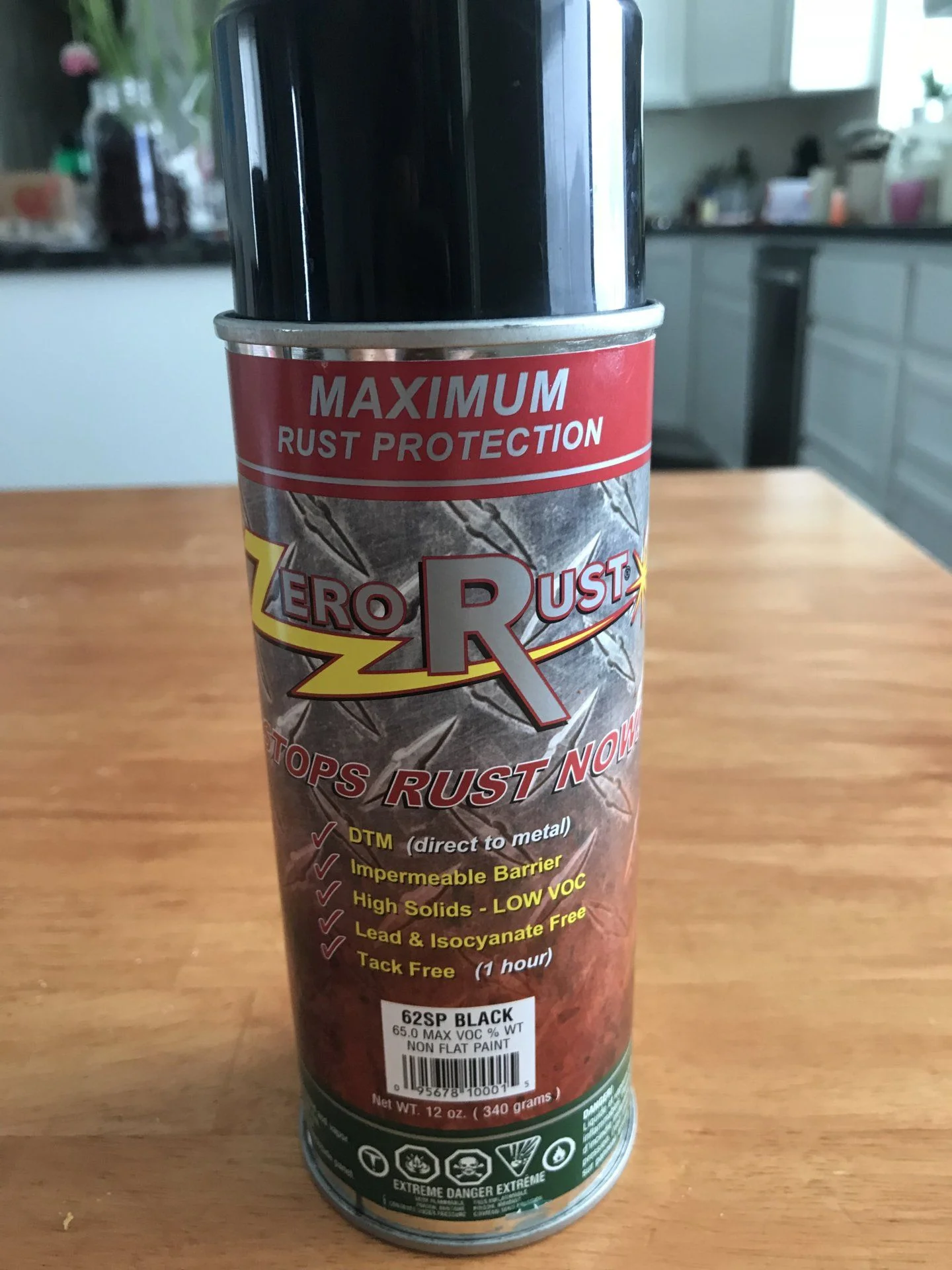

I saw this in the hardware store and thought I would try it on the front axle. It’s expensive at $14 per can, but it claims is direct to metal and salt spray tested. I thought it was worth a try if I can prime and topcoat in same operation instead of two separate ones. The Rustolem above is $4-7 per can.
We’ll see how it holds up on the front hubs compared to the Rustoleum duo on the rear hubs.
Has anyone already used this? What did you think?

Here is something I found interesting:
Zero Rust is nothing more than a Rustoleum-type paint
Wow, thanks!
Guess I’ll be returning it!

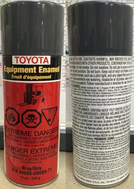

We get our cans from Toyota Lift of South Texas. I have no idea what the price is though since our maintenance guys buy it but it is a nice quality paint that I would use on my wheels if I need to paint them.
