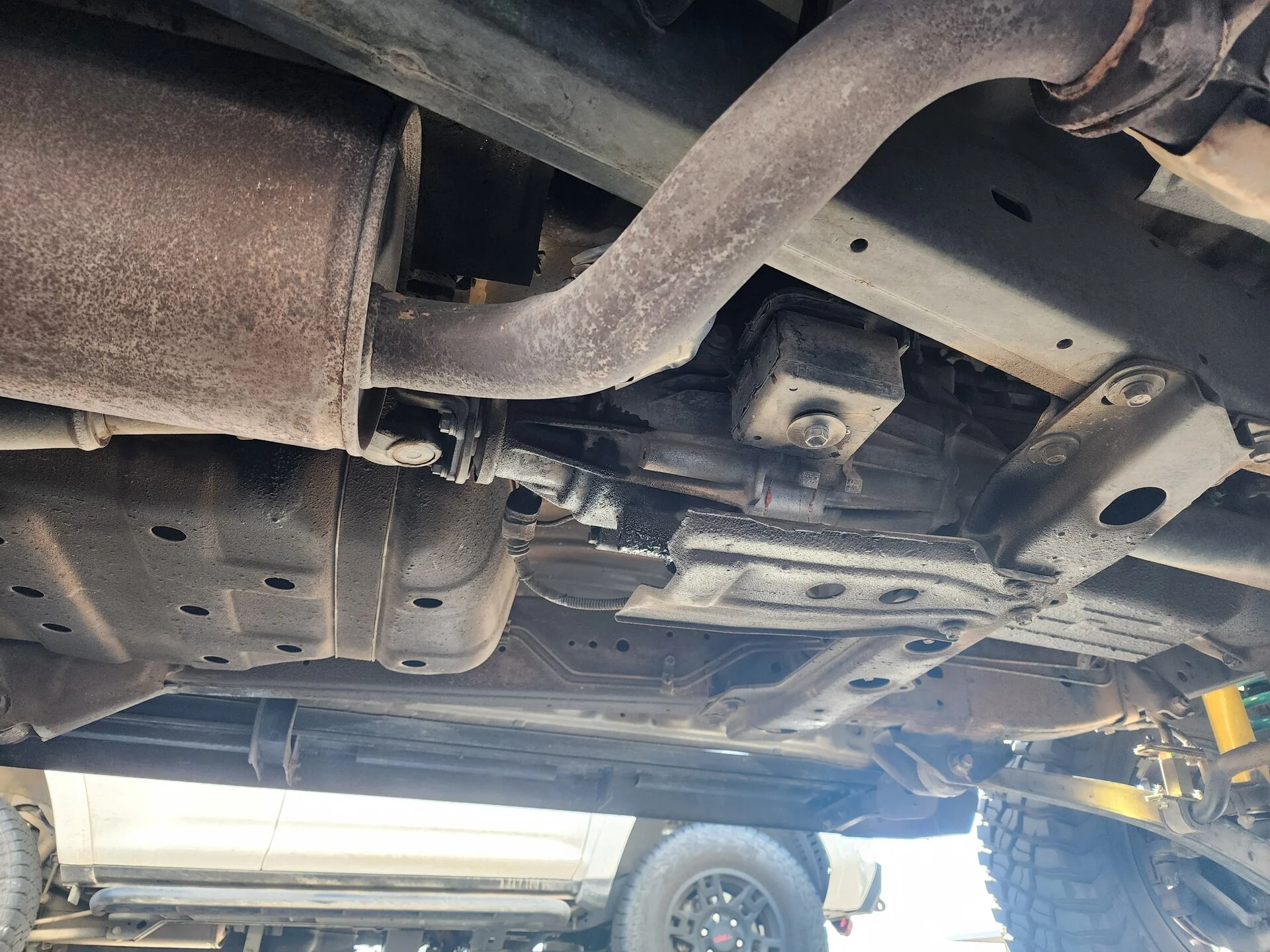

whats this seep/leak? 97 lx450
Sep 4, 2023
43
155
Henderson, NV

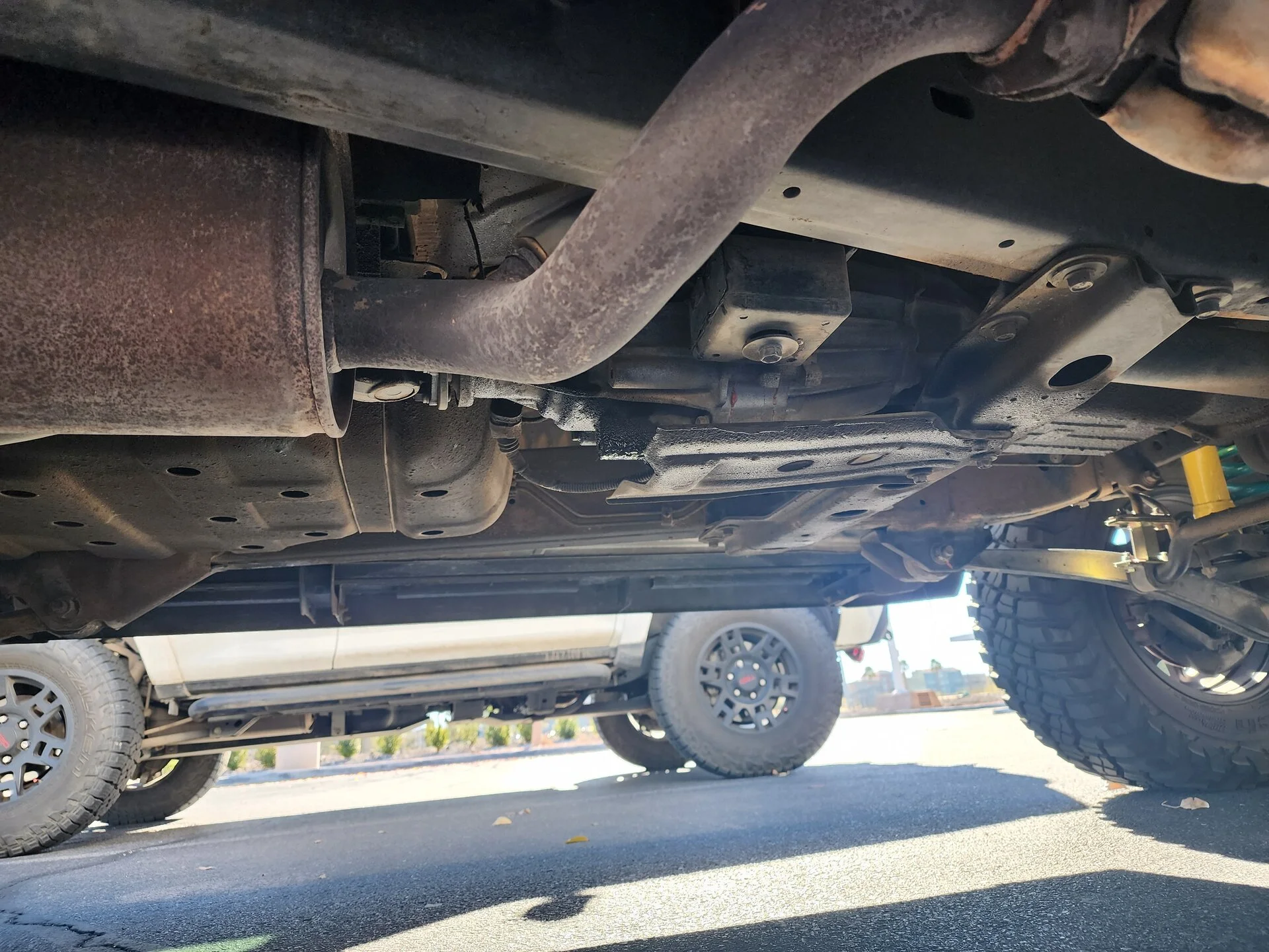

any idea what's going on here? how urgent? how much to fix?
Blown head gasket, I'll give you $5000 for it.
maybe get another photo from the other side or closer. Clean the whole area as it collecting from the transmission back. You could have multiple minor leaks.
Pro-Tip: lube the o-ring excessively before trying to jam it in there. It's going to be a tight fit, which is what ensures a good seal and no leaking. It's a 10-minute job, but since this is your first time doing it, give yourself an hour,... or two... maybe.
Speedo @ T-Case - O-ring and seal
1 - 96711-24030 - O-Ring
1 - 90310-09001 - shaft seal
