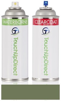

UCAA3 comes up as either grey metallic or green-grey metallic. So I found a sample called just "UCAA3 grey metallic" and I came up with this:
My bumpers are pretty faded and worn but I don't think they ever looked like that.
I took off the ducts in the front bumper cutouts and underneath the edges was some nice clean original paint. It's actually a very nice medium/dark grey with a lot of metal flake in it. Perhaps I can get an auto body shop to scan it with their color match gear and get the exact formula to take to an auto-body paint supplier. That's a real PITA though compared to just ordering a couple cans online and shooting it.
Sorry,
Haven't been active on the forum in a while. My rigs are Emerald Green but I didn't think that the bumper paint was even close to that color green. I recall they had a grey green cast to them but thought the green cast came from proximity to the rest of the rig. Perhaps not.
I'd have to go with your color match idea unless you get a better paint code.
