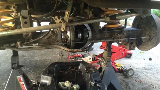

After my fiasco on Blanca with no rear locker, I cut the grass in the morning and took to getting those o rings replaced. Took about 5 hours with lots of breaks since its hot and humid today. LOTS of gear oil in the line. It's back together and working.
Rear diff cover isn't lookin so hot though. Even with a new gasket, it leaks quite a lot, so I'll have to pull it again and see if I can get a grinder on it to deburr and straighten it out. image.webp
