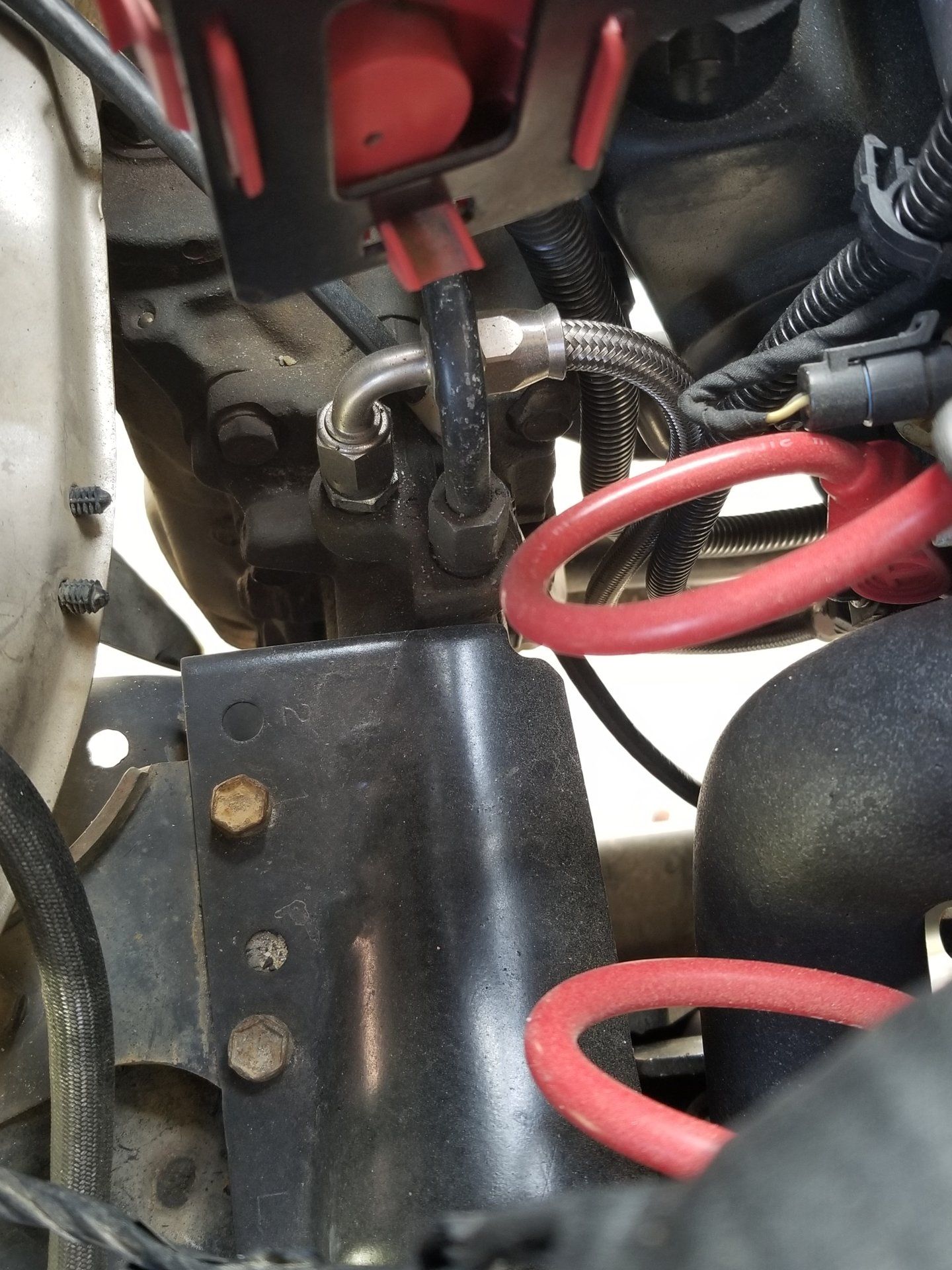

That is likely on the low pressure side tho - you ran AN-6 on the high pressure side too?inverted flares. I ditched my factory paper clip and just ran AN -6 fittings and braided lines with an aftermarket PS cooler
I ran a high pressure PS line with HP alum. AN fittingsThat is likely on the low pressure side tho - you ran AN-6 on the high pressure side too?
Awesome - @Tools R Us @richardlillard1I ran a high pressure PS line with HP alum. AN fittings
