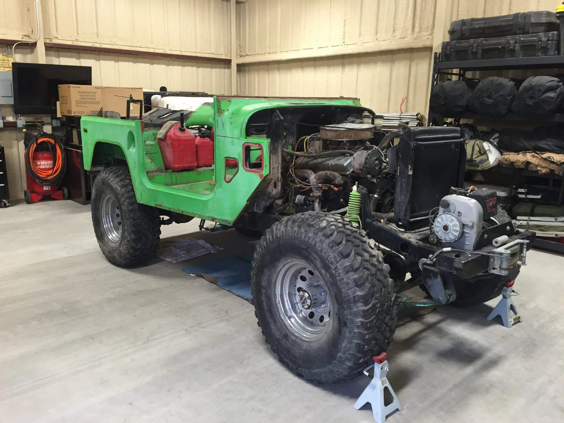

I recently purchased a 1970 FJ40 that had a 350 conversion and have since sold the engine and tranny with the intent to replace it with a 5.3 fuel injected engine and a 4L60E transmission.
I now have a donor truck (1999 Silverado 4x4 with auto tranny that was rolled in an accident) that came in at the right price (free). The engine and tranny seemed to have survived the accident unscathed.
I've always done most of my own car repairs but this is the first time I'll be sticking an engine in from another make of vehicle. Aside from the transmission/engine what else should I harvest from the truck to make this install easier? Wiring harness, ignition, etc....

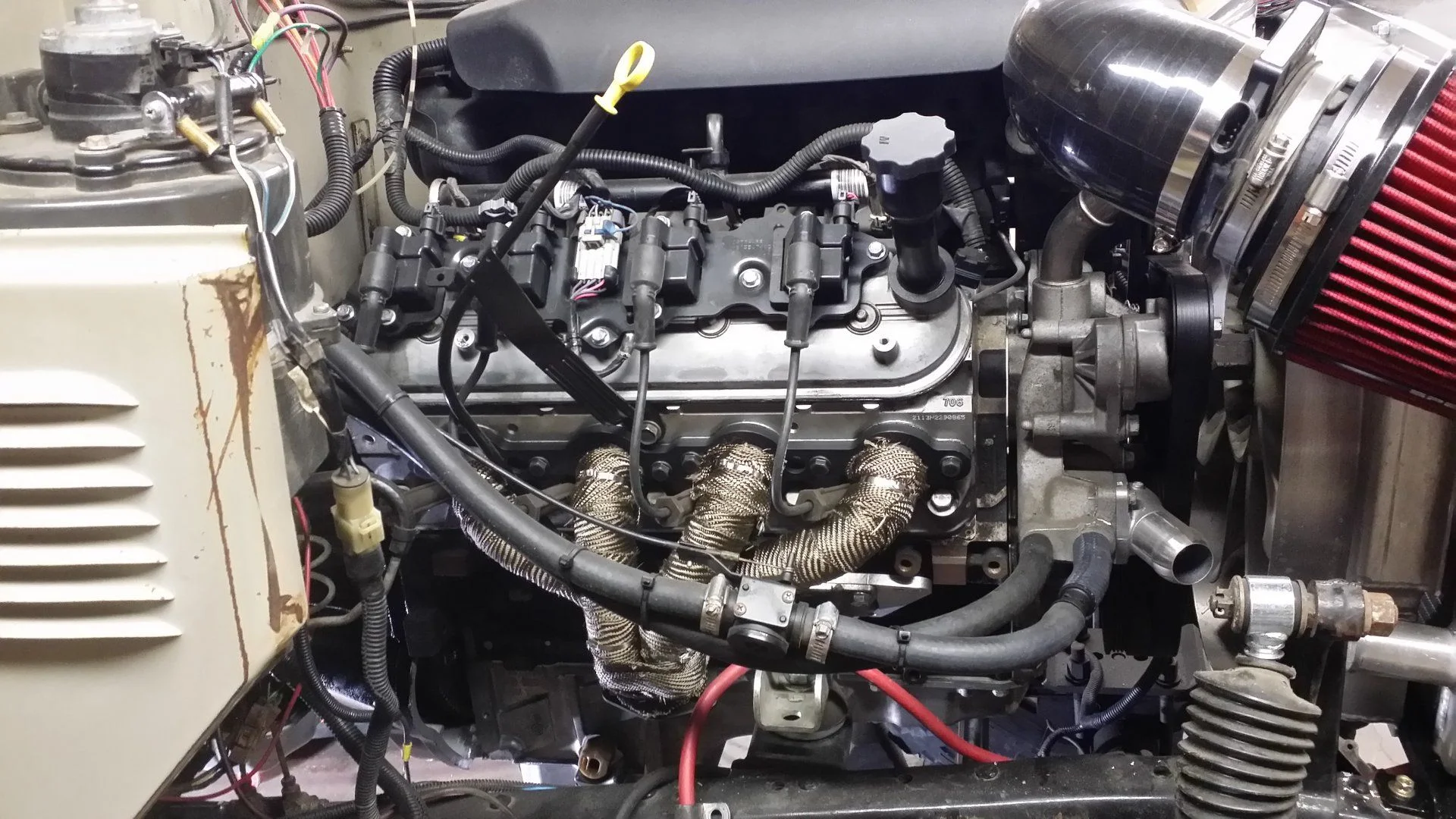

Excellent choice. Like others have said, keep everything until you're done. The stock truck manifolds (or replacement headers) won't work. You'll need LS-series OEM Corvette exhaust manifolds or block hugger headers. The LM7 truck oil pan is way too deep for wheelin' and needs to be replaced with the Camaro/Firebird pan, or modified (see pic).
LSX Innovations makes an adapter to allow you to use your early SBC mounts to the LS mounts making it a pretty easy installation.
This pic shows how tight things are. You can just see the LSX adapter plate under the #2 header tube. If your current SBC has the AA engine mounts then the cost of the LSX plates, at about $30, is cheap.
Starter is not installed above.
