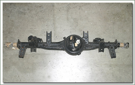

Is your axle housing in good shape? Maybe you can remove the ff kit and go back to stock. As I recall, it was a bolt on affair.
Thanks for this pjohnson. I do have a couple of questions with this diagram. And please disregard my non mechanical lack of expertise.
Of course I will need all the seals and bearings and a few of the retaining nuts to replace, I get that. Is there a difference between the spindles from stock to the Warn ff spindle? I sent an email to Warn just in the off chance that they might have one floating(ha) around in their boneyards. I really don't have the fab skills to cut one down and weld up holes and redrill. Wouldn't I need to do both sides? And yes...#19 is my golden ticket.. Thanks for helping
More info though. I had forgotten ... Years ago I had, while on a TSLC run thru the Rubicon I grenaded a rear locking hub and luckily someone had a replacement so I could get out. Shortly after I replaced both with drive flanges. Can I just use a stock rear spindle with my drive flanges and call it a day? Or are the axles modified to fit the 6 hole Warn ff spindle? Could it be that simple and can the disc break be bolted up? Or are there set back and different tolerances for the calipers?
FJ40 reared in North America were all semi-floating design (Australia, some other areas got a full-floating rear axle.)
Semi-floating rear axle doesn't't have a spindle like this; the axle shafts have the wheel lugs attached.
Shouldn't be to much trouble to swap back to the stock semi-floating type axle.
good luck,
Alan

Maybe a welding machine shop could weld it up and remachine the spindle to size and rethread it
Might be more cost effective to swap another axle in it though
And you would be getting rid of some unobtanium unable to fix on side of road parts
