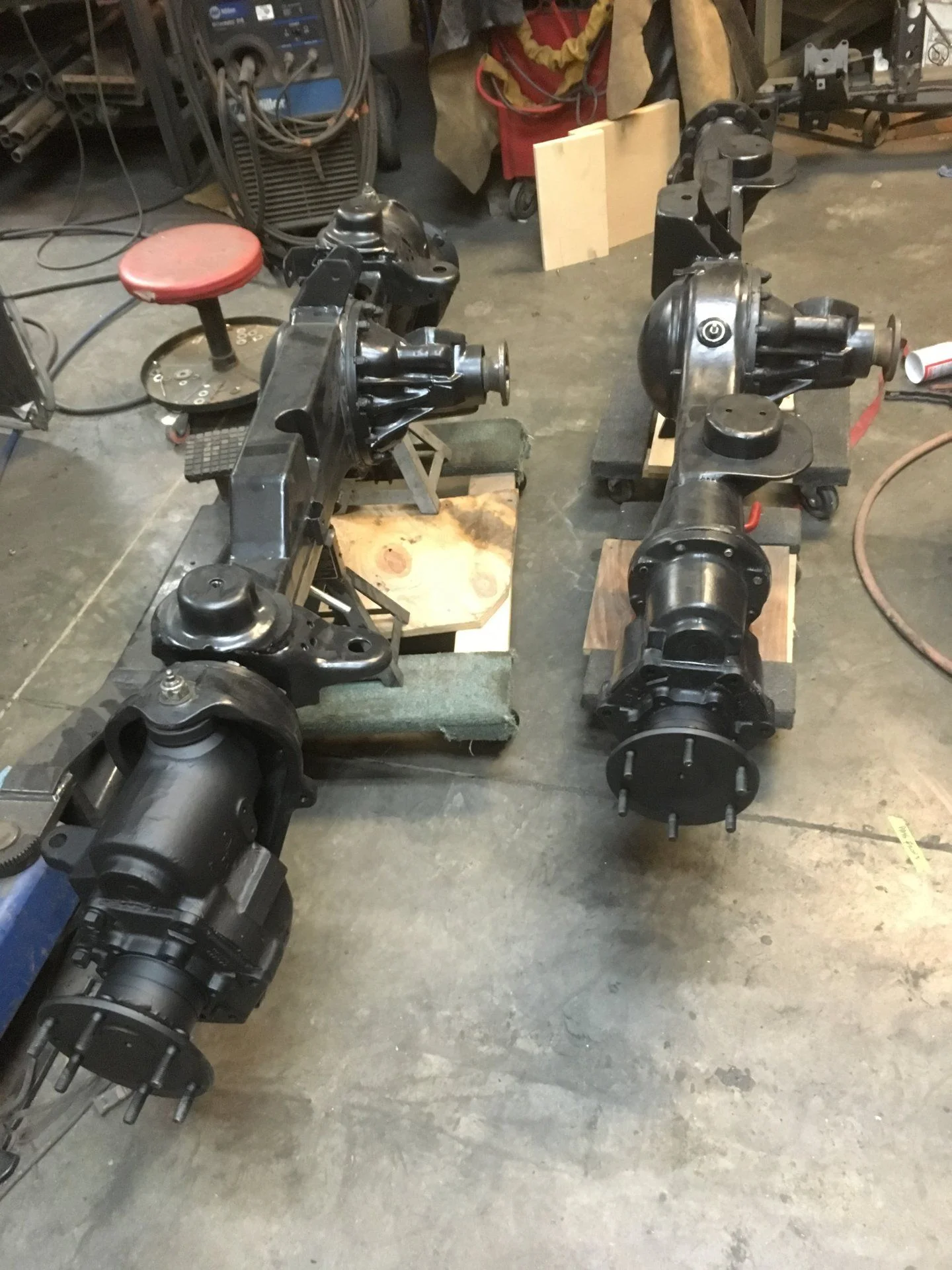

Front axle in.
We got both axles underneath it and have it resting on both axles, so we could measure for shock length. Front measured at 24 inches on level surface, rear measured 25 inches. Both had about 4 inches up travel to bump stop.

@2fpower Did you weigh the new Volvo axles? That may play a role in which shock you choose, coupled with the wheel/tire combo you're planning on running. The "unsprung weight" that your shocks will be seeing will need to know this weight as well as the "sprung weight" for the other portion of the shock.
