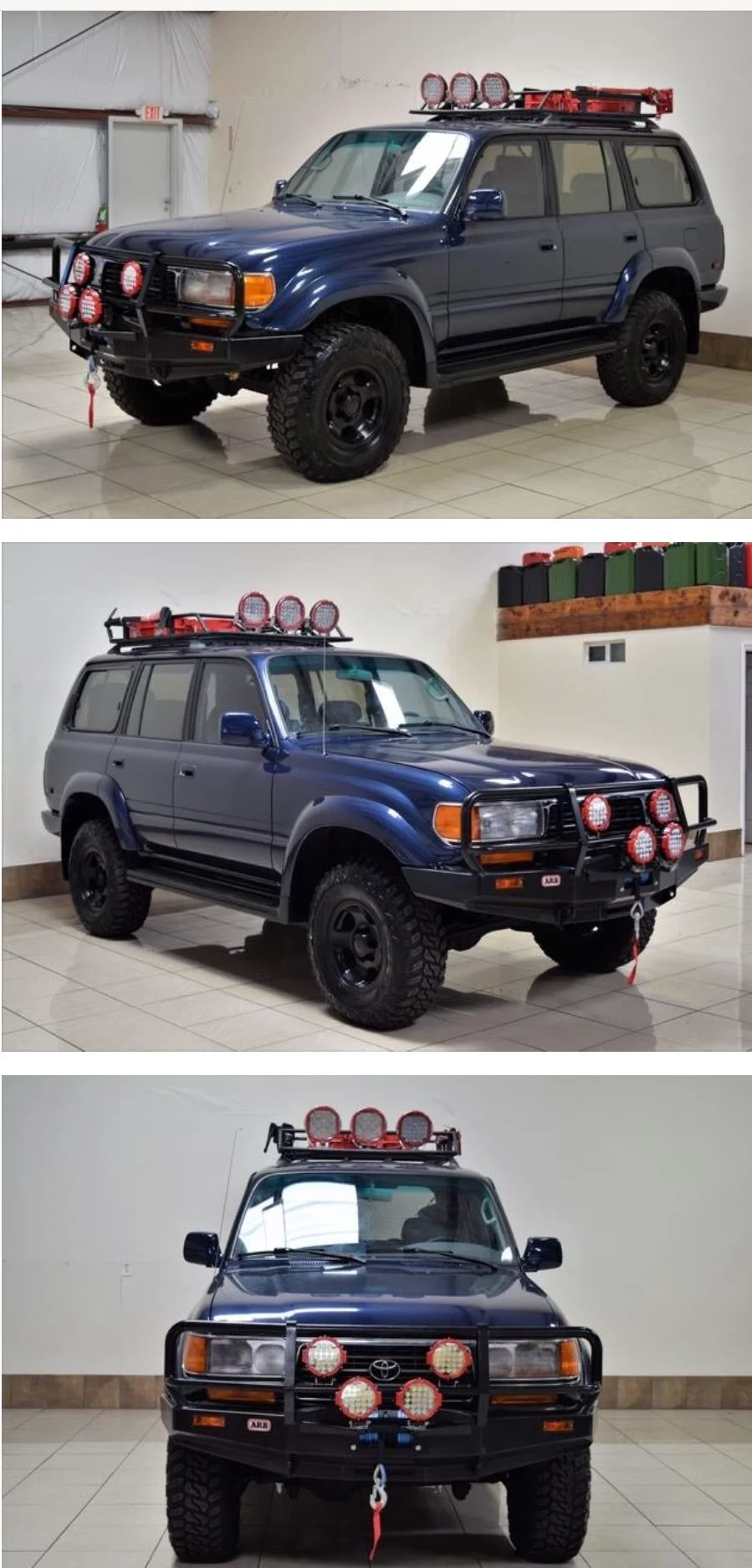

I have always loved the fj80. I finally decided to purchase one last May. I did a lot of research and finally decided on one I found in Texas. I purchased a no rust 1997 in night shadow pearl with factory lockers, an OME lift, ARB bumper, custom roof rack, winch and Led lights with 187k original miles. I knew that I would have some details to clean up on it. I think I paid a little high at 13k for it, but I figured worth it to me for a quality cruiser.
I spent some money on it when I first got it. New steering wheel and shifter done by craftcustoms, replaced several missing trim pieces, ordered new weather tech mats, custom drink and iPhone holder, new kenwood touch screen navigation/stereo system and speakers, new leather seat covers, led interior lights, etc. Additionally I had the harmonic balancer replaced, had all the belts and hoses replaced, the cruise control repaired and an alignment performed.
After all of this, I am up to about 18k on it. Not a huge deal for me if I can have a great cruiser as a daily driver and have fun on the weekends off-roading.
At this point, I have put only about 1500 miles on it. Never had a chance to go off road. I have not even had a chance to install a few small trim items and the stereo because of other work being performed.
About 3 weeks ago, I noticed it starting to run hot. Unfortunately 2 different repair shops verified that it has a blown head gasket. Both shops recommended at minimum a top end rebuild...pricey!!! One of the shops also said that commonly they get in and find even more going on and have to do a full rebuild...even more pricey!
