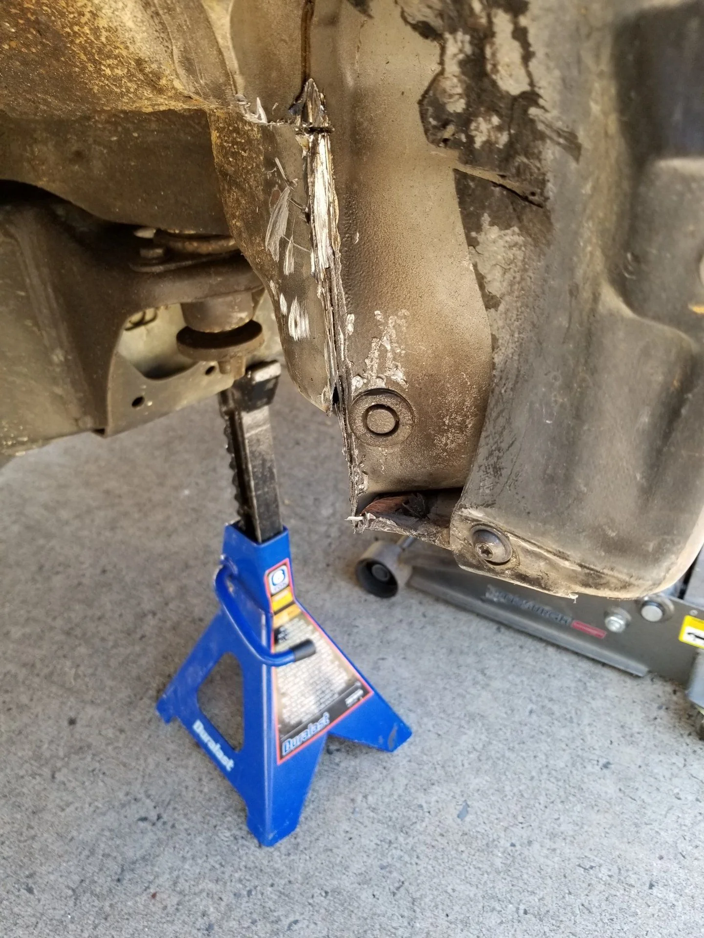

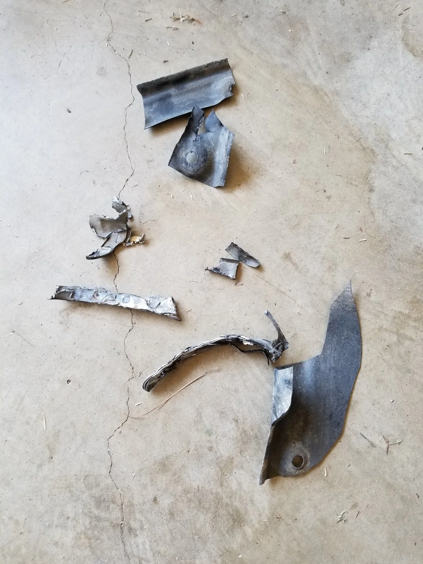

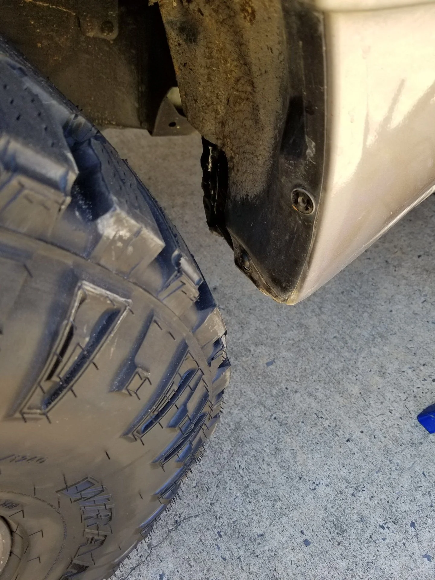

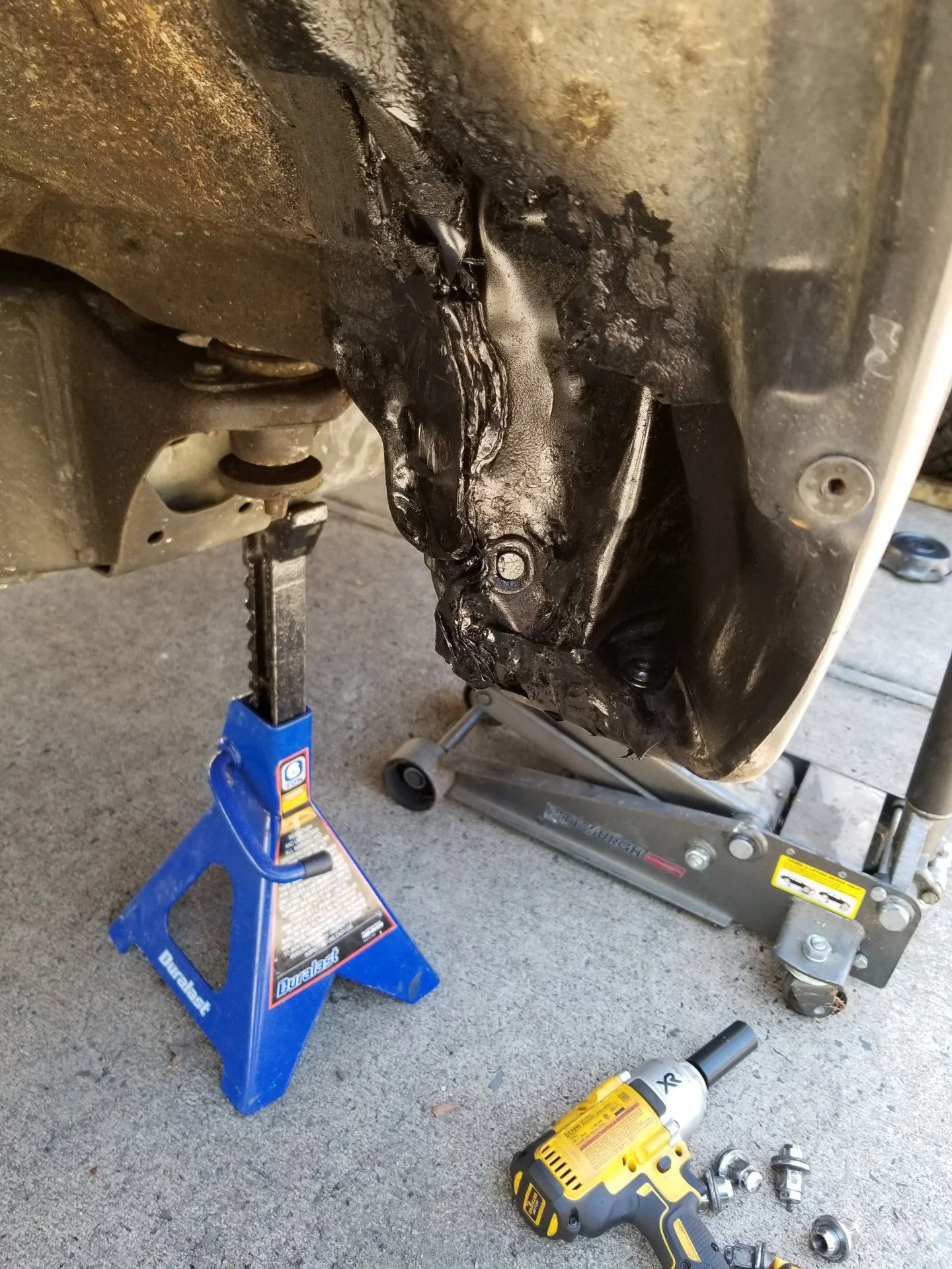

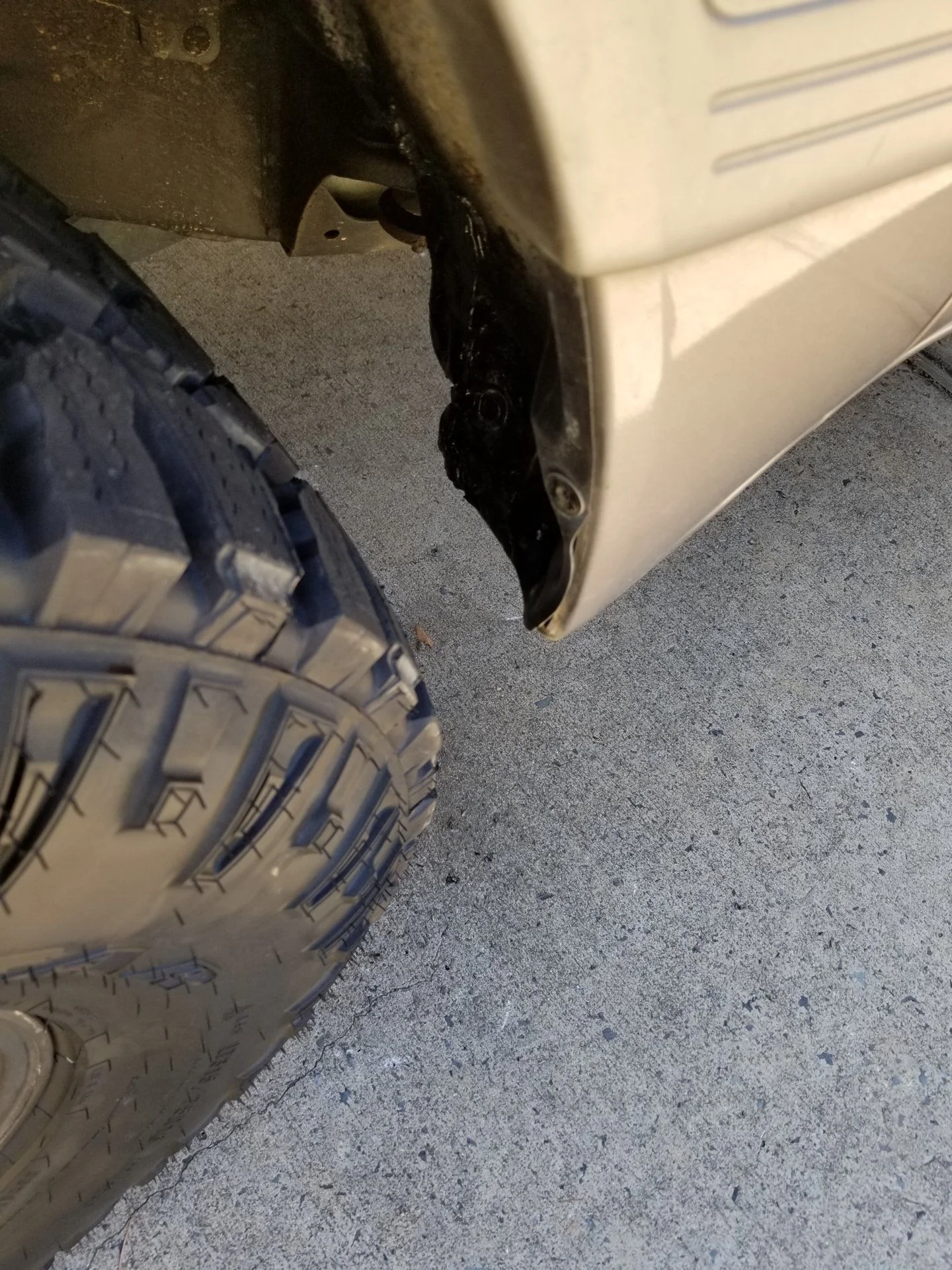

Put some 315s on my 100. They are visually much bigger than the 285s I had on it, but since they were very close in weight I don't feel much of a difference. I ended up having to cut the pinch weld and use the BFH liberally to clearance them. I did that while I was replacing my tie rod ends.

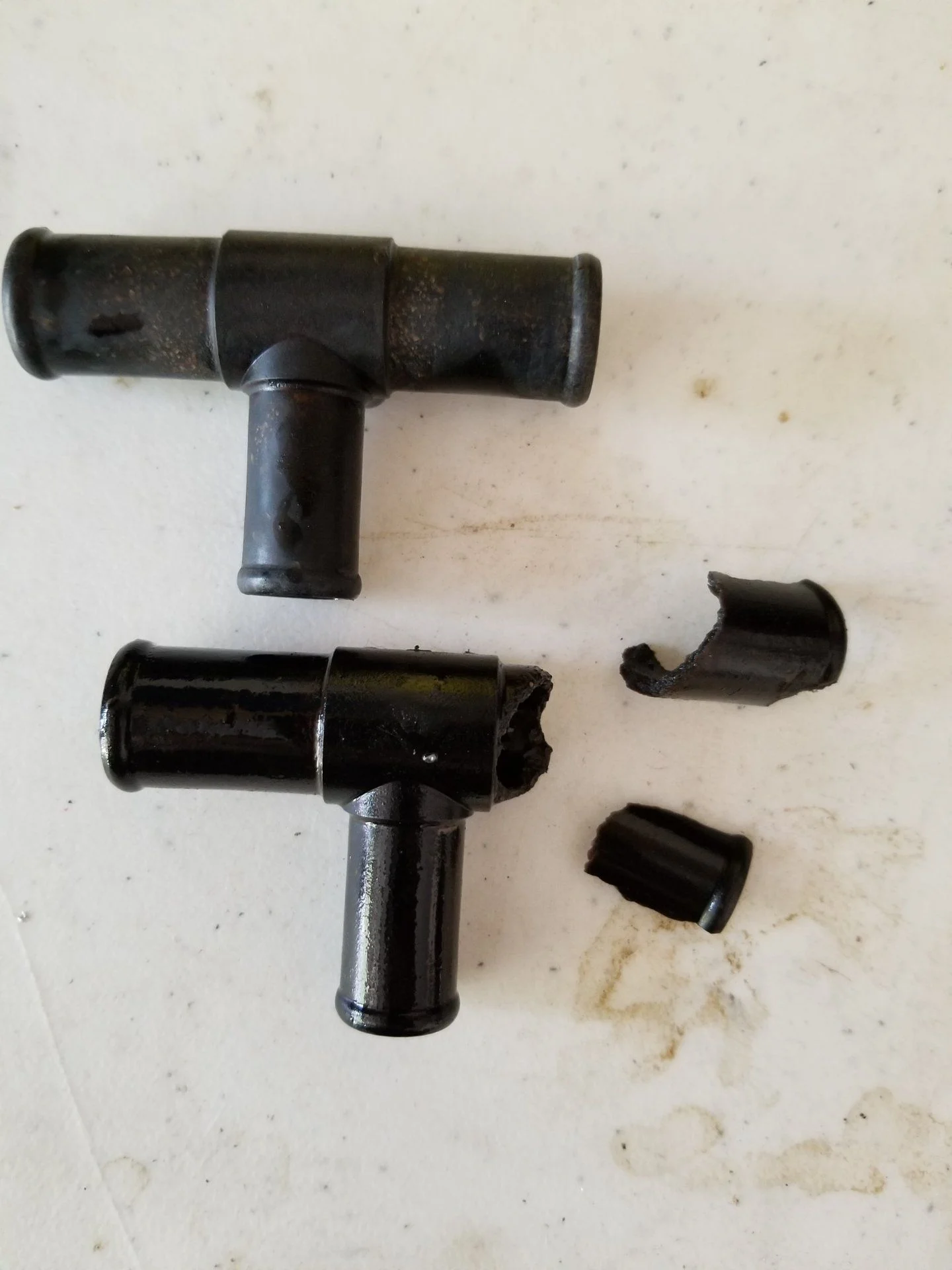

Then I got around to my heater t's. When the hot side t broke I was really glad I did!
