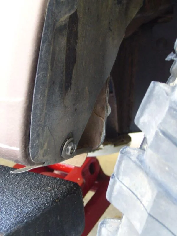

The only spot that I rub with the 315's is the plastic inner fender well. I trimmed the area that was rubbing and no more rub anywhere while daily driving or mild trails. I haven't tried rock crawling since I trimmed so I don't know if it will then.

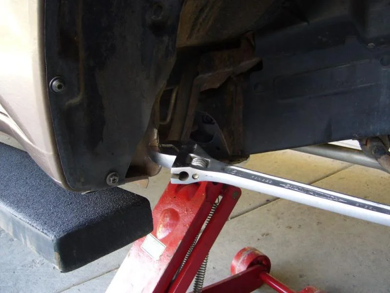

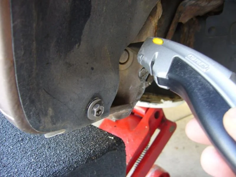

Jack, support and remove the front wheels. With a sharp utility knife cut the bubble portion of the inner fender skirt at the protruding pinch weld. With a large adjustable wrench or pipe wrench fold the pinched body panels over and then beat flat with a BFH.
Spresso, that's exactly what I need to do as well. Thanks for the tip. I'll have to make it work with an MFH, however. :) How far over did you bend/beat them, pics look like they're still sticking forward.

Sorry I don't have a photo of the post bend process...and my LC is covered in dried up mud right now :rolleyes: otherwise I'd go out and snap you one ;).
Once you beat the seam over it provides as much clearance as you're going to get without getting out the sawzall and performing serious surgery on the fender. :D
