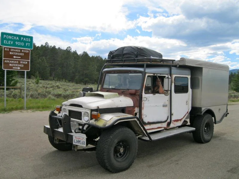

i have done most of build on my rig (Nulla) but painting and body work i will definitely source out. i have been stopping by many body and paint shop in Los Angeles and the estimate i am getting are between 1,800 to 6,000 dollars to paint inside and out. they also talk about many different kinds of paint each one claiming that will be the best paint for my rig. so i figure i should get your opinion.
right now we are thinking of painting it red or blue or mustard yellow or .... not glossy almost flat, but not flat. we are not painting the aluminum box/camper in the back.
so the question is what kind of paint to use for a rig that will see a lot of gravel roads and bushes. :bang:
thank you in advance for your help, we are excited to have come to this point of the build:cheers:
