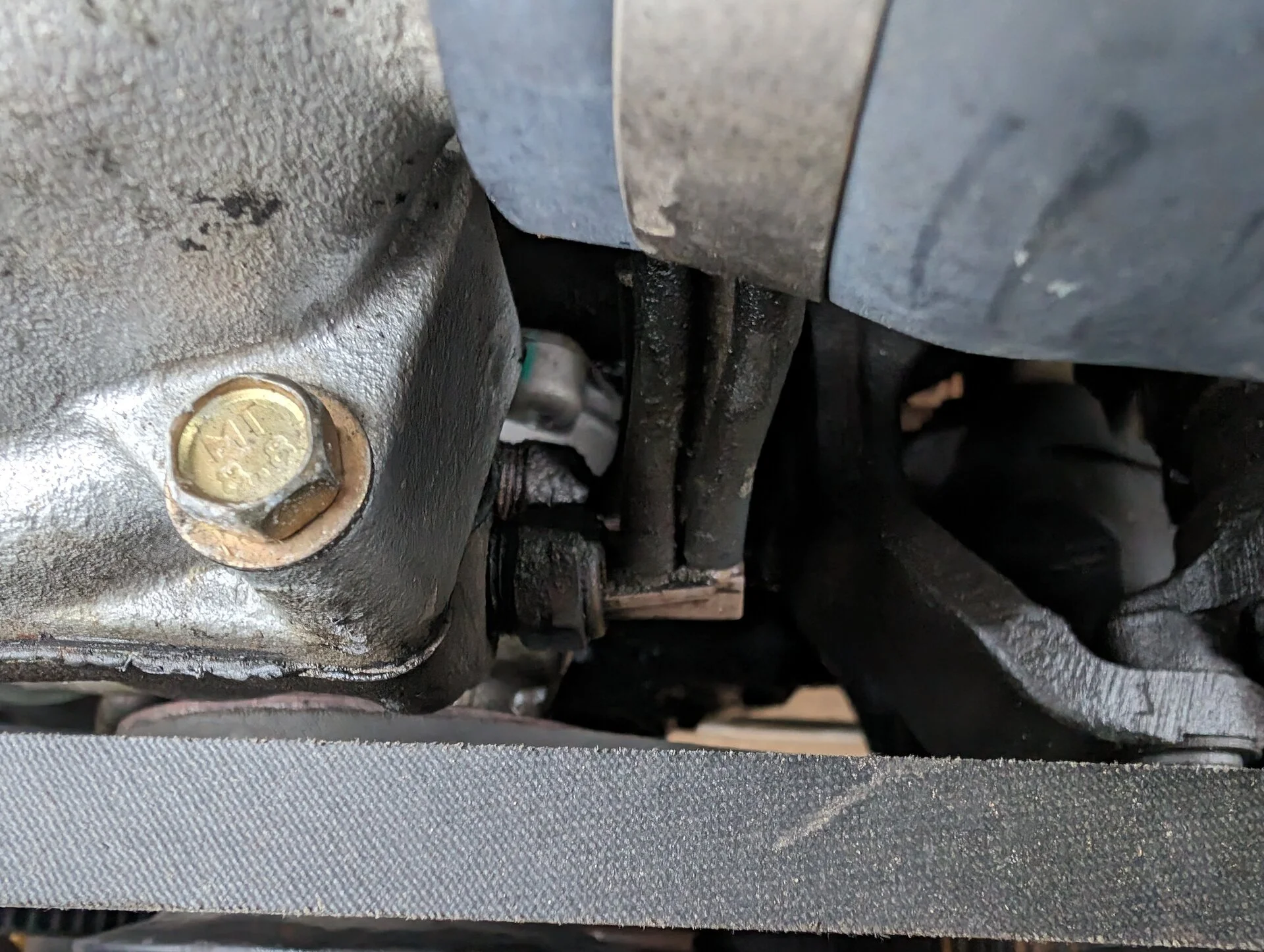

I'm gradually replacing my vac lines, and found another broken vacuum valve.
This one appears to be a temp sensor of some kind, it's under/by the thermostat?
Any help identifying it, and or where to get one is greatly appreciated.
One of the nipples is broken off, and it's covered in greasy gunk and I have my doubts of it surving cleaning enough to repair (though I will try, it worked on my HACV)
Dead center of the Pic, 2 hoses coming out of the top...
Rewplacing the vac lines, and their leaks have noticbly improved the pep of the engine, which is nice.
Thanks for assistance.

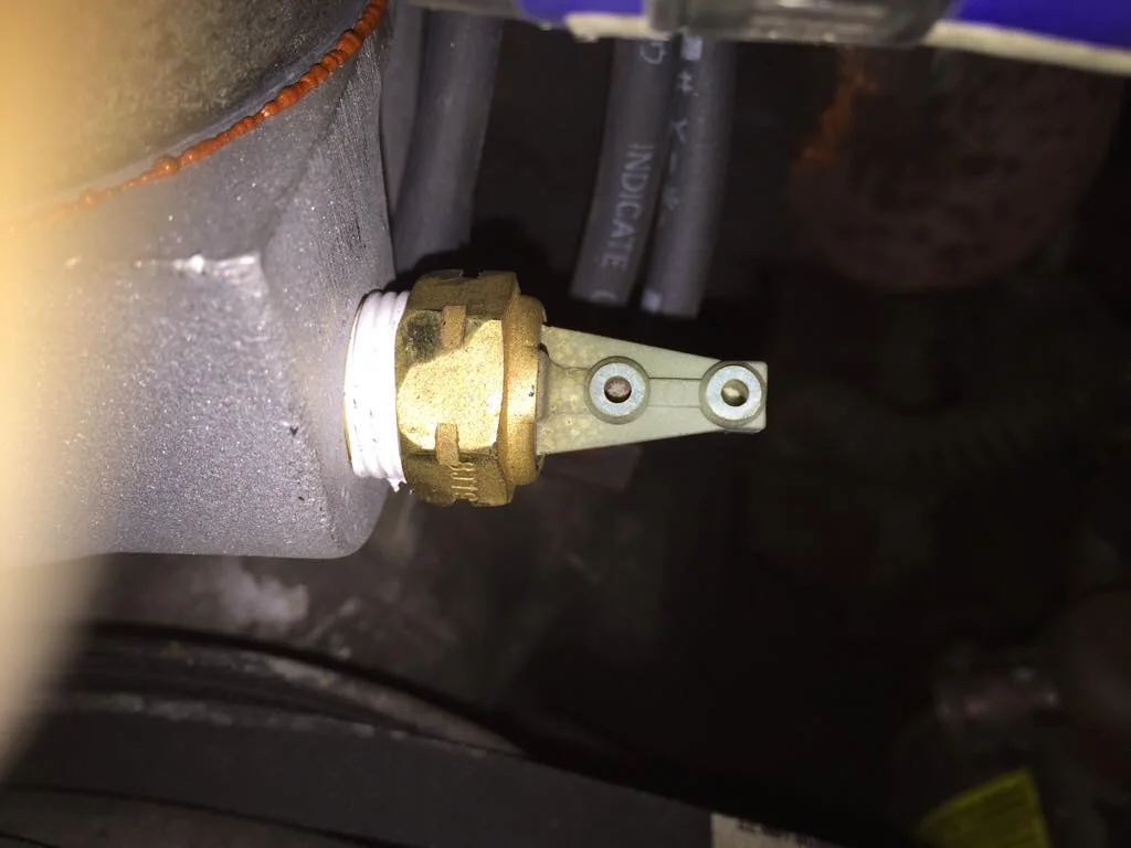

This might help
Looks like the "pink" one. 90925-05046. That number will appear on the side opposite the vacuum ports. That one is discontinued.
If it's the "purple" one that is a 90925-05035. That one appears to still be available.
Yours is discolored so It's hard to tell.
If those switches are in their original locations the upper one should be the purple one.

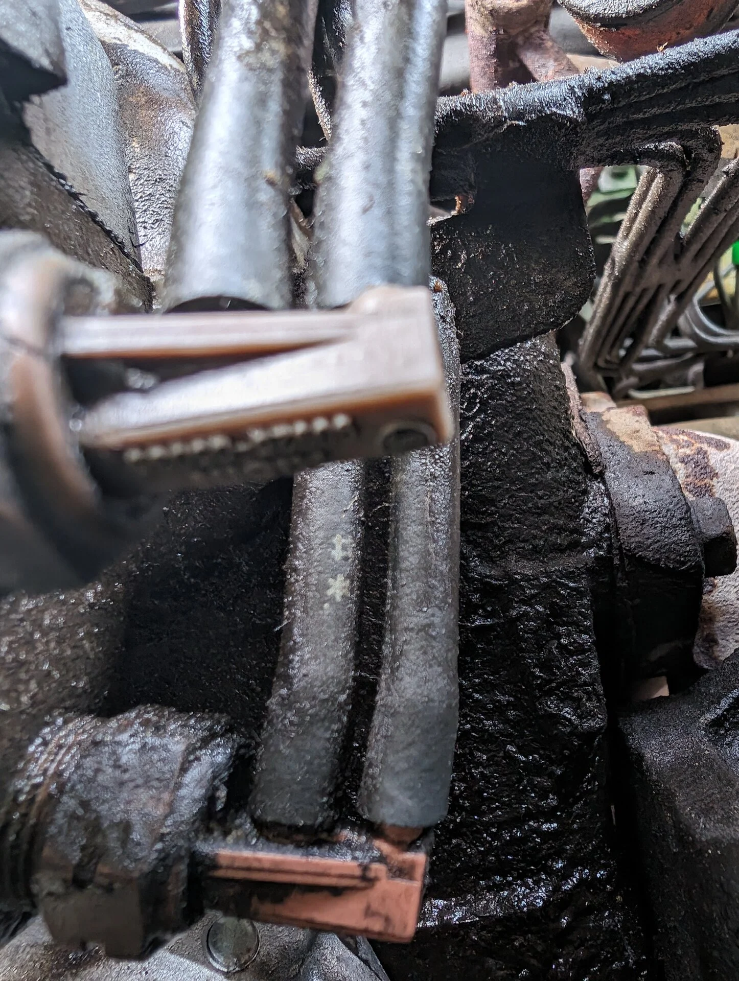

The top one is pale pink, the bottom one an orangish pink... I wonder if a pink got put in place of a purple by the po?
Do they just switch at different temps?
I'll dig out my bore scope and see if I can read the part,
Couldn't - quite get my phone in there and read it...
found this useful info on the thread linked in post #2
"The violet BVSV is used by the EGR system to prevent the EGR valve from functioning until the coolant temp reaches 86º F.
The pink BVSV is used by the choke opener to prevent the choke opener from functioning below 41º F.
Neither are deal breakers. If the engine is allowed to warm up a bit before driving, you'll never miss the violet bvsv. If starting the engine below 41 ºF, the choke will crack open a little sooner than optimum."
Suspect I need a purple.
Thanks everyone!
