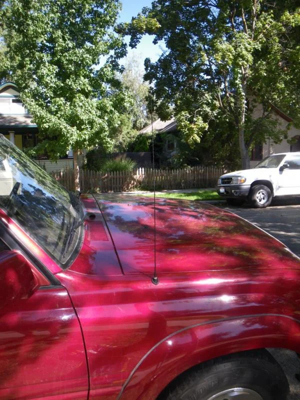

Tacoma Whip Antenna Mod ...
... should really be called the " 4Runner Antenna Mod "
I couldn't find anyone that did this themselves, so I engineered my own so-called "Tacoma Mod" whip antenna.

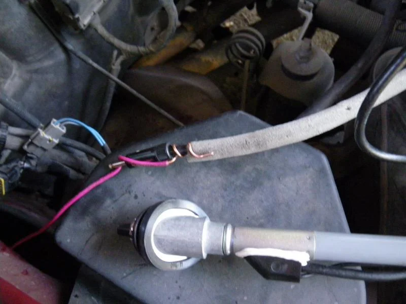

2) Remove the stereo to access the stereo plug end of the stock antenna coax. Attach about 5 feet of pull wire (I think I used 14 ga copper single strand wire) or string to the antenna end of the stock coax with electrical tape. Now use the stock coax to guide (yank) the pull wire or string all the way back to the stereo compartment.
3) Attach the new Tacoma antenna coax wire to the pull wire with electrical tape (I just wrapped the stiff wire around the coax--see picture), and pull the antenna wire through the engine compartment cutout and up to the stereo compartment. Plug coax into stereo and reinstall stereo.

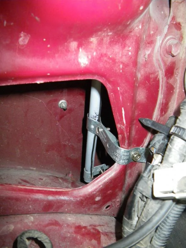

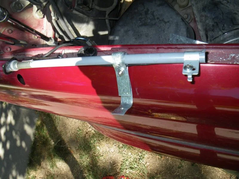

4) Cut and fold some steel strapping around the base of the antenna mount as in the picture. Drill strapping or use holes provided and clamp antenna base with an appropriate bolt, washer and nut. Leave the clamp loose until the antenna is mounted up through the quarter panel.

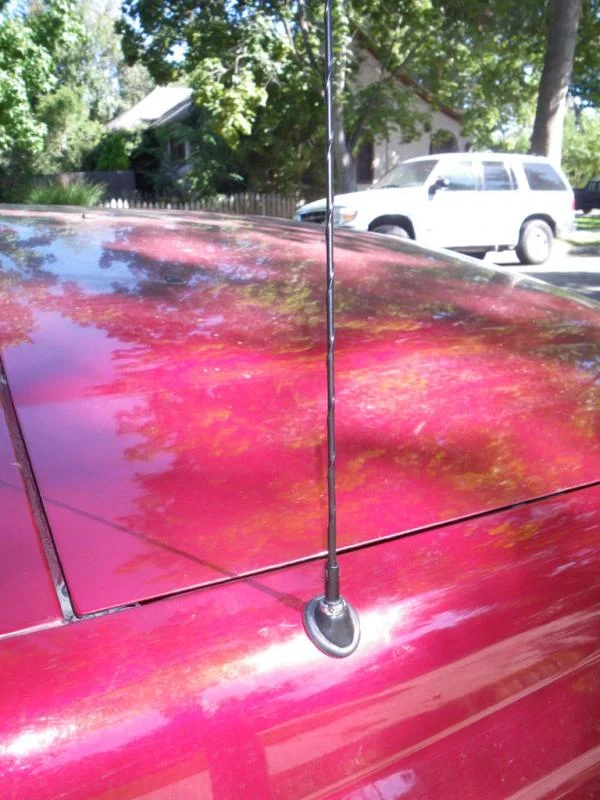

5) Place antenna mount up through top of quarter panel and install top gasket and clamping nut hardware, then screw on the whip antenna.
6) Wrap and bend strapping so that it lays against the engine compartment sheet metal. Tighten nut that clamps the strapping to the antenna base. Drill the strapping and engine compartment sheet metal to accept an appropriate sized sheetmetal screw and secure strapping.

Snug and secure fit. Just a little off in angle inboard. Really needs the base strapped as in the picture, otherwise a bush swipe could move it and buckle the hole where the antenna meets the quarter panel.
Should be no reason why the mod wouldn't work on a RHD as there was nothing handed about the install (antenna base is symmetric back to front.
