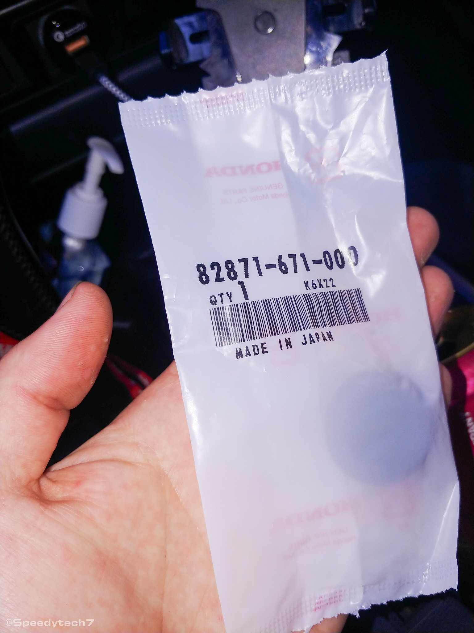

Not sure it's the right size for an LC but I've deleted antennas on other Toyotas and Nissans with an OEM Honda antenna delete grommet...
