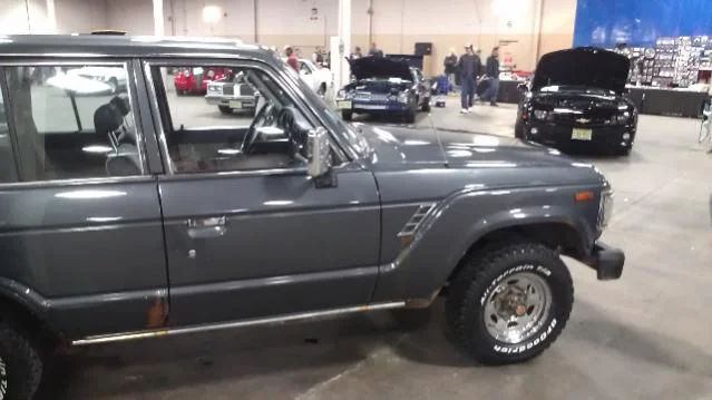

Hi guys I have an 89 fj62 with some Body rust on the fenders. I was wondering what Type of welder do you guys recomend for patching rust. I have several vehicles that could use some tlc and just dont know Were to start. Now I know there are mig welders and tig welders and I just dont know which is the best for what I want to do. I appreciate the advice. Thanks.
