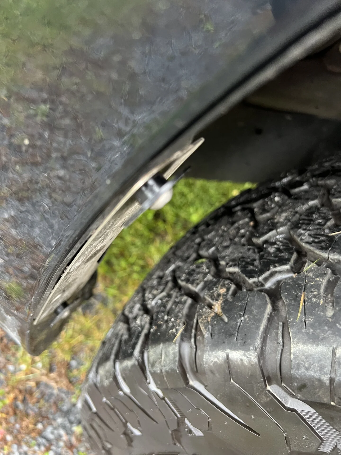

I trimmed all of mine 3/4" below the main part of it. I have only broken one since
mine is trimmed too but I'm on 38" and its obvious that the mud flap no longer covers half the tire

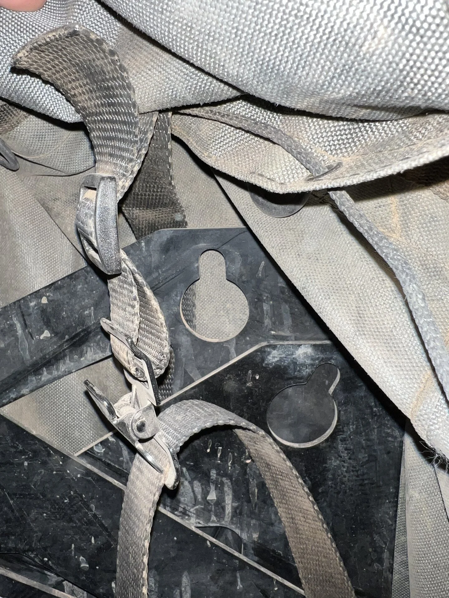

I had/have some from Owl Expedition Outfitters on the 200 series. Not sure if he makes them for the 80.
They worked well on road, and come off quickly for offroading. They do not work well in anything beyond mild offroading, but aren't really meant to. I was kind of torture testing them. I also kind of trashed a couple of the brackets in moab this spring, and melted one mudflap with a rerouted exhaust, so haven't used them since.
The thing that makes them easily removed is a inverted keyhole on the flap, and a spacer and plastic washer on the vehicle side. You slide the mudflap through the circular portion of the keyhole and pull it down to the narrow part where it is secured.
Note that he uses plastic washers on purpose, so they are sacrificial. It is a bit like a fuse where the washer should give out before ripping the mounts off.
You could probably make something similar, without too much difficulty.
